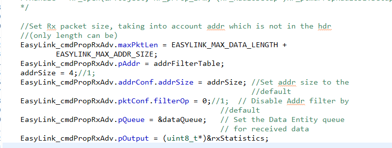

    The host uses this address filter. The length of 4 bytes is changed by the value in addrFilterTable, which allows it to receive data or receive no data.

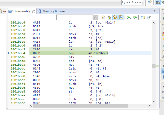

After 110 seconds, the loop is located in the blue arrow position below. It can only be restored by hardware reset, and the watchdog will not work.
Although the host can't receive data, it should not be dead.
