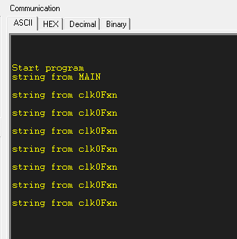

Hello.
I wrote a simple example of outputting a string in UART using MUTEX, but for some reason it does not work correctly. Help to understand what is the reason?
Thank you in advance!
The logic of the program:
Start the Clock period 1 time per second.
In the Callback function, do Semaphore_post (MainSem);  and output a string in UART.
In the main program cycle, we expect MainSem. Once it is free, immediately output the line in UART and change the LED PIN to the opposite value.
The output of a string in UART is organized with the capture of MUTEX.
!!! The problem is that only one line is output from the main program loop. !!! Below are the source codes. Header files are removed.

The output of the program in the terminal looks like this:
