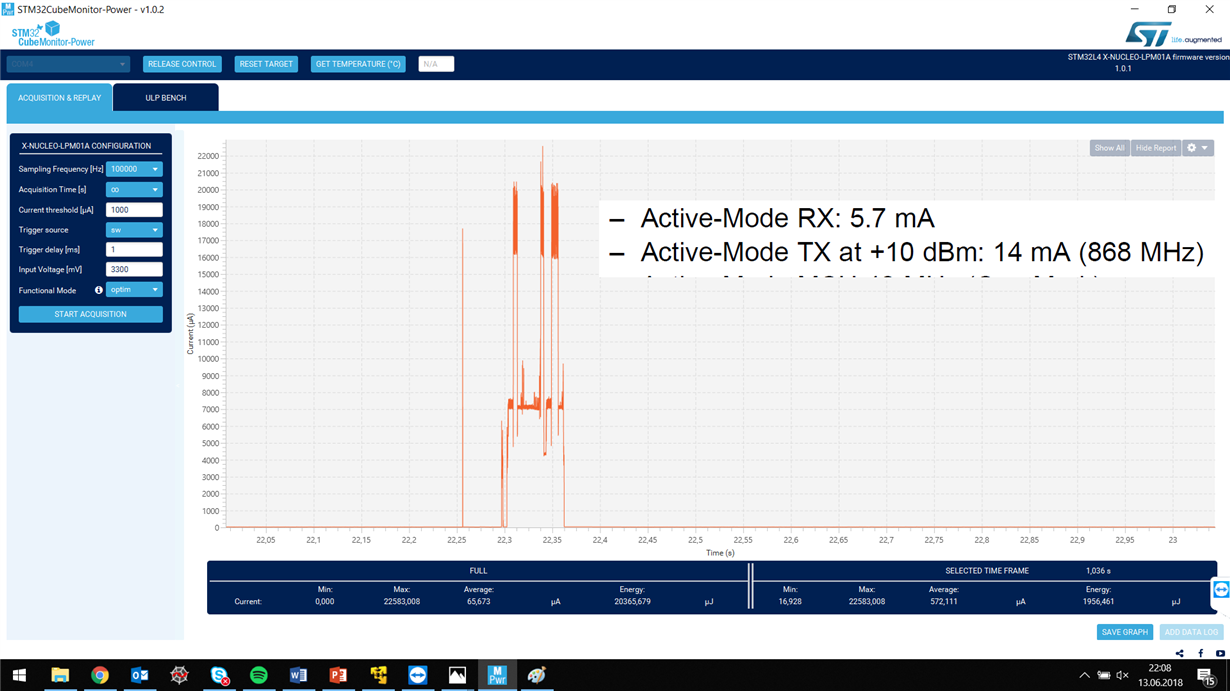

    regarding my 3rd question from the very beginning, I proceeded into more detail. I was looking into the sendSensorMessage function of the sensor project, where cyclic temperature messages are exchanged.
    The payload of this message is 15 bytes (SMSGS_BASIC_SENSOR_LEN + SMSGS_SENSOR_TEMP_LEN), I would expect to have a PHY and MAC Layer overhead of ~15 bytes as well, so something around 30bytes should be transmitted over the air, right?
    On our PHY-ID3 we have 50kbps. 30 bytes*8=240 bits, 240bits/50kps = 0.0048[s]. It should take around 5 ms to transmit this data.
    I measured the current consumption of the device and the current peak there is ~60 ms. Why is this the case?
    Markus

  • Hi Hector,
    my last question about the current consumption is not answered yet. Do you have any explanations, why the current consumption peak has a width of 60ms? Is this the time, the air-interface is occupied, or do we see anything else here?
    Markus
    In the screen shot of the current consumption that you shared there seems to be a little bit more going on than just 1 over the air transmission. From what I can see there seems to be 3 different TX operations, also the active time of the device will always be grater than the amount of time that it will take the device to send a packet over the air since there are many other things that need to happen. For example the device has to wake up, then do a channel assessment, then if the channel is clear the device will transmit data, following that the device will open the receiver to receive an acknowledgement after this the main core will continue to do any other processing that needs to happen depending on the application and finally it will go back into sleep mode.
    Hector
