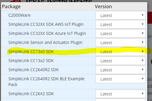

    I'm sorry to hear of your difficulties. If you look at http://dev.ti.com/tirex/#/ and then click the square target icon on the upper right (it's part of the red bar at the top of the page), this will open the package picker.
    Can you please check if the dropdown for the CC13x0 SDK is set to Latest, or is it set to something else?
    Additionally, when you are building and running applications, are you doing this in a desktop version of CCS on your PC? Can you check which SDK version is installed on your PC, and if you are importing projects using the CCS version of resource explorer, check the package picker setting there as well to see if it matches what you were viewing online?
    I noted that the OAD page that you linked says it is for SDK version 1.30.00.06, while the latest version on TI-Rex is 2.10.00.36, here: dev.ti.com/.../index.html This is why I suspect that your resource explorer may be showing an old version or perhaps that there is a version mismatch between the documentation you are looking at vs the SDK that you have installed.
    Basically, make sure that the SDK version you have installed on your PC and are building code with matches the docs version you have TI-Rex set to display. The package picker lets you change this so it can match.

    I am using the latest TIRex, with corresponding locally installed SDK (2.10.00.36) on CCS8. It really doesn't look like a SDK/Doc mismatch on my end, unfortunately.
