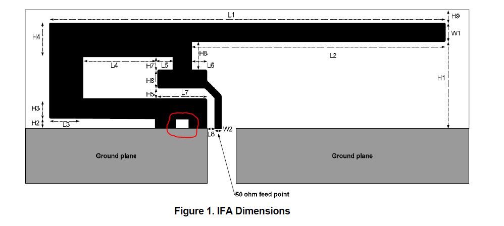

I would like to know if the reference design for CC2430DB wherein it shows the dimensions of 2.4Ghz antenna is affected by the thickness of the top layer copper plane.
Whats Cu thickness was the design made for? and how will the dimension change for a 1 oz and 2 oz copper top layer option?

    1) Could you confirm your answer with the Expert Engineer who was on vacation few weeks ago. It is better to understand and be sure.
    2) Also I have highlighted by circling in red color the aspect of the antenna which has a small rectangle of no copper area, There are no dimensions given for that cutout area and your document DN0007. May I know to understand why it was so and it's significance?

    The CC-Antenna-DK2 is designed with a top layer metal thickness of 35 um (1 oz copper). If the copper thickness is increased then the loss resistance will theoretically decrease. The delta between the 1 oz and 2 oz will be very little in terms of loss resistance since the power is very low.
    The radiation resistance is dominated by the feed point position of the antenna and this will not be effected by the increase in copper thickness.
    The performance of this antenna with 1 oz of copper is very good and I would not use extra copper thickness . The benefits will not be noticed and the PCB will be more expensive.
    For the dimensions shown in the red circle, please refer to the gerbers. This was originally designed to allow for increased bandwidth (and slight tuning) since this effectively increased the distance of H1 to the GND layer.
