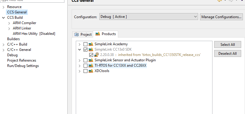

  • When I am debugging I at one point I get this error;
    Can't find a source file at "C:\Jenkins\jobs\FWGroup-DriverLib\workspace\modules\output\cc13xx_cha_2_0_ext\driverlib\bin\ccs/./../../../driverlib/crypto.c"
    Could you help me solve that problem? What drivers do I have to install?
    Also note that it is looking for file at Jenkins user, which isn't mine and doesn't exist on my PC, as I am the only user
  • Could you try to do this with the newest SDK? Jenkins is a build server on our side and you should not have any reference to this when you import the code.
  • I used the latest SDKs on resource explorer homepage and still the same issue.
    Following versions are installed:
    SimpleLink CC13x0 SDK 2.20.00.38
    TI-RTOS for CC2650 2.21.00.06
    do I have to uninstall one of those two? I used empty project template from CC13x0 sdk.
  • You have to check which one the project uses :
    Project properties: general:
    (example from a random project I had open)
  • Here is the screenshot
  • is there then any way to solve this issue?
