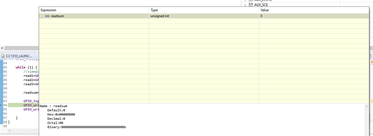

So i built a custom board for the CC1310F32RHB but I do not get my LED pins to toggle.
What I did so far:
  1. I took the example 'empty' project from the CC1310 LaunchPad
  2. I changed the Flash/Ram values in CC1310_LAUNCHXL_TIRTOS.cmd to the appropriate values
  3. I changed the BoardGpioInitTable[] in CC1310_LAUNCHXL.c
  4. I commented out the CC1310_LAUNCHXL_shutDownExtFlash in CC1310_LAUNCHXL_init_General because I have no external flash
  5. I changed the empty.c file to toggle more pins, I left out the 'sleep' so I can better jump to debug points

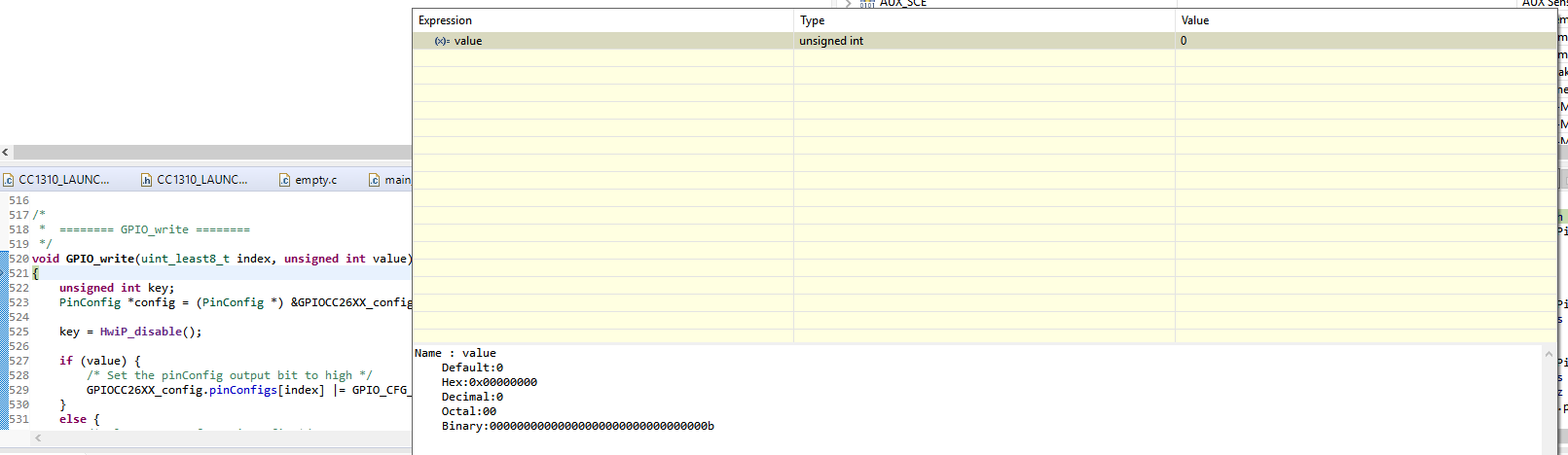

What happens:
6. The LEDs light up (or remain dark) depending on the 'PIN_GPIO_HIGH'/'PIN_GPIO_LOW' in the BoardGpioInitTable[]
7. The code in the 'while(1)' executes properly

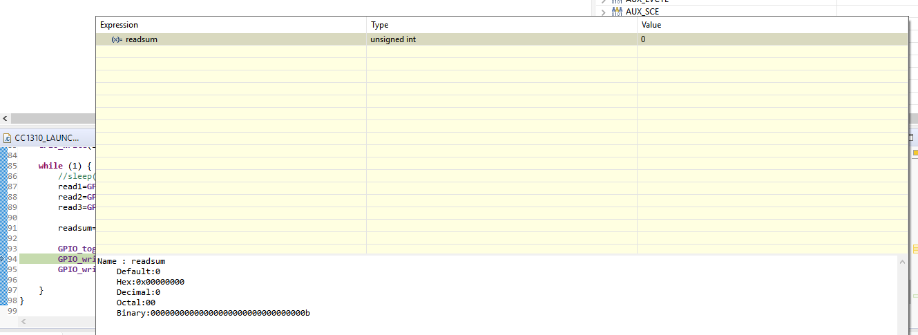

8. GPIO_read somehow only reads 0 although all LEDs are on
9. neither GPIO_toggle nor GPIO_write changes the state of the pins (neither in step_by_step debugging nor with sleep in continous mode

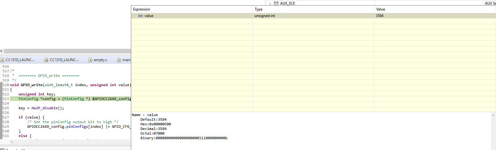

10. some weird stuff happens in 'GPIOCC26XX.c

3. GPIO Table
const PIN_Config BoardGpioInitTable[] = {
    IOID_9 | PIN_GPIO_OUTPUT_EN | PIN_GPIO_HIGH | PIN_PUSHPULL | PIN_DRVSTR_MAX,
    IOID_10 | PIN_GPIO_OUTPUT_EN | PIN_GPIO_HIGH | PIN_PUSHPULL | PIN_DRVSTR_MAX,
    IOID_11 | PIN_GPIO_OUTPUT_EN | PIN_GPIO_HIGH | PIN_PUSHPULL | PIN_DRVSTR_MAX,
    PIN_TERMINATE
4. Commenting out external flash

5. empty.c file
 * Copyright (c) 2015-2017, Texas Instruments Incorporated
 * All rights reserved.
 * Redistribution and use in source and binary forms, with or without
 * modification, are permitted provided that the following conditions
 * are met:
 * *  Redistributions of source code must retain the above copyright
 *    notice, this list of conditions and the following disclaimer.
 * *  Redistributions in binary form must reproduce the above copyright
 *    notice, this list of conditions and the following disclaimer in the
 *    documentation and/or other materials provided with the distribution.
 * *  Neither the name of Texas Instruments Incorporated nor the names of
 *    its contributors may be used to endorse or promote products derived
 *    from this software without specific prior written permission.
 * THIS SOFTWARE IS PROVIDED BY THE COPYRIGHT HOLDERS AND CONTRIBUTORS "AS IS"
 * AND ANY EXPRESS OR IMPLIED WARRANTIES, INCLUDING, BUT NOT LIMITED TO,
 * THE IMPLIED WARRANTIES OF MERCHANTABILITY AND FITNESS FOR A PARTICULAR
 * PURPOSE ARE DISCLAIMED. IN NO EVENT SHALL THE COPYRIGHT OWNER OR
 * CONTRIBUTORS BE LIABLE FOR ANY DIRECT, INDIRECT, INCIDENTAL, SPECIAL,
 * EXEMPLARY, OR CONSEQUENTIAL DAMAGES (INCLUDING, BUT NOT LIMITED TO,
 * PROCUREMENT OF SUBSTITUTE GOODS OR SERVICES; LOSS OF USE, DATA, OR PROFITS;
 * OR BUSINESS INTERRUPTION) HOWEVER CAUSED AND ON ANY THEORY OF LIABILITY,
 * WHETHER IN CONTRACT, STRICT LIABILITY, OR TORT (INCLUDING NEGLIGENCE OR
 * OTHERWISE) ARISING IN ANY WAY OUT OF THE USE OF THIS SOFTWARE,
 * EVEN IF ADVISED OF THE POSSIBILITY OF SUCH DAMAGE.
 *  ======== empty.c ========
/* For usleep() */
#include <unistd.h>
#include <stdint.h>
#include <stddef.h>
/* Driver Header files */
#include <ti/drivers/GPIO.h>
// #include <ti/drivers/I2C.h>
// #include <ti/drivers/SDSPI.h>
// #include <ti/drivers/SPI.h>
// #include <ti/drivers/UART.h>
// #include <ti/drivers/Watchdog.h>
/* Board Header file */
#include "Board.h"
 *  ======== mainThread ========
void *mainThread(void *arg0)
    /* 1 second delay */
    uint32_t time = 1;
    uint32_t read1=0;
    uint32_t read2=0;
    uint32_t read3=0;
    uint32_t readsum=0;
    /* Call driver init functions */
    GPIO_init();
    // I2C_init();
    // SDSPI_init();
    // SPI_init();
    // UART_init();
    // Watchdog_init();
    /* Configure the LED pin */
    GPIO_setConfig(IOID_9, GPIO_CFG_OUT_STD | GPIO_CFG_OUT_LOW);
    GPIO_setConfig(IOID_10, GPIO_CFG_OUT_STD | GPIO_CFG_OUT_LOW);
    GPIO_setConfig(IOID_11, GPIO_CFG_OUT_STD | GPIO_CFG_OUT_LOW);
    /* Turn on user LED */
    GPIO_write(IOID_9, Board_GPIO_LED_ON);
    GPIO_write(IOID_10, Board_GPIO_LED_ON);
    GPIO_write(IOID_11, Board_GPIO_LED_ON);
    while (1) {
        //sleep(time);
        read1=GPIO_read(IOID_9);
        read2=GPIO_read(IOID_10);
        read3=GPIO_read(IOID_11);
        readsum=read1+read2+read3;
        GPIO_toggle(IOID_9);
        GPIO_write(IOID_10,!read2);
        GPIO_write(IOID_11,0);
8. GPIO_read reads 0
10. weird stuff with 'value' in GPIO write
at line 521 when GPIO_write starts
after the PinConfig line:
