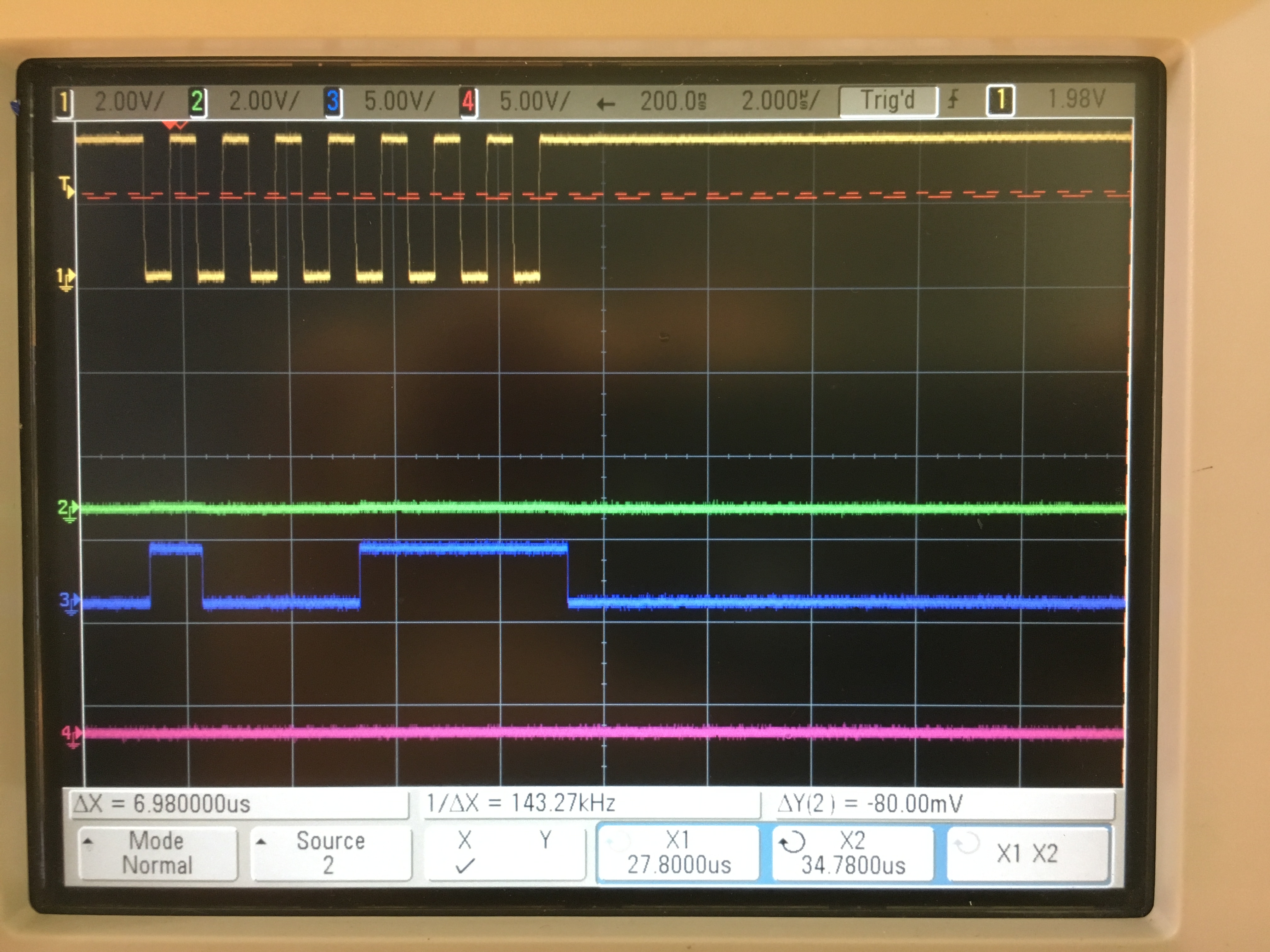

  I am trying to connect an ST Micro accelerometer (LSM6DSM) to the 1310.  The problem I am seeing is that the command gets clocked
out by the master (1310) but I never see the clocks provided to the slave for it to clock it's response back. Here is a shot of the scope
trace showing the command 0x8F being sent to the accelerometer but no clocks to return the response which should happen immediately
after the command is sent.  You can see the 8 clocks for the command itself.  There should be 8 more clocks allowing the accelerometer
to respond on the MISO (pink trace).  The chip select (green trace) for the accelerometer is tied low.  The blue trace is data and the yellow
is the clock coming from the 1310.

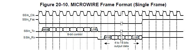

  • One additional note....
    I believe that I may have the mode set incorrectly.  I think what I really want is SPI_MW which is the National Microwire format.  In the 1310 reference
    manual this most closely matches the bus behavior the accelerometer is expecting.
    From the 1310 reference manual:
    I've tried this and it's still not working correctly but I believe it is closer.
    Victor

    Unfortunately it's still returning 0 for the device id.  I tried all combinations of spi mode 0, 3 and 5 and datasizes of 8 and 16 bits
    and transfer sizes of 1 and 2 bytes.  Unfortunately I don't have access to a scope at this time so it's hard to see exactly
    what is happening.
    I am going to go through the wiring carefully today to see if something is wrong.
    Victor
  • Hi Victor,
    Now the code snippet looks ok to me at least. Let me know if you find something out with the hardware/wiring itself.
    If you could get you hand on a scope that would be great, it is really hard to tell what might be wrong without seeing the line activity.
