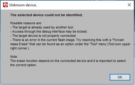

After some work with the custom device on the chip CC1310F128, my chip is locked and I can not unlock it.
I program it via CC1310 LaunchPad - XDS110
This happened after some experiments with the example nvsinternal_CC1310_LAUNCHXL_tirtos_ccs
Reading and Writing occurred from the address 0x1F000. After a while, the chip stopped programming.

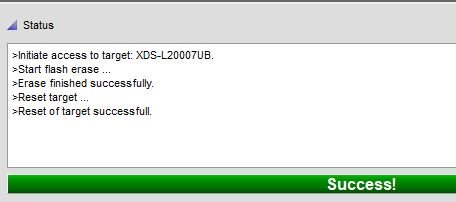

I tried to do a mass erase in the SmartRF Flash Programmer. But the chip is still not programmable.
What can I try again?

[15.08.2018, 19:13:40] [ERROR] IcePick_C: Error connecting to the target: (Error -241 @ 0x0) A router subpath could not be accessed. A security error has probably occurred. Make sure your device is unlocked. (Emulation package 8.0.27.9)

    Using flashprogrammer2, on any operations produces Error.
    >Initiate access to target: XDS-L2000JQO.
    >Failed to read target memory.
    >Error while reading memory range. Address 0x40091090.
    >Debug interface is locked. Aborting action. Only forced mass erase is possible.

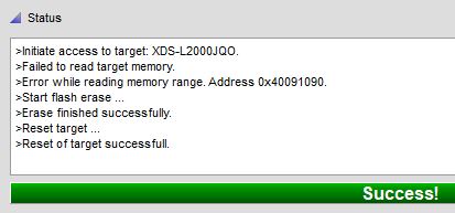

    But the operation mass erase passes correctly without errors.
    >Start flash erase ...
    >Erase finished successfully.
    >Reset target ...
    >Reset of target successfull.
  • Do I understand correctly that after erasing and writing my data to the last page of flash memory 0x1F000, could I delete the configuration data and lock the jtag interface?
  • Yes. If you set specific bits in the CCFG (which is located at the last page) you can lock yourself out. See chapter 9 in www.ti.com/.../swcu117h.pdf
