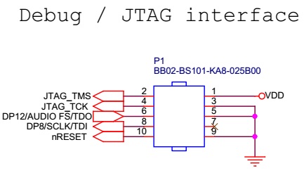

    What happens if you assert the reset pin when its consuming the 10mA? Short pins 9&10 on the jtag connector (the 2 pins nearest the battery holder). I get about 47uA if I power up the board in reset and about 37uA when its reset while the pin-standby program is running.

    On the sensortag, I'm still getting 9-11mA (depending on the LED state) on the pinstandby with the code posted by Siri and copying the sensors folder from the previous sdk. Since I found the issue on my custom board, this sensortag is no longer a priority. I'll just assume there is some flaw in this specific board since I appear to be in the minority. I haven't stepped through the sensor code to ensure its not failing somewhere.
    Incidentally, when I tried shorting the pins next to the battery holder, the power draw shot way up (~40mA).

    It would appear there's an issue with your sensor tag since shorting the 2 pins (9&10) should only reset the processor by holding reset low

    I ran Siri's program first then pulled the reset line low which is where the 86uA to 35uA figure came from. To me this suggests the quiescent current of the board is somewhere around 35uA, when the sensors are in low power mode, because the CC1350 current is negligible in reset. (Unless pulling the reset pin somehow causes a sensor to draw more current). I have some work to do as even assuming the board takes 35uA, when my program is in standby it takes 51uA. I was just asking the question so I have a know minimum power consumption to target for the CC1350 sensortag board. I am a complete noob to TI processors and I have read through various threads and have seen various values of current consumption mentioned.so a baseline current consumption for the CC1350 sensor tag measured at the battery terminals when in the lowest power mode would be helpful.

    I am making the assumption that between the transmission peaks (which I can observe without the led) that the device is in sleep mode.
    I toggled the reset after the device has made a transmission when it should be asleep. I'll check the default IO pin settings perhaps there is something to be gained here to make up the difference between 86uA and the 38uA in reset. If you power up the board in with the reset held low i.e with no power down sequence being sent to the sensors you get close to 1mA so the sensor power down code from Siri does reduce current consumption significantly significantly.
