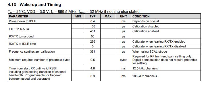

what is the switching time from rx to tx and tx to rx..
I measure this one to 2 to 3 ms.
why it take such a long time.
  • Sudhir,
    The switching times are given in the datasheet. If you are not able to get there, then I think the most like issue is software optimization that is needed to ensure that commands are issued fast enough.
    TX/RX turn-around should be 50us.
