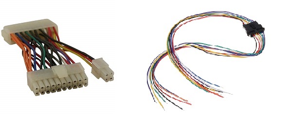

  • 1. Means TrxEB have all the expansion boards and Modules in its Kit whatever available in the CC1101DK433 kit. Right?
    2. I have attached an image file. Please check it Whether the kit have such cables to interface with TI kit and Third party kit?
    Uvaise
  • Please refer to the user guides for the I/O connectors. There are pictures of the boards and you find the information you need in there.
    SmartRF04EB: www.ti.com/.../swru040c.pdf (figure 5)
    TrxEB: www.ti.com/.../swru294a.pdf
  • I couldn't find anything like that. That's why I asked to you. Though this is your product, Why are you answering like this? Please answer directly about the availability of cable. :-/
  • The user guides I referred to shows the different I/O connectors and which signals are available. There are no cables with the kit except for a USB cable.
