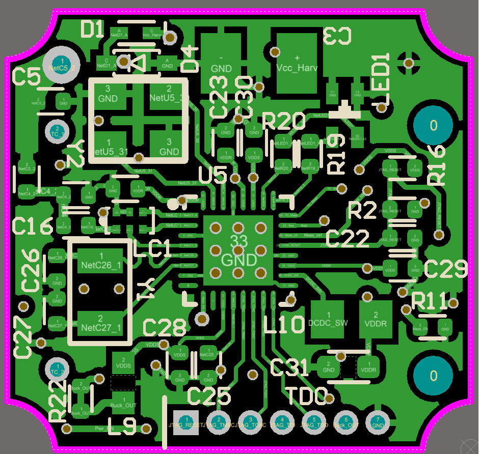

The problem is with my miniature board...  It was designed from the same schematic as my prototype board, but in a much smaller 4 layers PCB.
I'm using the same  part number for all critical components (the same from the reference LP design). But consumption is about 600uA.
I'm totally lost here.
The firmware is exactly the same. Schematic has only small differences on DIO, but I unmounted any components connected to CC1310, making both boards virtually the same.
Layout is obvious different but, theoretically, it was better designed in the miniature version.
I've already tried to swap the CC1310 from both boards, but nothing happened.
I've just found a big difference on the signal of DCDC_SW pin.
- On the LP, I measured a sawtooth-like signal of really low frequency, of about ~1Hz. I'm assuming this is the ideal case.
- On my prototype board, I've got also a sawtooth-like signal, but with frequency of about 50Hz.
- On my miniature board, switching is happening so fast that I cannot see the sawtooth, but voltage after the inductor looks beautifully plain, at 1,67V.

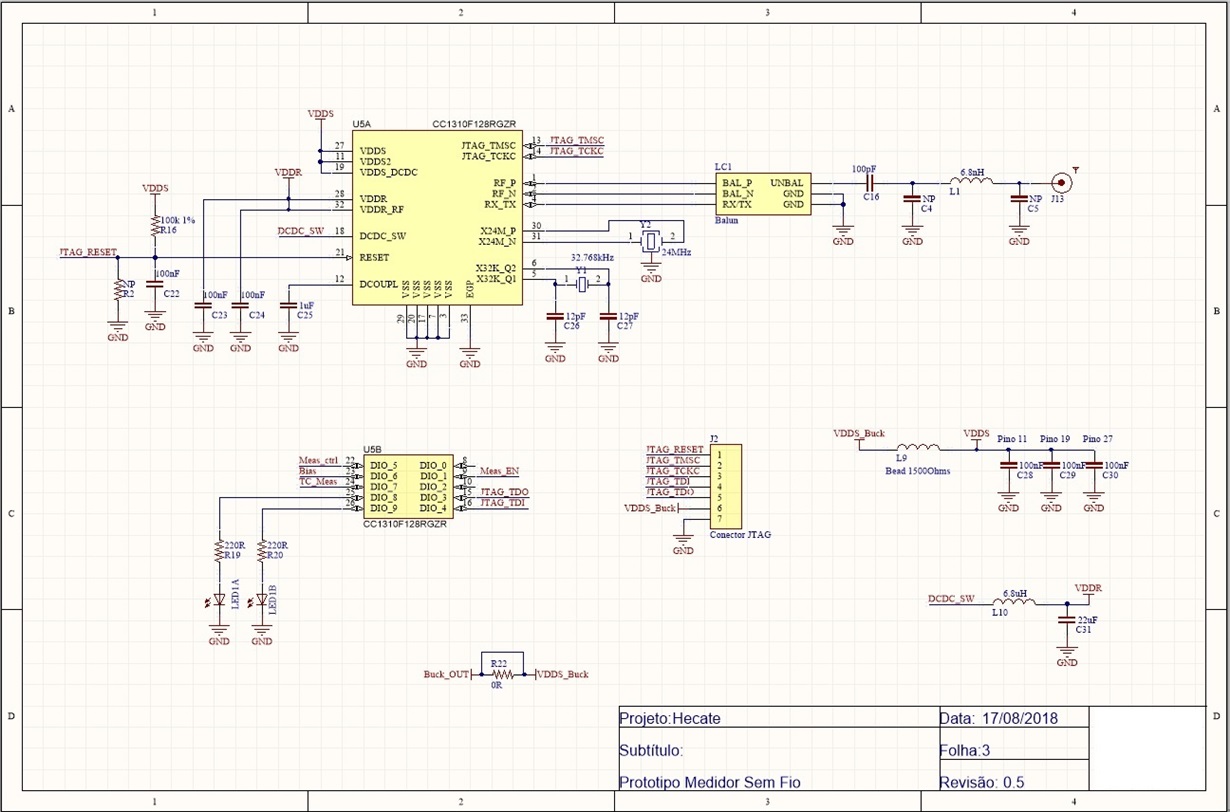

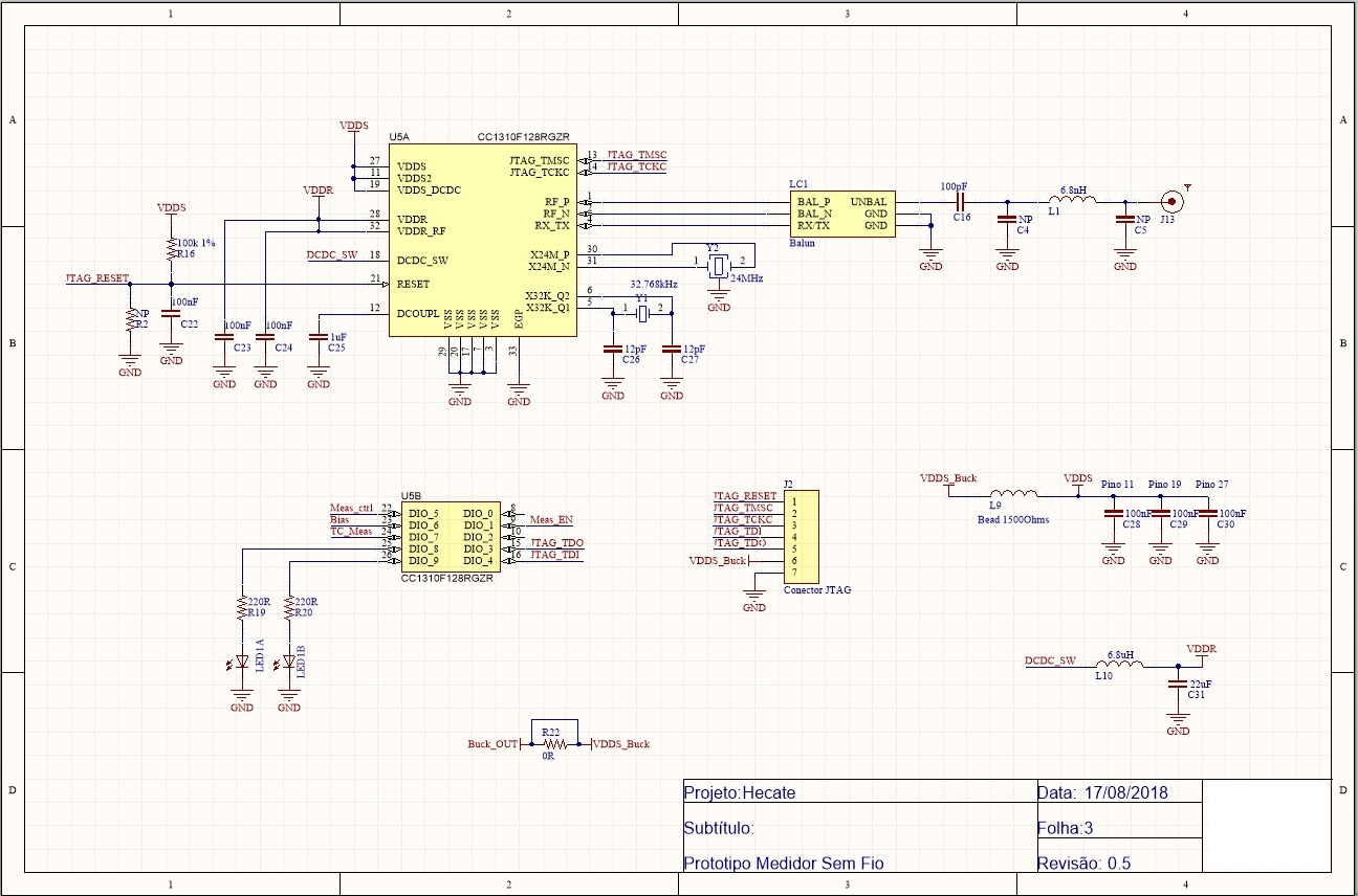

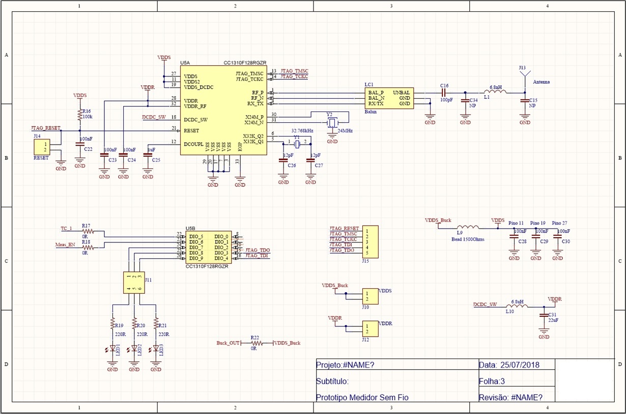

  • Dear TA12012,
    Follows the schematic of both boards.
    The miniature version, that has the high current problem, is the one with just 2 LEDs connected to GPIO PINs.
    Apart from the LEDs and TDO/TDI pins, I have unmounted any connection to GPIOs on both boards. So DIOs 5,6,7 and 9 are floating.
    Balun is also unmounted on the miniature versions.
    L9, L10, Y1 and Y2 are the same part numbers as reference design from TI.
    CC1310 part number is actually notated wrong in this schematic as I'm using RSM (4x4) version.
    I'm just cleaned the board with proper PCB cleaner product to remove any flux residue. But the consumption remains the same....
    I'll try now changing all decoupling capacitors.
    Any news, I'll post here.
    BR,
  • Your schematics look good, but your comment about removing the nodes reminded me of an other item to check for.
    Its very important that you initialize all your IO to something that makes sense, the trick is that even if a node is left floating and the CC device is configured as an input for that pin, then the pin could float to somewhere between 0 and 1 that is not defined and the CC will start to draw tens of microamps in that port.
    /TA

  • Does the schematic show the full circuit since I see some DIOs have a name that looks like is nowhere else on the schematic.
  • Hello TER,
    As I said to TA12012, I disassembled any GPIO connection for this tests, except from the LEDs and TDO/TDI pins.
  • Sorry, overlooked that for a second. But the current consumption indicate that you have something that is undefined. Since you have removed components, have you remembered to redefine these DIOs?

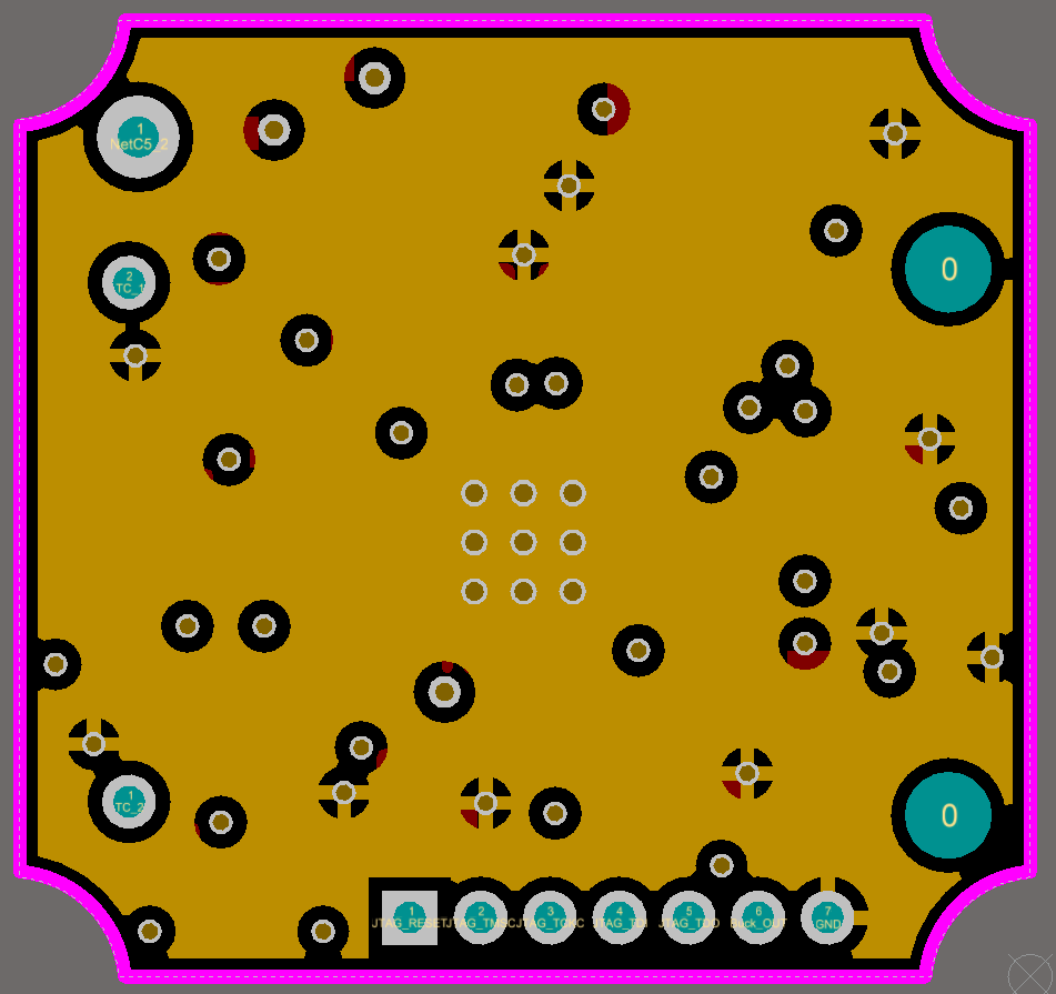

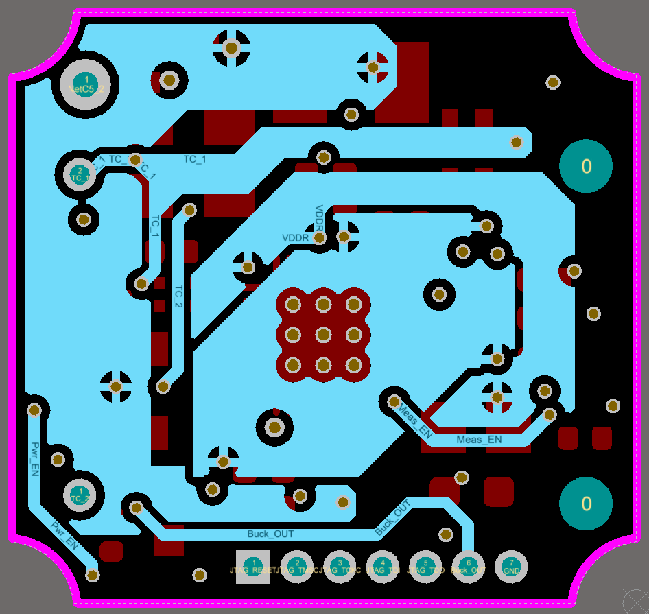

    Anyone here would mind checking my layout?
    It is a 4-layer PCB, but I'm posting only the ones directly related to the CC1310.

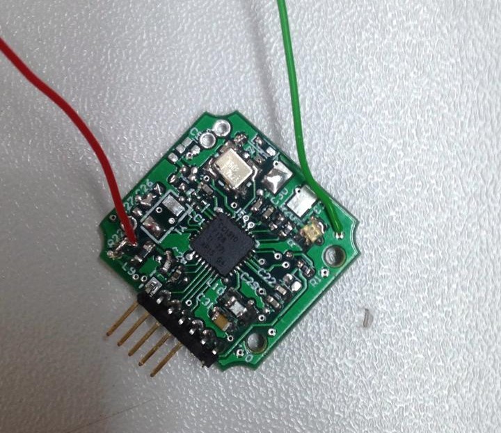

  • Can you post a picture of the device that you are testing on.
    The layout does not follow our recommendations, it would take a pretty close review of Gerber files to make any conclusions.
    Can you post the Gerber files in a zip?
    /TA
  • Hello TA12012.
    Here is the device:
    Would you mind if I send you the gerber privately?
    BR
