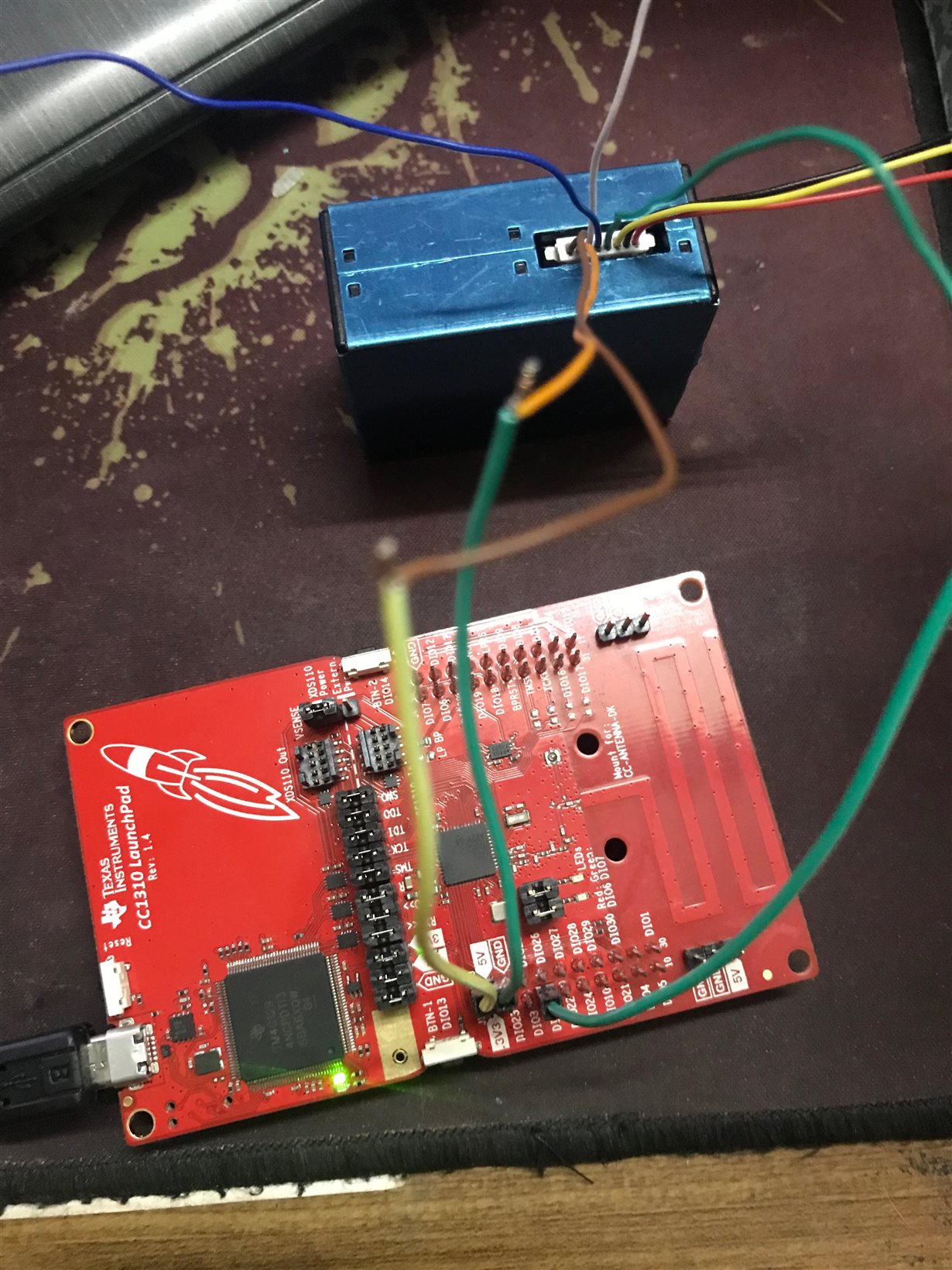

I tend to use the Plantower PM2.5 PMS5003 dust sensor. This sensor outputs value through UART pins. I attached it to TXD and RXD of the CC1310 Launchpad but I still do not know how to use these pins.
Does anyone know how to use these pins or have any documents about URAT pins of the launchpad?
  • Could you post a picture of how you connect this? (clearly showing where everything is connected)
  • Hi TER, thanks for replying.
    I would like to describe it clearer:
    I connected VCC and GND to 5V pin and GND of the launchpad, the TX pin of the sensor to DIO2(RXD) pin of the launchpad
    And I want to read only values from this pin and print it out.
  • Now you are trying to drive the UART both from the sensor and the XDS110. I would start trying to remove the RXD/ TXD jumpers.

  • According to your picture showing connection between PMS5003 and CC1310, I suspect you don’t connect UART connection and all other pins correctly.
  • Hi YK,
    I don't know there are differences between the UART connection of CC1310 LP and Arduino. But I just need 3 connection in Arduino to read the sensor value, there are VCC, GND and TX pins.
    I also tried UARTecho example with one LP. I use CCS terminal to turn on the serial of the LP. When I launched the LP, the "Echoing characters:" appreared and I type some words from keyboard and these words were shown in the serial session. Am I doing correctly?
  • I think you should connect at least 4 pins, VCC, GND, TX, and RX. If you don’t connect RX Pin, it doesn’t work.

  • I finally understand what you mean to do. I suppose you connect PMS5003 UART TX to LAUNCHXL-CC1310 UART RX (DIO_02) to receive data from PMS5003 so you have to remove RX jumper between XDS110 Debugger and CC1310 on LaunchPad. You need to keep TX jumper unremoved so you can use UART_write to output received data from PMS5003 to LaunchPad virtual COM port. I suppose the data is in hex format so you should use some terminal tool that can display received data in hex format to check what you received from PMS5003.
