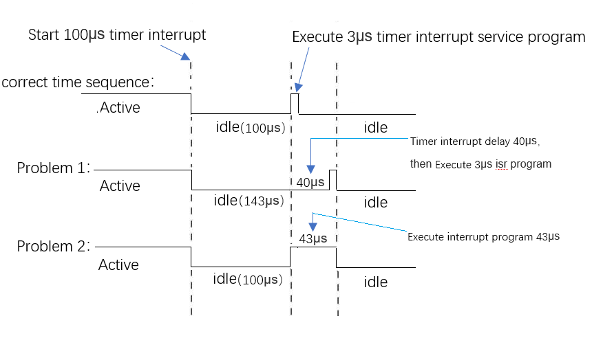

I want to set PWM pulse width in timer interrupt (TIMERA, 125us,need high Accuracy). For power saving,CPU enter idle mode . In my application, every 120 times(15ms),CPU will run 2ms(active mode,not enter idle). So when entering or exiting active programm, the timer will be slow or quick.  If it's quick, i can use CPUdelay() . If it's slow,  I stop the timer,and start another timer TIMERB.
 In interrupt TIMERB,I restart TIMERA
 The simple programmer (not including  2ms function) is following

The correct timing sequence is
Line1:  LED_INTA
Line2:  LED_INTB (when starting TIMRB ,set  high  ,and when entering interrupt TIMERB , becomes low)
Line3:  LED_EXT (when seting PWM , LED_EXT switch)
But
the first time after powering on ,the  timing sequence is
 there are 40us delay before start TIMERB (what does it do) ,and  TIMERB enters interrupt later. So the time of setting PWM is not correct
What's matter?

    In my formal app, I bulid only one task and one hwi timer interruption.  The task is RF receive. After receiving ,pwm width will be set  in the timer ISR. If the task is always active, the programmer is ok. But if I add the idle function(PRCMDeepSleep() etc)in the task loop. (refering to swra486).  the ISR will be broken for 40us accidentally. So ,the time setting pwm is not correct.  I don't know what happen .

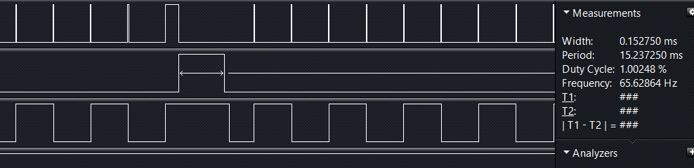

    I'm not sure I can actually see the delay you are describing. Running your demo, this is the output I get at all time over several seconds:
    My question is, do INTA and INTB need to be connected like this? Currently there is a small "gap" in INTA when INTB is running, is this gap something you require or could you simply setup two separate PWM signals for this?

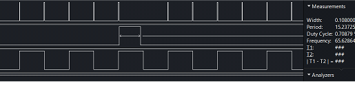

  • Hi M-W
    Did you observe the first times after powering on . Ii happens on off-line(not ccs debugging)
    I  set PWM on INTA and INTB, so, it is continous.
  •    What causes interruption of timer delay 40us ? M3 has only one timer HWI  .
      If M3 is active , Timer HWI is correct .
  • It do sound like you are simply experiencing the latency it takes for the device to go in and out of LP mode.
    When running with the debugger, the device never really goes into low-power mode as the debugger is attached, this is not the case when running without debugger.
    If you comment out your "custom power saving" code in teh while(1) loop, you should see the same timings with or without debugger.
