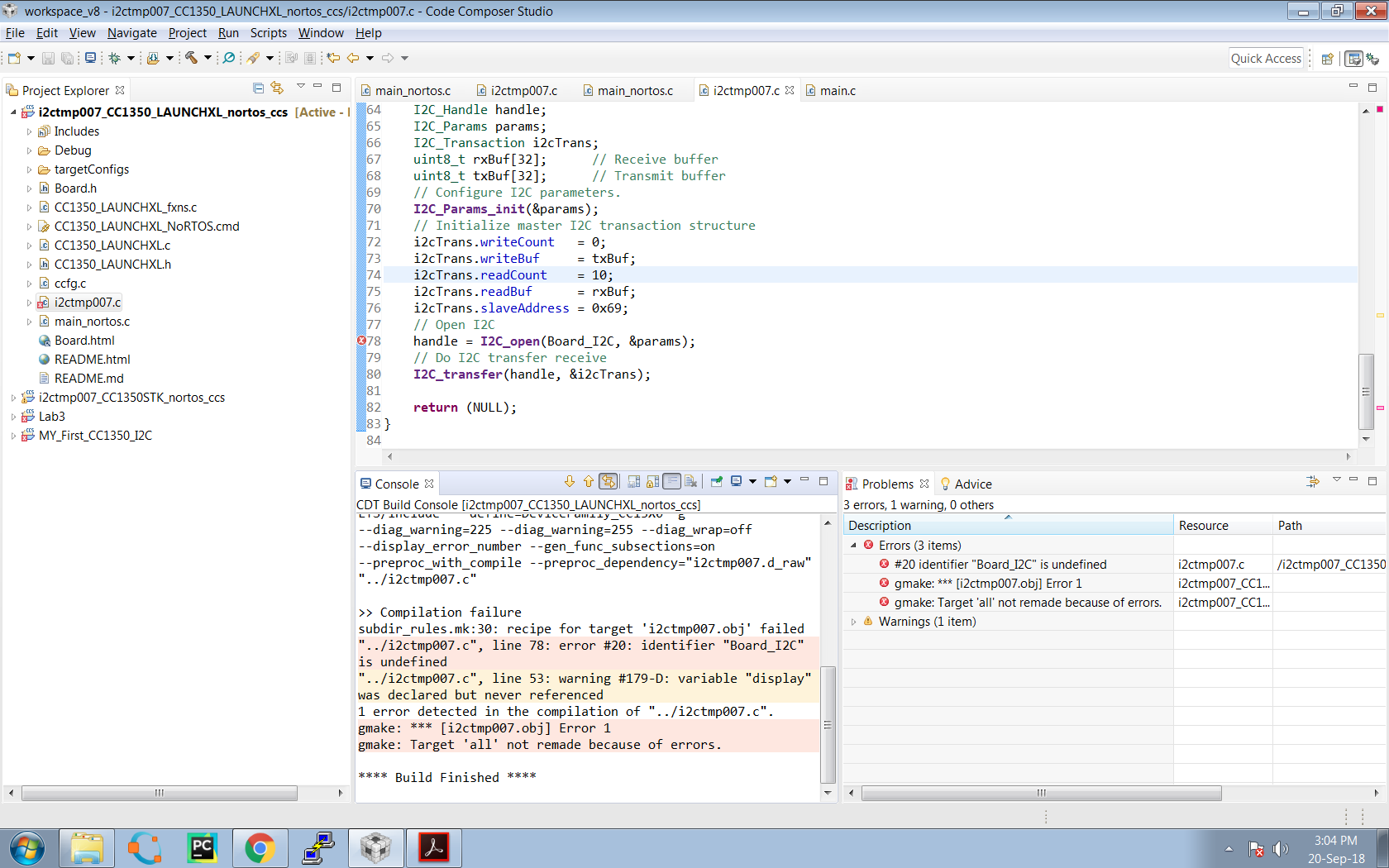

I'm new to embedded coding, I'm trying to read a 64 byte data, byte by byte through I2C, I have used the code given by TI examples. I'm getting error while building the project itself.

    Have you modified anything on the project so far?
    Can you first try to delete the project from the workspace and re import it and try building without making modifications.

  • Hi AB,
    I have not modified the code, I have only changed the only slave address, and I tried by deleting the project from workspace, it din't help.
