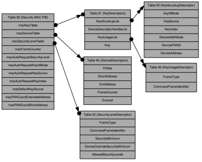

    JDLLC_DEFAULT_KEY_SOURCE and keyIdLookupList are related. JDLLC_DEFAULT_KEY_SOURCE sets up the default key that this device is using on the outgoing packets, keyIdLookupList is the look up list where the device will match the incoming frames with a source key to find the security key and decrypt the packets.
    To give you some perspective,
    Key Source: is used to identify the source of a group key. This key source could be set to the extended address of the Collector to identify that the collector originated the security key. Also this key source field is used when the device is looking for a security key.
    Key Index: this is used as a unique ID for a specific security key under a keySource. So for example if the Collector generates multiple security keys then all these keys will be under the same KeySource but they will have to be stored with different KeyIndex if they are all being used of course.
    The actual things that are used for encryption and decryption are the device's extended address and the KEY_TABLE_DEFAULT_KEY. Therefore in order to be able to decrypt packets from a specific device, first you need to have this device in your device list and you need to know the extended address of this device.
    Using key ID Mode 3 can be helpful in a situation where you have multiple devices generating keys and using different keys in the network. This way the receiving device and find the security key that was used to encrypt a packet based on the key source and the key index.
    In the way that the out of the box examples are done it would make sense to use key ID mode = 1 as you mentioned since we are using only 1 predefined key.
    If you want to use multiple keys you can use the API ApiMac_secAddKeyInitFrameCounter to register multiple keys, you can see how this is used in Cllc_securityInit also make sure you use different values for replaceKeyIndex for each address you are using.
    Also make sure you set the attribute "ApiMac_securityAttribute_keyTableEntries" to 2 to specify that you need 2 table entries.
    Also there are other defines in api_mac.h that you probably will need to take a look at such as MAX_KEY_TABLE_ENTRIES.

    In Cllc_securityInit, ApiMac_securityAttribute_defaultKeySource defines the default key source for outgoing frames when key ID mode 0x01 is used. Hence, in Cllc_securityFill (for outgoing frames) the data loaded into pSec->keySource is ignored for key ID mode 0x01 - but is used for key ID mode 0x03. I can choose whatever key index to use (pSec->keyIndex = secKeyIndex) for both key ID modes.
    Cllc_addSecDevice is called when new devices are joining (the frame which invoked this function however, is NOT secured - hence we do not know which key index and default key source that this new device will use for future frames, at this stage). Finally ApiMac_secAddDevice(&device) is called, and "security" data for the specific device is stored in the MAC so that future frames can be decrypted(?) The key identity data is loaded into device.keyIdLookupData. So here the key identity data is stored for each unique device. But why is the same data also loaded in ApiMac_secAddKeyInitFrameCounter(&secInfo) as mentioned above? Are the combination of key identity data and key index used as a lookup inside the deep MAC layer to see if the combination is "stored" in any of the ApiMac_secAddKeyInitFrameCounter(&secInfo) instances - and if so, they will be successfully decrypted?

  • You are not limited to only 1 lookup id, to add more lookup IDs other than the one that you add when you register the key you can use the following API
    ApiMac_mlmeSetSecurityReqStruct(ApiMac_securityAttribute_keyIdLookupEntry, &lookUpEntry);
    Also see below of what changes you would have to do to use multiple keys. this example uses 2 different keys for the same device.

    If you just need to update the key then you can use the code below
    ApiMac_securityPibKeyEntry_t newKeyEntry;
    newKeyEntry.keyIndex = 1;
    newKeyEntry.frameCounter = 0;
    memcpy(myKey.keyEntry, newKey, APIMAC_KEY_MAX_LEN);
    ApiMac_mlmeSetSecurityReqStruct(ApiMac_securityAttribute_keyEntry, &newKeyEntry);
    For now probably stay away from the API "ApiMac_secAddKeyInitFrameCounter" when trying to update a key because I am seeing some strange behavior which I still need to confirm if it is a bug or just not accurate documentation. Only use "ApiMac_secAddKeyInitFrameCounter" when you need to add a key to a specific index instead of updating one.
