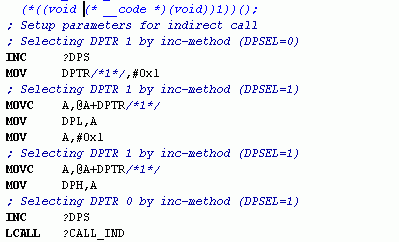

    I have tried the solution: (*((void (* __code *)(void))0))( );
    It was not working and I started investigating the reason. I realized this is not true in my program:  "Thus zero (0) is a pointer to a pointer in code space to a function. "
    On 0x0000 there is LJMP __program_start. This jump instruction will sends the program to __program_start. The reset vector is actually on 0x0001 - 0x0002.
    So the above code has to be modified to (*((void (* __code *)(void))1))( );
    Zoltan
  • Zoltan,
    You are correct.  I was thinking that only the pointer to the program start was located here but in actuality, a reset of the 8051 processor sets the program counter to address zero and starts execution there.  Thus the LJMP instruction at address 0 to the entry point.  So this can simplify things slightly as the value zero can really be considered a pointer to a function rather than a pointer to a pointer to a function.  This makes the line of code look like this
    ((void (*)(void))0)();
    Now it will jump to the LJMP instruction at address zero via a single indirection.  Note that a pointer to a function, by definition, is in the code space so the modifier is not necessary at this level.
    Your investigation shows that the reset vector is effectively part of the LJMP instruction and your modification of my code is also valid.  However, calling the LJMP instruction directly will generate smaller tighter code and actually execute faster.
    Compiling with your corrected code generates the following assembly
    Calling the LJMP instruction directly yeilds
    Which, even though we are adding the additional LJMP instruction in the call, overall the code is tighter and faster to call the LJMP instruction at address zero.
