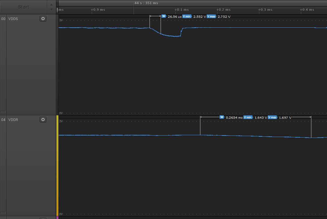

I have an application where the input on VDDS will rise and fall with slew rates close to (and sometimes beyond) the limits specified in the datasheet. In some cases, I observe that VDDR then drops to below 1.65V and the CC1350 subsequently reboots due to brown-out detection (see screenshot from Saleae Logic at the bottom). I have a few questions related to this:
  • Is this the expected behaviour in this case?
  • If so, what exactly is causing VDDR to drop?
  • The problem does not seem to occur when using GLDO instead of the internal DC/DC converter. Can the GLDO handle higher slew rates than the internal DC/DC converter can?

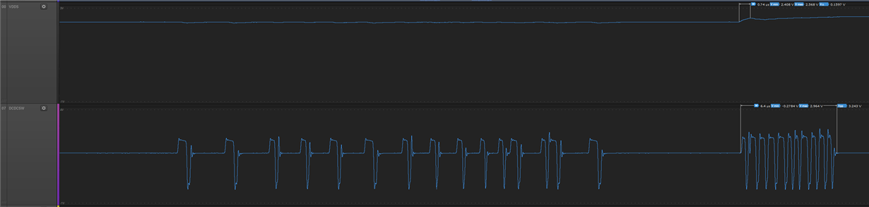

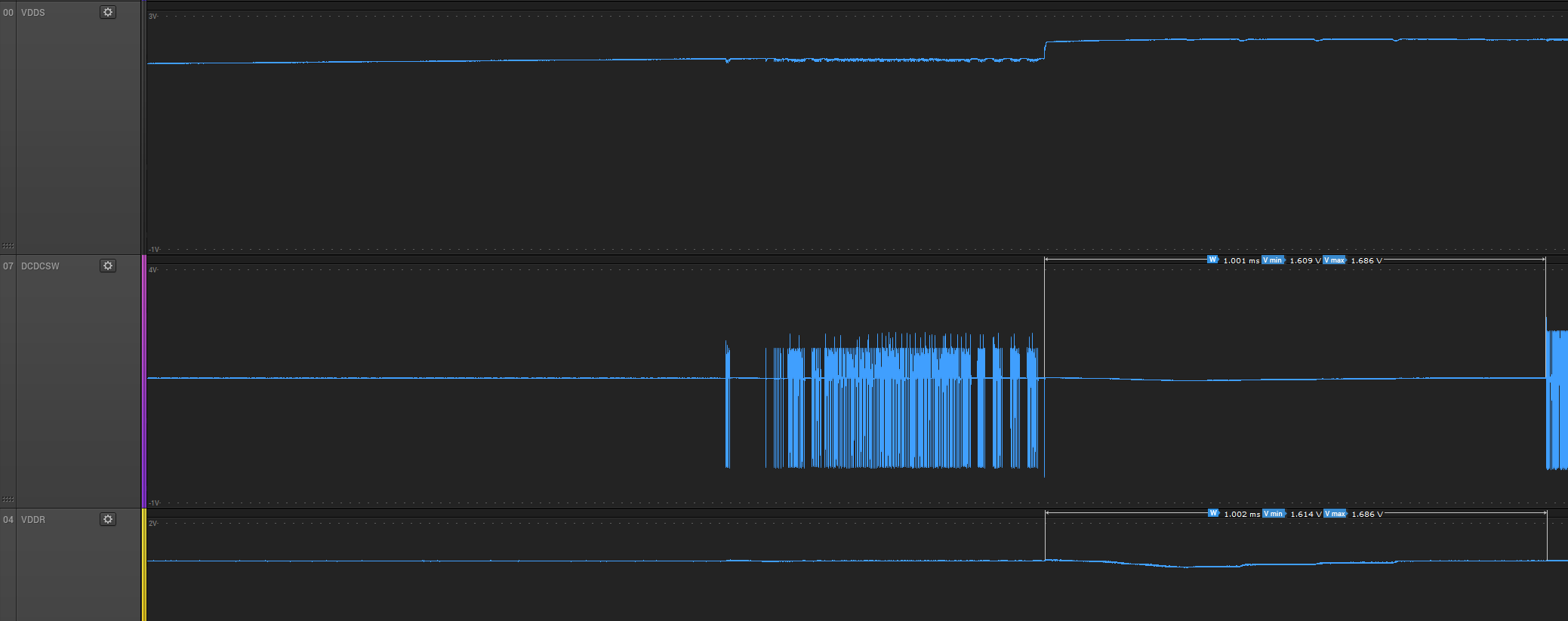

    I have taken a few captures with the DCDC-SW pin (good idea!) at 50 MHz, please see the screenshots below. They are in order:
    1. Positive transient when the fault does NOT occur (no VDDR brownout)
    2. Positive transient when the fault occurs
    3. Zoomed-out view of the ~millisecond just before the positive transient, when the fault occurs
    4. Zoomed-out view of the ~millisecond just after the positive transient, when the fault occurs. On the very right side, the CPU has rebooted after brownout and started up the DCDC again.
    I will try to catch a similar failure that occurs when VDDS is falling quickly as well (like in the capture I posted in the first post).
