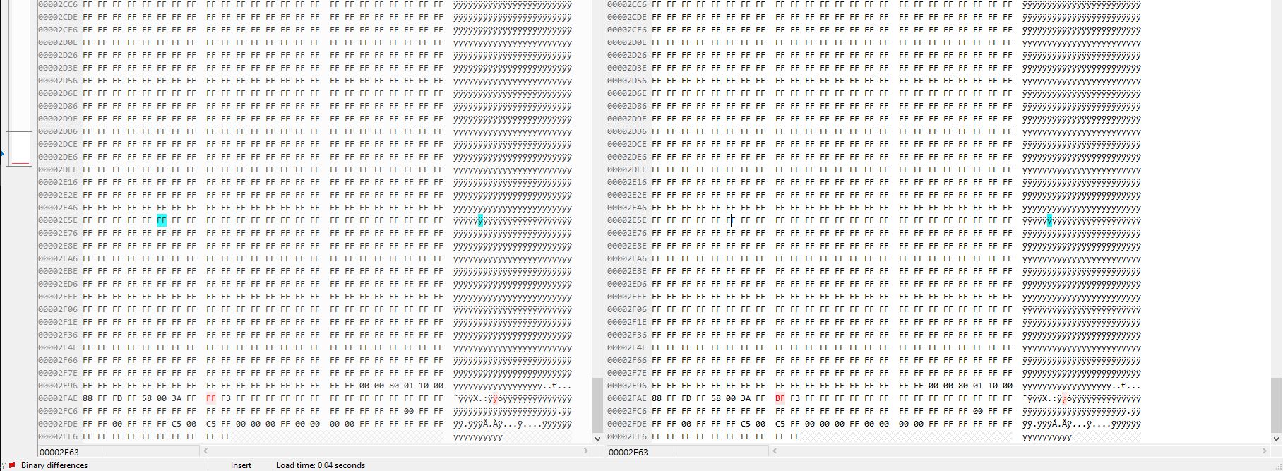

    I attach you a compared picture of ccfg file. The left side is ccfg which our device consuming 1uA and the right side is ccfg which consuming 1.8mA. The only difference is one byte (0xFF <==> 0xBF). Can you tell us what this byte do?
    P.S.: At this moment we are not shure what should change our ccfg file. To be more clear we separate ccfg settings like a .bin file which file we merge with new firmware. By theory nothing and never should be change this file, but some how now we face the one byte difference. Now I did test with different level optimization, and I can`t reproduce difference in ccfg (I`m confuse).

  • Hi Georgi,
    The bit you are looking at is for selecting 32 kHz clock source. 0xFF = LF RCOSC and 0xBF = LF XOSC. This is something that has to be set by you somehow.
    It looks like you do not have a 32k crystal on your board, right? If so, when the CCFG is set to run off the crystal and it is not present it will run the SCLK_LF from RCOSC_HF instead. This will again prevent the device from entering Standby which explains the current consumption you see.
    Fredrik
