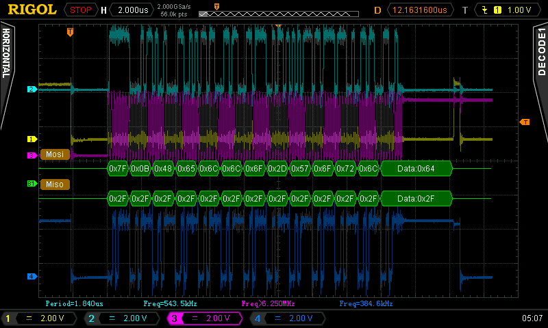

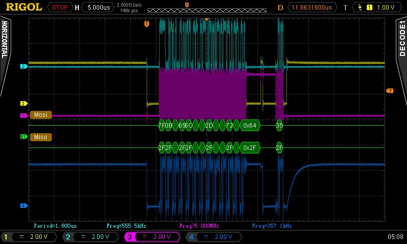

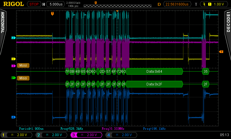

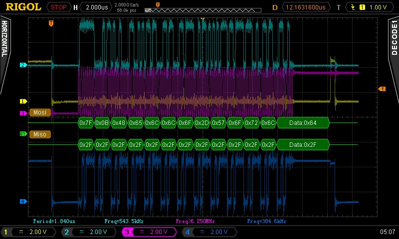

    I have attached traces for the working and non-working scenarios. In both cases STX is being issued after FIFO write is complete. The data string is "Hello-World" radio is configured in variable packet length mode.
    Overall in this case the total transaction time to complete FIFO write is about 45uS.
    1. Working Case full capture -
    2. Not Working Case Full Capture
    In this case the total transaction time is around 25uS.
    Working case FIFO capture
    Not working case FIFO capture.
    In both cases same data is being sent.
    I did try changing the controller speed, that doesn't really help. Whether i keep the strobe on, or strobe after the FIFO write is complete, the result is the same. So i have not captured traces where i have STX is on and FIFO is being updated.
    santosh

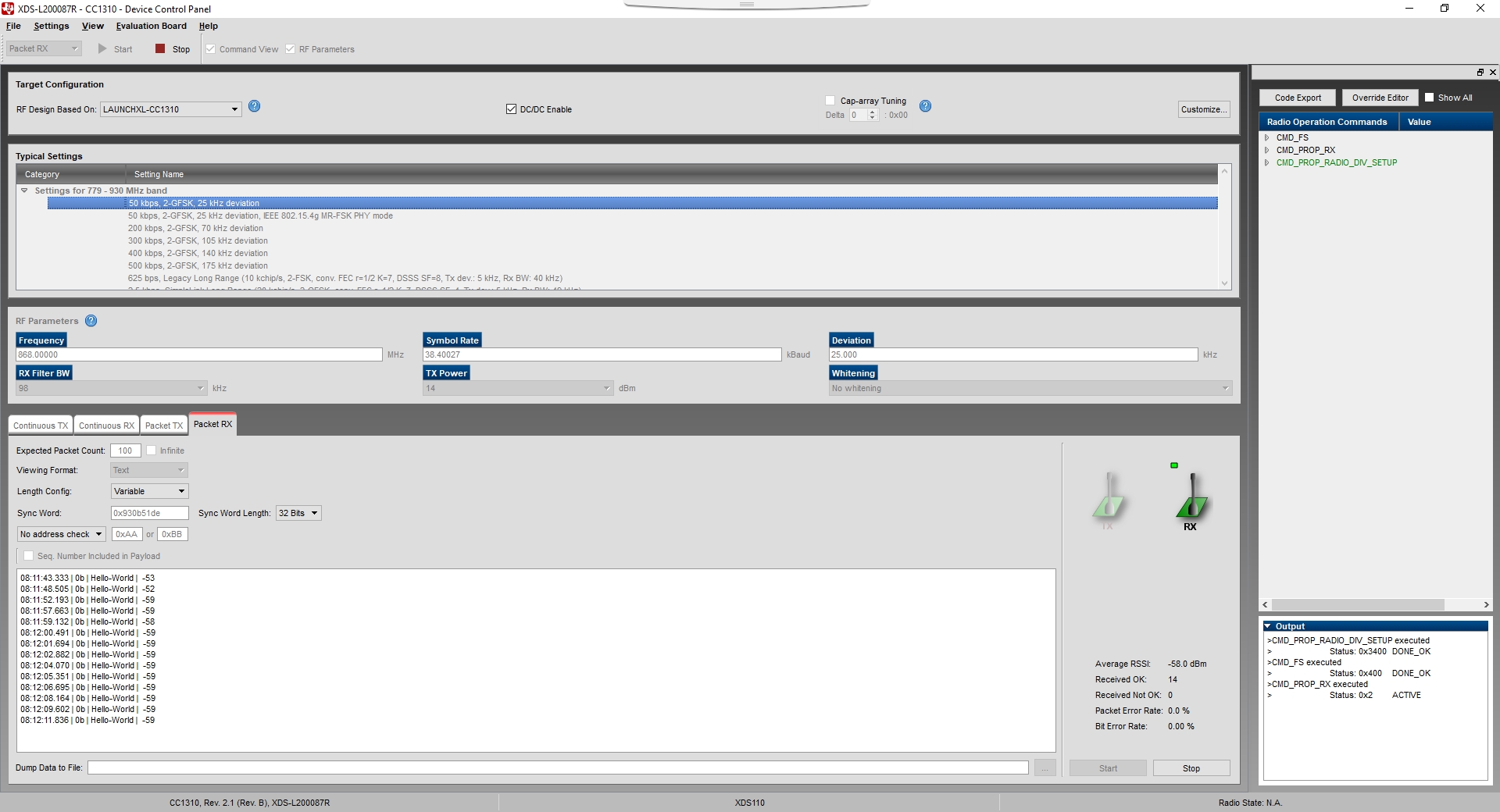

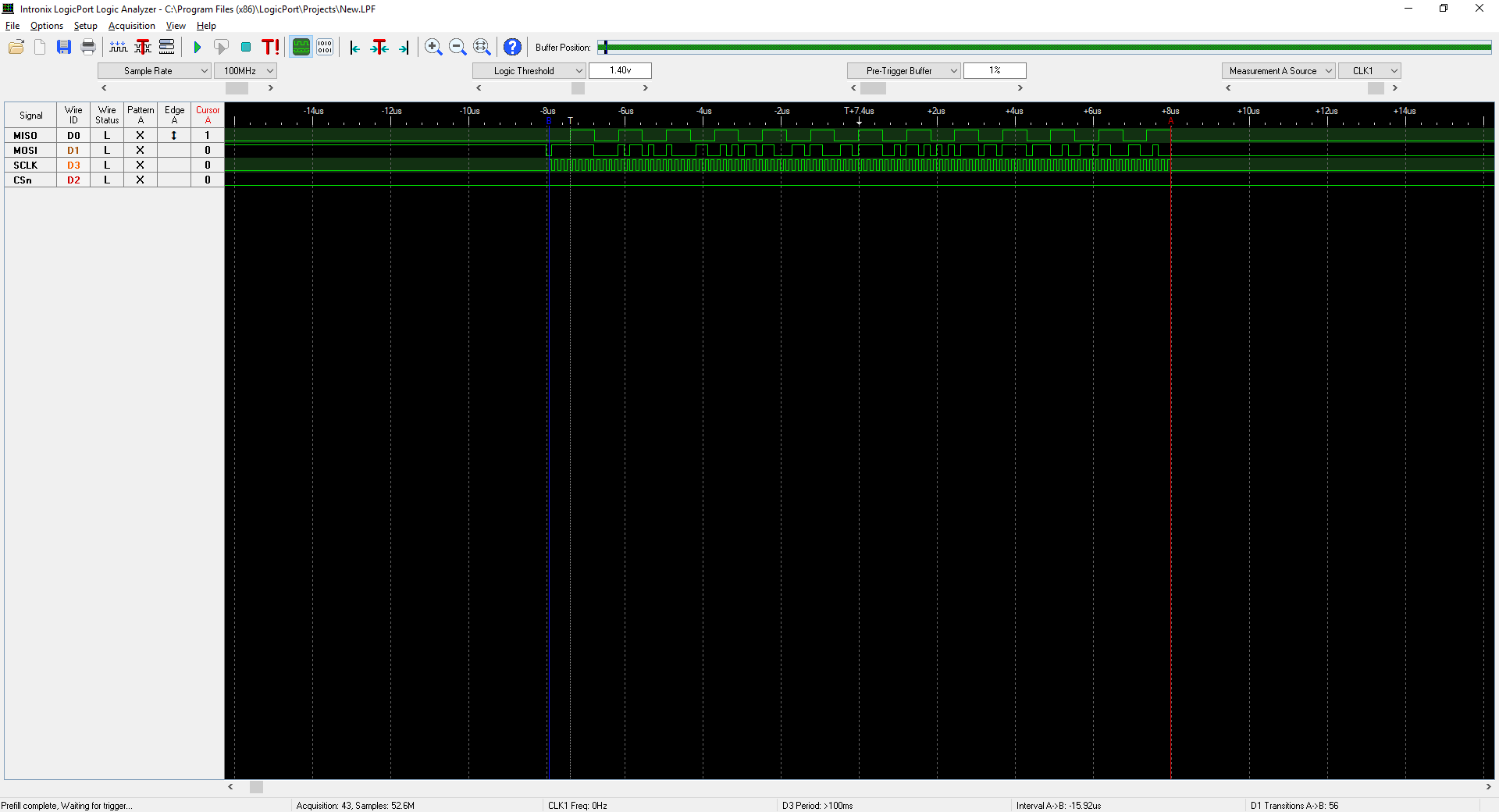

    I was finally able to find an MCU that did true back-to-back SPI transfers, and tested the CC1200 by writing the packet "Hello-World" to the TX FIFO. My SPI rate was 6.25 MHz.
    a plot of my SPI traffic is shown below:
    All packets were received OK with Studio:
    I could not test the data rate on the radio that you are using since I only had a CC1310 as receiver. However, I cannot understand that the RF should be the problem since the problem is "solved" by inserting delays on the SPI.
    I sent several 100 packets and all were received OK.
