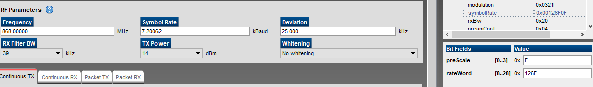

I'm following your CC1310 I/Q sample example and working on CC1310 Launchpad. I set my symbol rate to be the following value:
According to the I/Q sample application note :

    Thank you for your recomendation. I have changed deviation to 3.5kHz. I was using another CC1310 to do continuous TX without modulation and use SMA cable to connect both receiver and transmitter. I'm a little confused, as I'm now doing I/Q sample collection and not doing demodulation, or even my TX signal is just carrier which means I suppose to get DC. Is that right? In my case, will deviation value be a problem if it is not half of symbol rate for I/Q sample collection?
    Both I sample and Q sample are 12bits which is also the resolution of your ADC. In my test, I set my symbol rate was set to 7.2kBaud, so according to what your mentioned, in thereceiver ADC, the data rate is 4 times my symbol rate setting which should be 28.8kbps. Thus, I sample rate should be 2.4k sample per second. Is it correct?

  • Thank you for your recommendation. I have changed deviation to 3.5kHz. I was using another CC1310 to do continuous TX without modulation and use SMA cable to connect both receiver and transmitter. I'm a little confused, as I'm now doing I/Q sample collection and not doing demodulation, or even my TX signal is just carrier which means I suppose to get DC. Is that right?
    Yes, but you will see the carrier offset frequency between those two LPs (something in the range of < 10 kHz).
    No, the IQ sample collection do not require a specific deviation value. The code example use modulation index = 1.0. Please, first try to reproduce the results from the code example before you start modify the setup.
    No, this is not correct. Symbol Rate and Data Rate is the same. The IQ (ADC) sample rate in your example is 28.8 kHz.
    If you are thinking of the bit rate of the IQ samples that will be
    28.8 kHz*12 (bit per I and Q sample) * 2 (one I and 1 Q value) = 691.2 kbps
