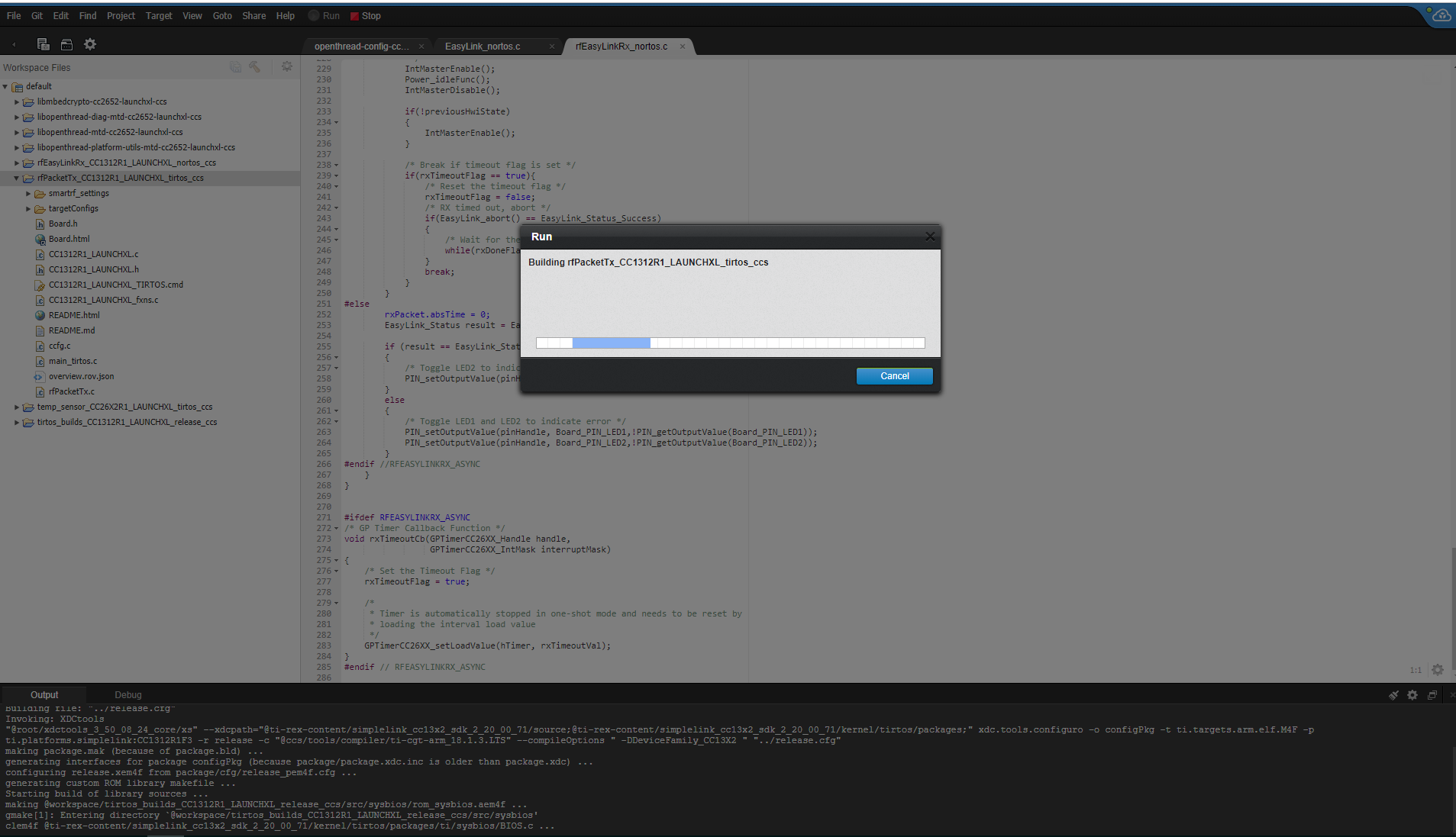

    and then into CCS cloud.
    after some time compiling and doing other stuff it downloaded and ran on my board.
    I am using Chrome on a new installation of Windows 10.

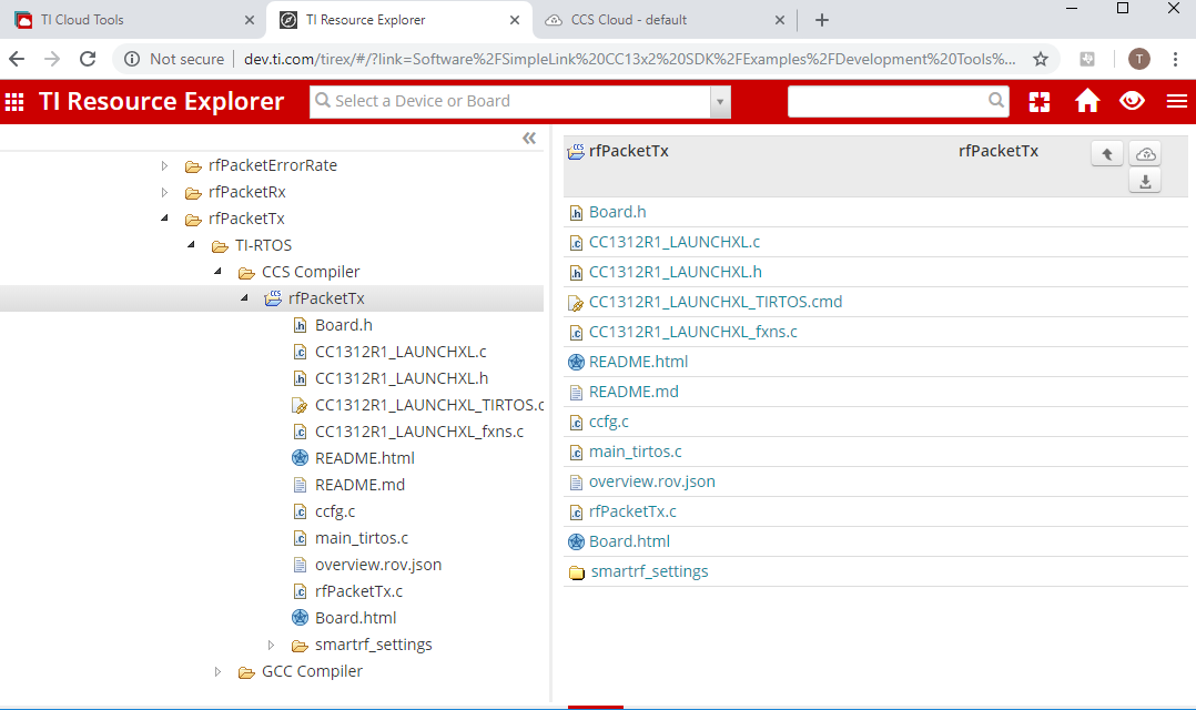

  • I'm using Windows 7 and Chrome 69.0.3497.100. I've installed the latest TICloudAgent.
    I was indeed missing the Cloud button in Tirex, so that did make getting things into the CCS Cloud work to build a first project. Now, I'm stuck trying to get it to run...

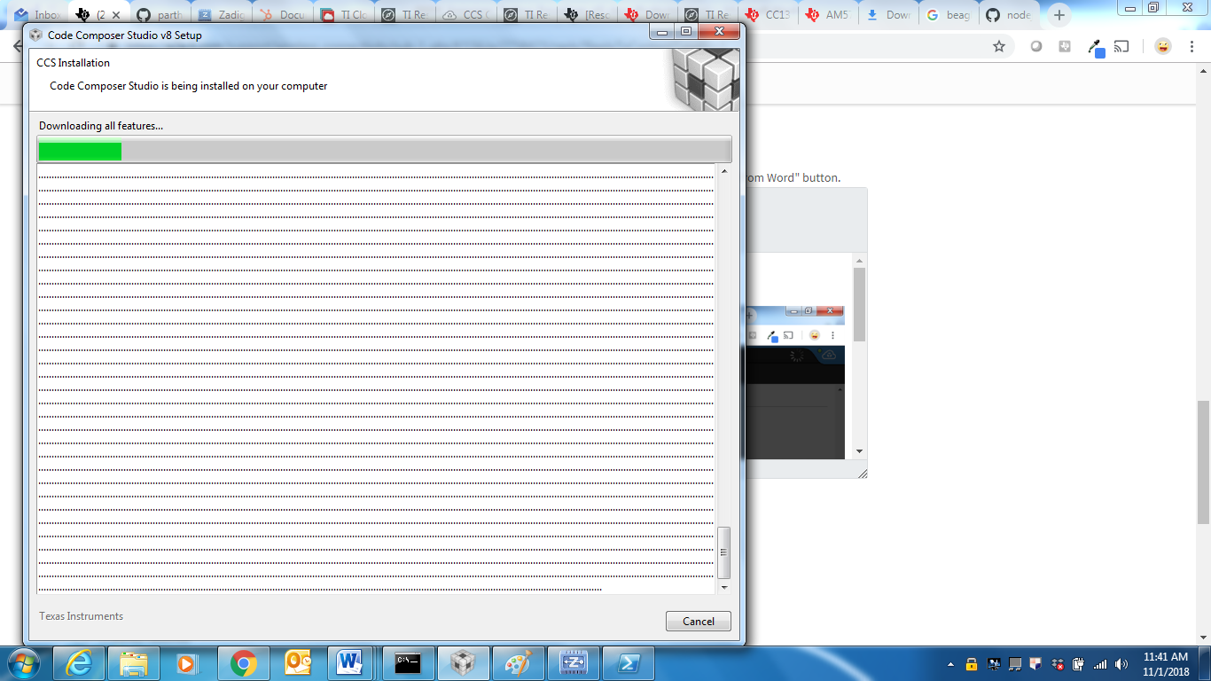

    In the mean time, I've been trying to do the web-based installer that has been running continuously for over 3 days.

    On the CCS side, I have seen the webinstaller fail before. I recommend downloading the offline installer and rebooting your PC before starting to install, then also disable the virus detection during the installation process. The entire process is slow, but should not take more than 10-20 min.
    /TA
  • Using the offline installer for CCS got it installed, eventually. It took a LOT more than 20 minutes.

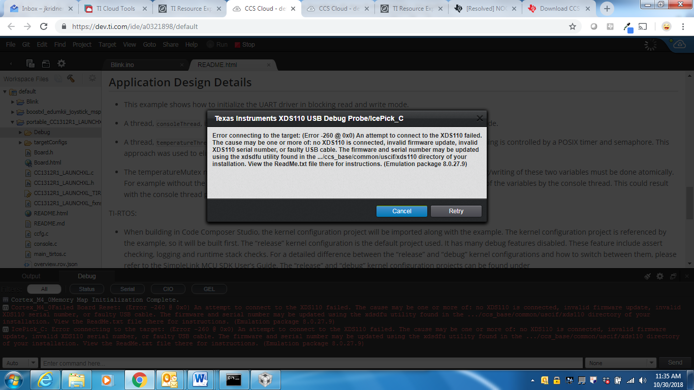

    For CCS:
    Cortex_M4_0: GEL Output: Memory Map Initialization Complete.
    Cortex_M4_0: Failed Board Reset: (Error -260 @ 0x0) An attempt to connect to the XDS110 failed. The cause may be one or more of: no XDS110 is connected, invalid firmware update, invalid XDS110 serial number, or faulty USB cable. The firmware and serial number may be updated using the xdsdfu utility found in the .../ccs_base/common/uscif/xds110 directory of your installation. View the ReadMe.txt file there for instructions. (Emulation package 8.0.803.0)
    IcePick_C: Error connecting to the target: (Error -260 @ 0x0) An attempt to connect to the XDS110 failed. The cause may be one or more of: no XDS110 is connected, invalid firmware update, invalid XDS110 serial number, or faulty USB cable. The firmware and serial number may be updated using the xdsdfu utility found in the .../ccs_base/common/uscif/xds110 directory of your installation. View the ReadMe.txt file there for instructions. (Emulation package 8.0.803.0)

  • Which CCS version do you use?

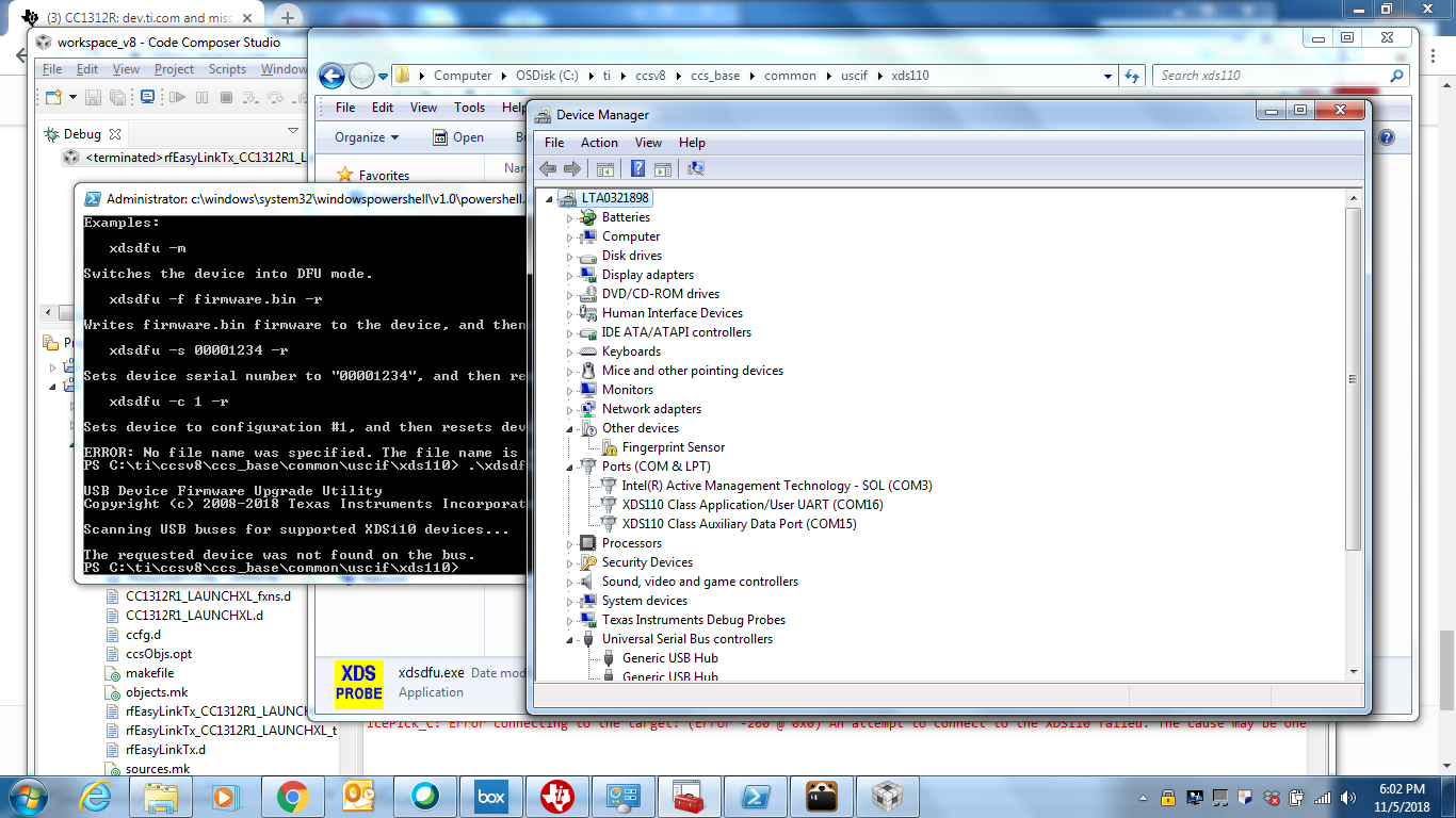

  • The issue is related to the USB host port on my PC. The failing port is a USB 3 (Superspeed, blue connector inside) and the working port is USB 2 (High-speed, black connector inside). I'd tried several different cables and the cables didn't mater.
    What made this difficult to discover was that Device Manager repeatedly showed the XDS110 device enumerate and disappear, yet even 'xdsdfu -e' could never see any XDS110 device. At least looking at that utility convinced me to look more and more at the hardware level until I decided to try a different port.
