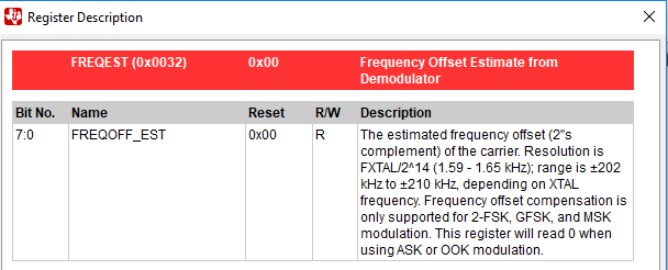

Hello, I am trying to find the exact frequency to which I transmit from another transmitter, with the rssi approximating me up to + - 0.5 mhz,
however it is not enough to decode the signal correctly. Is there any value to help me find it more accurately, or to decode with a higher tolerance range?
Thank you

    We have a register inside the CC1101 that will provide an estimate of the frequency difference (or error) between the TX node and the RX node for any given packet.
    Here is a quick snapshot from our SmartRF Studio online guide.
    Here is a function that we have developed to show to convert this information into Hertz.

  • It works in async mode? I have no packet in fifo
    Thank you
  • Does this not help you? If not, then you need to further explain what it is you are trying to do.
    /TA
  • It works, thank you for your help!
