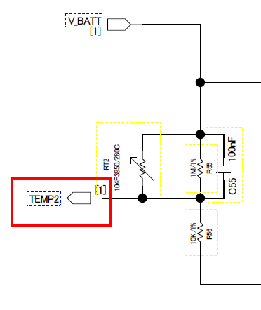

  • answer 1 : The input of the ADC is the value of the temperature sensor as seen in the schematic.
    answer 2 : The current temperature is measured through the electronic thermometer.
    The correct value was the same as the value of the electronic thermometer.
    The incorrect value produces a strange value that is very different from the temperature value.

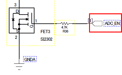

    1.The circuit configuration consists of [ADC Enable Pin] to reduce current consumption and [ADC Pin] to read Temp sensor.

    (2).Set [ADC enable Pin] to HIGH.
          (PIN_setOutputValue(pinEnableHandle, ENABLE_ADC, HIGH))

  • Have you measured the voltage on the temp2 node using a scope? Since you use a 100 nF cap I assume this node needs some time to reach a valid state after you switch this path in.
  • I removed 100 nF Cap and the normal ADC value is read. Thanks.
