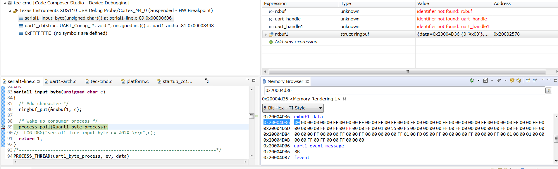

  • Hi Edvard, Keith,
    Customer did below modifications in their codes, but UART1 does not work.
    It seems initialization fails. Just after UART1 initialization, RSR bits are already set as below.
    (these bits are 0 for UART0)

  • Hi Edvard, Keith,
    We found the issue in pin configuration. UART1_RX pin is active-Low signal, so it needs to be pull-down for proper operation.
    The pull setting is copy&paste from UART0 setting.
    const PIN_Config BoardGpioInitTable[] = {
       CC1312R1_LAUNCHXL_UART_RX   | PIN_INPUT_EN | PIN_PULLDOWN,                                           /* UART0 RX via debugger back channel */
       CC1312R1_LAUNCHXL_UART_TX   | PIN_GPIO_OUTPUT_EN | PIN_GPIO_HIGH | PIN_PUSHPULL,   /* UART0 TX via debugger back channel */
       CC1312R1_LAUNCHXL_UART1_RX | PIN_INPUT_EN | PIN_PULLDOWN,                                            /* IOID_12 UART1 RX -181101(I)- */
    On the Launchpad, UART0_RX is connected to TM4C and I guess TM4C drives UART0_RX to high as long as no active pulses on UART receive line. So no issue was observed on UART0.
    I think UART0 code also needs to be updated to PULLUP to avoid confusion.
    Thanks and regards,
    KoT
  • Of course, I forgot about the default initialization in BoardGpioInitTable... Yes, the UART0 pins are default initialized in the BoardGpioInitTable for convenience. This means that when you want to use UART1 with some other pins you need to either add the pins to the BoardGpioInitTable (as you have outlined above), or manually initialize them in your uart1-arch module.
  • I had one mistake in previous post.
    Wrong:
    Correct:
    UART1_RX pin is active-Low signal, so it needs to be pull-up for proper operation.
    So current pin configuration for UART0_RX is not correct, even there is no issue on Launchpad hardware.
    Thanks and regards,
    KoT
  • So just to confirm, with the pull-up configuration the UART1 line now works?
  • Yes. UART1_RX with internal pull-up works fine.
    Thanks and regards,
    KoT
  • Ok, thanks for the feedback KoT. I will create a PR for this.
