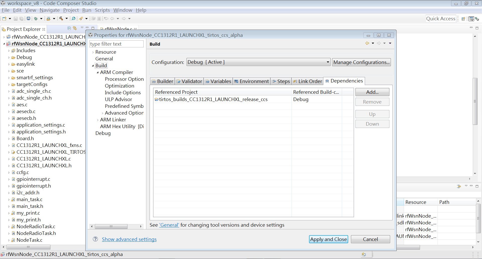

Copy old project to workspace_v8 and use Project > Imort CCS project to import it to CCS.
Right click the imported old project > properties > Build > Dependencies, remove all and add tirtos_builds_CC1312R1_LAUNCHXL_release_ccs.

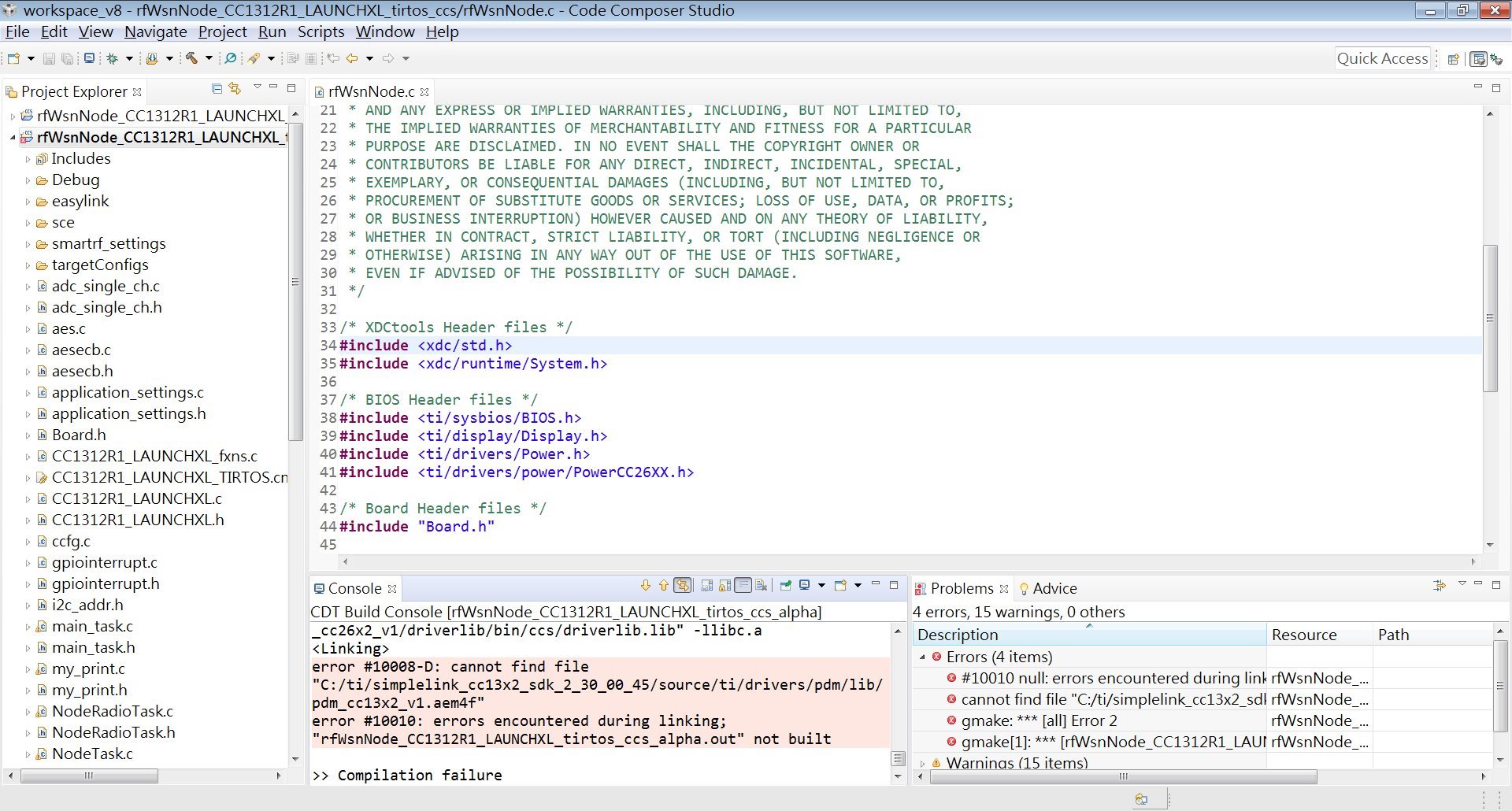

Then build fail....
How can I import old sdk version project to new CCS project?
