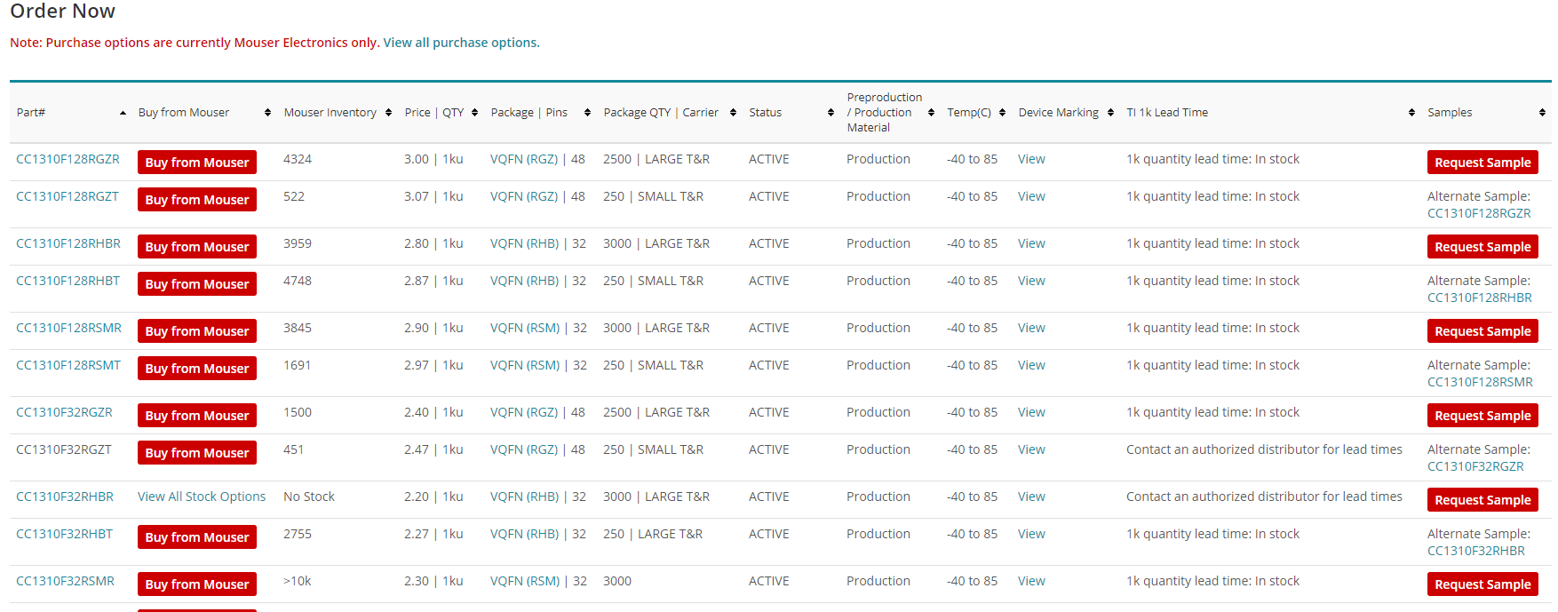

    1) photo of eStore ordered part that came from digikey not mouser, appears by date code to be v2.1.   We have boards at the assembly house getting parts swapped and don't know for sure of version of silicon until we get those boards back and connect to JTAG.
    2) eStore web order - NOTE it says Mouser, but parts come from Digikey.

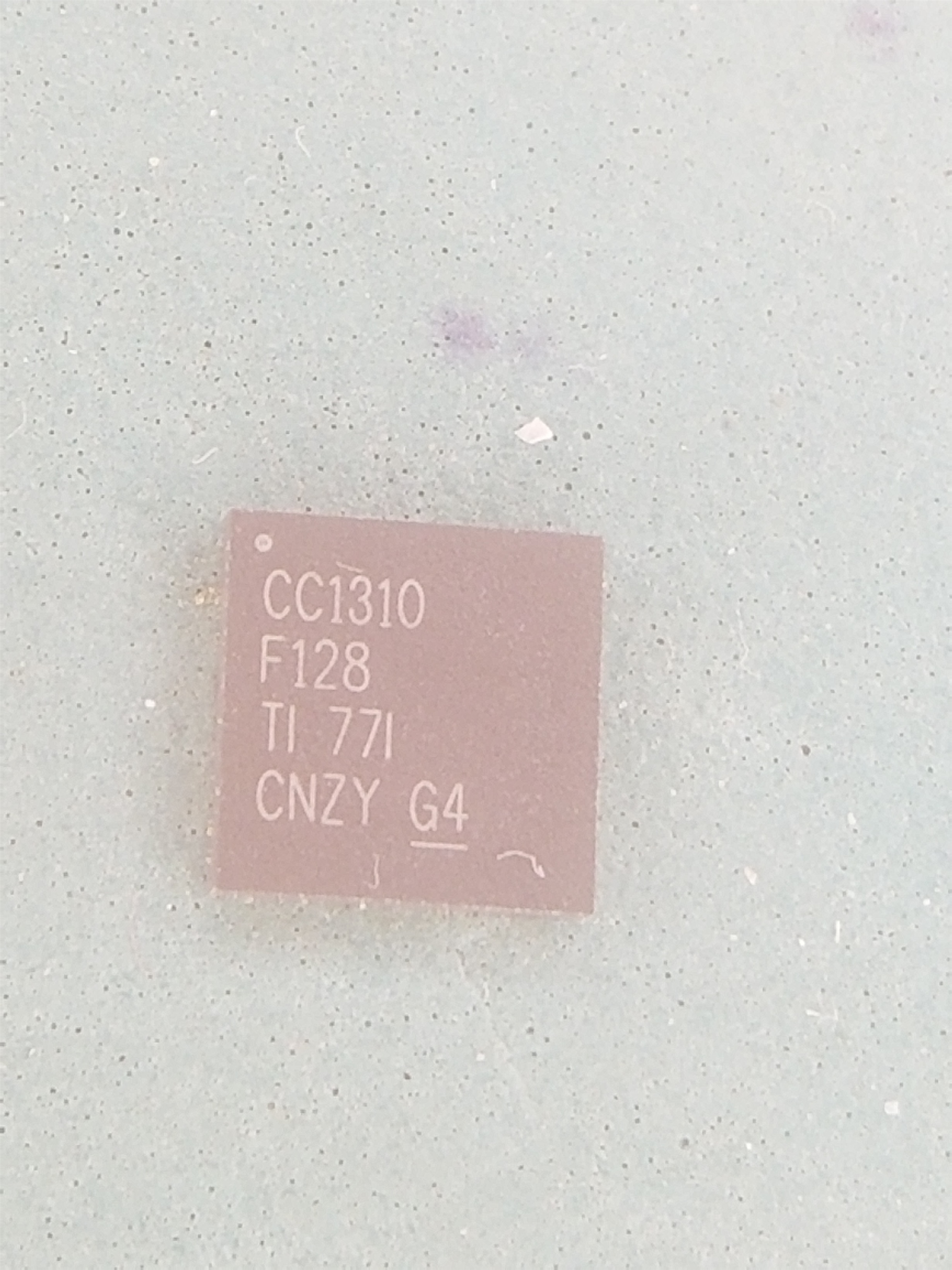

    3) Photo of "BAD" silicon v2.0.

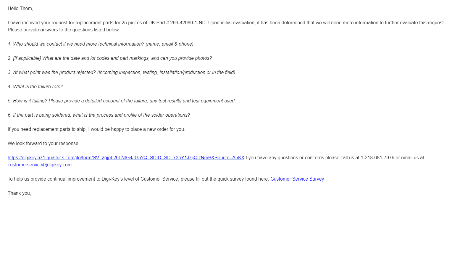

    photo of email from Digikey - they are very concerned that the solder temperature profile may have reversed the silicon from v2.1 to v2.0 and changed the markings (I'm kidding in an attempt to keep a sense of humor).   Pretty gutsy asking for a customer review of digikey.

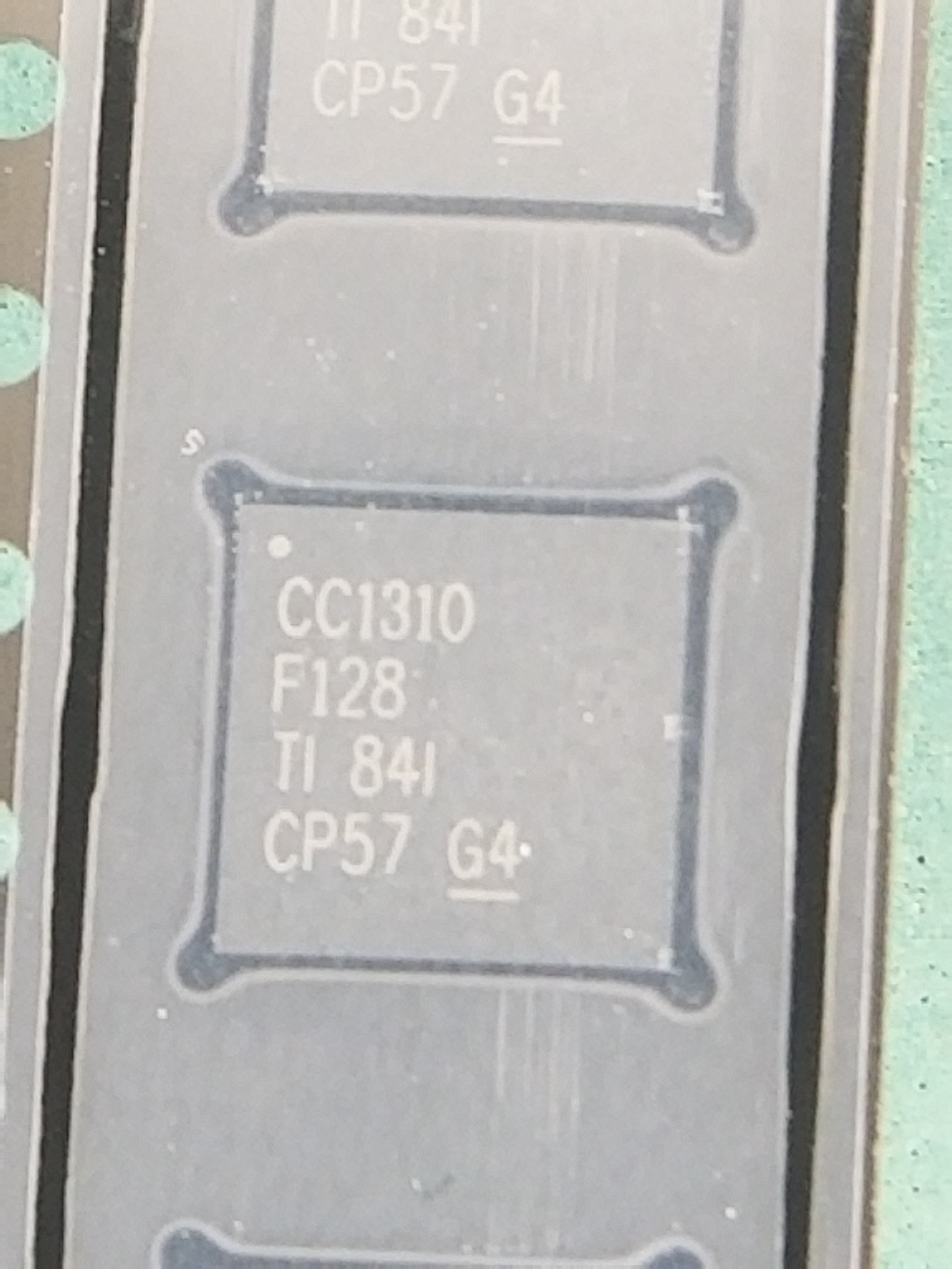

  • Received another order of parts from Digikey / cc1310 7x7 128K and here's an image.   Markings are different and one our team believes it is April 2018  (84) - can you please confirm.    We have very little margin in our board build schedule for our CES demo and it would be painful given the holidays to remedy if the boards get stuffed with the wrong stuff.   Thanks TER for the assist and have a good Thanksgiving.
  • Yes, that is a device from April 2018.
