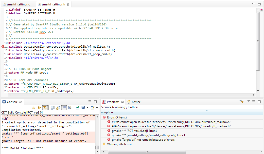

Hi Yikai, I copied the smartrf-setting.c and smartrf-setting.h codes in my project, but I have some errors. The compilator not found the library. How Can I resolve this errors?

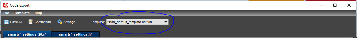

If you export code from SmartRF Studio you get this:
#include <ti/devices/DeviceFamily.h> #include DeviceFamily_constructPath(driverlib/rf_mailbox.h) #include DeviceFamily_constructPath(driverlib/rf_common_cmd.h) #include DeviceFamily_constructPath(driverlib/rf_prop_cmd.h) #include <ti/drivers/rf/RF.h> #include DeviceFamily_constructPath(rf_patches/rf_patch_cpe_sl_longrange.h) #include DeviceFamily_constructPath(rf_patches/rf_patch_rfe_sl_longrange.h) #include DeviceFamily_constructPath(rf_patches/rf_patch_mce_sl_longrange.h) #include "smartrf_settings.h"
Why have you changed this piece of code?

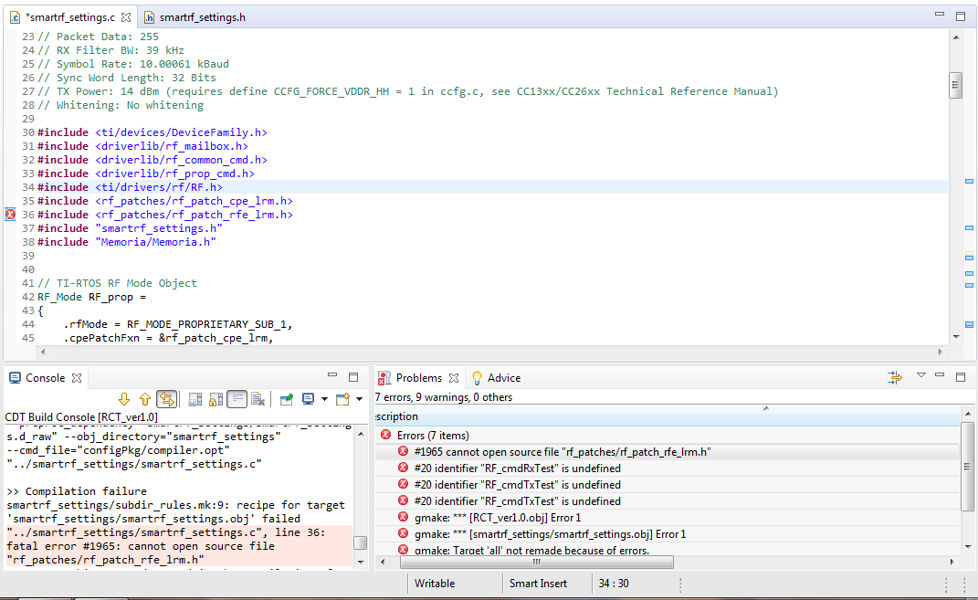

Ok, I want to enable the LRM on my project. This project is to create from my ex collegue, that now I should to modify and I apply the LRM. The project use the TI RTOS 2.16.01.14. I for apply the LRM, copied the smartrf-setting file of SmartRF to my code..but I have some errors in compilator. How Can I resolve this errors?
