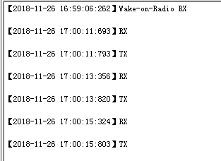

In the example of WOR-RX,I want to send back the received data.It works, but there was a problem:There is a long interval between sending and receiving data!
Based on the results of my tests, I think the module will send data after the next wake-up.What should I do while maintaining low power consumption?

    How do your WOR implementation function, is it exactly like in the example or have you modified it in any way?
    Would it be possible to share your complete code?
  • Sorry, the code won't be displayed until tomorrow. What information do you want to know? Do you think it's reasonable for me to do this? Would it not be able to send data immediately because it was dormant?
  • The interesting part here is to see how you combine WOR with the TX part, let's look on this again when you have the code available. As for feasibility, I think what you want to achieve is possible.

    /*-------------My Add-----------------*/
    static void txTaskFunction(UArg arg0, UArg arg1)
    /* Initialize TX_ADV command from TX command */
    initializeTxAdvCmdFromTxCmd(&RF_cmdPropTxAdv, &RF_cmdPropTx);
    /* Set application specific fields */
    RF_cmdPropTxAdv.pktLen = 31; /* +1 for length byte */
    RF_cmdPropTxAdv.pPkt = txPacket;
    RF_cmdPropTxAdv.preTrigger.triggerType = TRIG_NOW;
    RF_cmdPropTxAdv.startTime = 0;
    while(1)
    uint32_t events = Event_pend(radioOperationEventHandle, 0, RADIO_EVENT_ALL, BIOS_WAIT_FOREVER);
    if(events & RADIO_EVENT_VALID_PACKET_RECEIVED)
    Display_printf(uartDisplayHandle, 0, 0, "RX");
    RF_runCmd(rfHandle, (RF_Op*)&RF_cmdPropTxAdv,RF_PriorityNormal, NULL, 0);
    Display_printf(uartDisplayHandle, 1, 0, "TX");

  • Hi,Did you receive my code?
  • Yes, I will have a look at it and get back to you with feedback.
    I think your issue is due to RF queue placements as you don't know in what order your TX and RX operations are scheduled. I suggest you keep all radio operations inside one task to better control the order they run in. For example, it could look like this if re-using the RX task:
    break;
    default:
    /* Unhandled status */
    break;
    You can of course structure it in different ways, but the point is that you should not spread the radio operations over several tasks unless you are absolutely sure you get the queue placements correct.
  • Wonderful ,You're right man,the order of commands is the key.!After I put them in the same task, the problem was solved.By the way,I only created two tasks, How can I figure out the order of commands in the queue and solve this problem,like Easylink_Abort?
    The best practice here is to do what suggested above, keeping all posting RF Driver calls inside a single task where you can control the flow. You can abort and stop commands that is already running or in the queue by using for example the RF_cancelCmd API.
