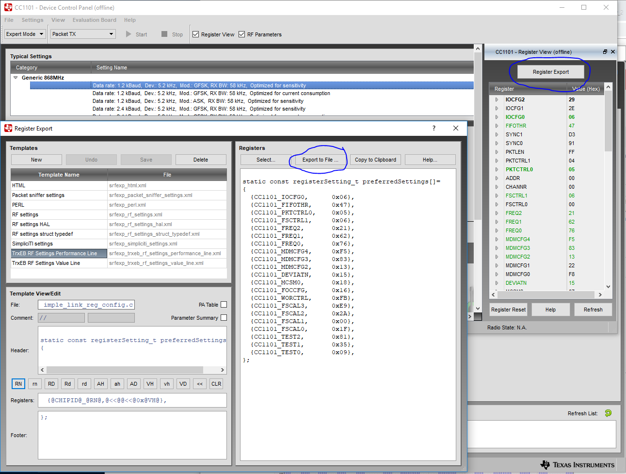

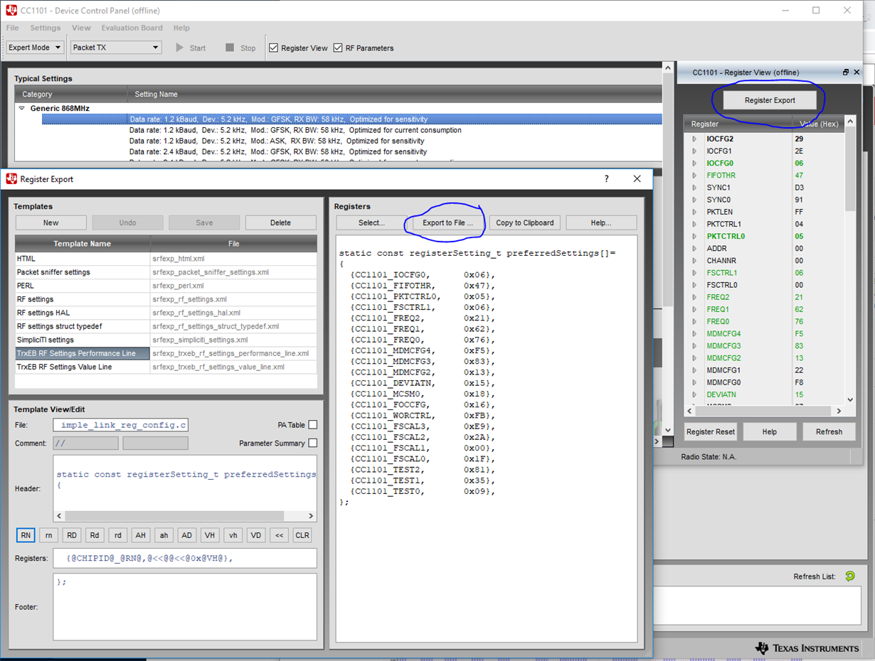

  • I wasn't sure what the Export did; export just seems to show the values in the window on right. It does not save to a file.
    Are the register settings saved to a file by File|Save Config? This creates a xml file with the following values (for 434 GFSK):

  • When you press register export you get a new window where you can select export to file or place the data on the clipboard, dependent on how you want to use the result.
  • Thanks for the screenshot. I understand how the export works now. It is very convenient.
