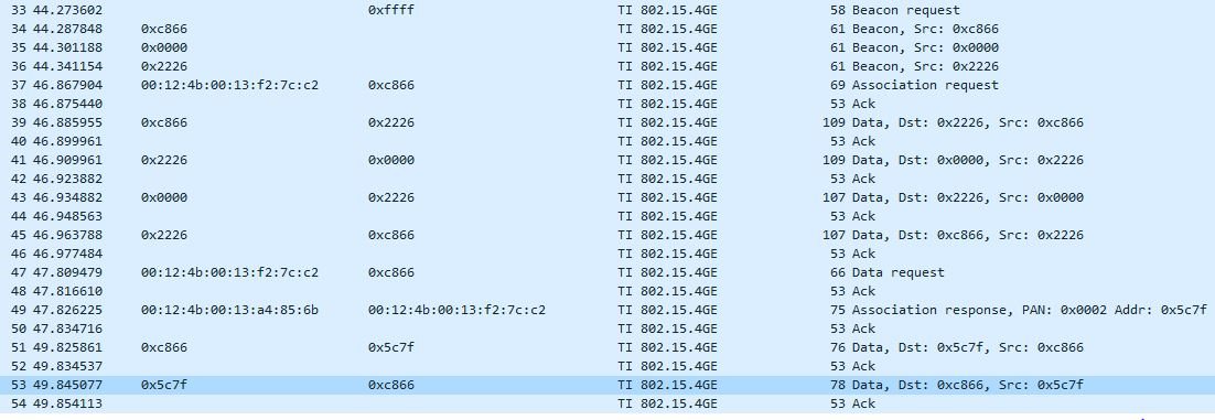

    I have my network set up now so that a sensor can join the network via a router. Here is a packet capture showing one sensor joining the network. To simplify the address allocation the central coordinator records the short address of all nodes on the network and randomly creates a new address upon mac association, checking to make sure it doesn't match any previously allocated short addresses. To do this, when a sensor is joining via a router and issues an association request, the router sends a message to the coordinator which then responds with an association response type message back to the router. The parent router then sends out a mac association response allowing the joining device to fully associate. It is a requirement of my network that any joining device needs the would-be parent router to have communication back to the coordinator and as well as simplifying the address allocation, this mechanism also ensures this. I have implemented zigbee style route records and source routing here so that the coordinator can send a response back immediately along the same route that it received the association request.
    Question:
    In order for the sensor (joining device) to receive the association response, it issues a Data Request. As seen here, the time between issuing an Association Request and a follow-up Data Request is 0.941575s (macResponseWaitTime). Can you tell me where this time is defined? I might need to change it to allow for a large multi-hop association delay.
    Many thanks,
    Andy
    You can modify this value by calling the following API:
    ApiMac_mlmeSetReqUint8(ApiMac_attribute_responseWaitTime, YourValue)
    I believe the default value of this attribute is 48 if you are using 50kbps or 5kbps data rate. Also you can always do a ApiMac_mlmeGetReqUint8 to get the original value of the attribute and modify it based on that value.
