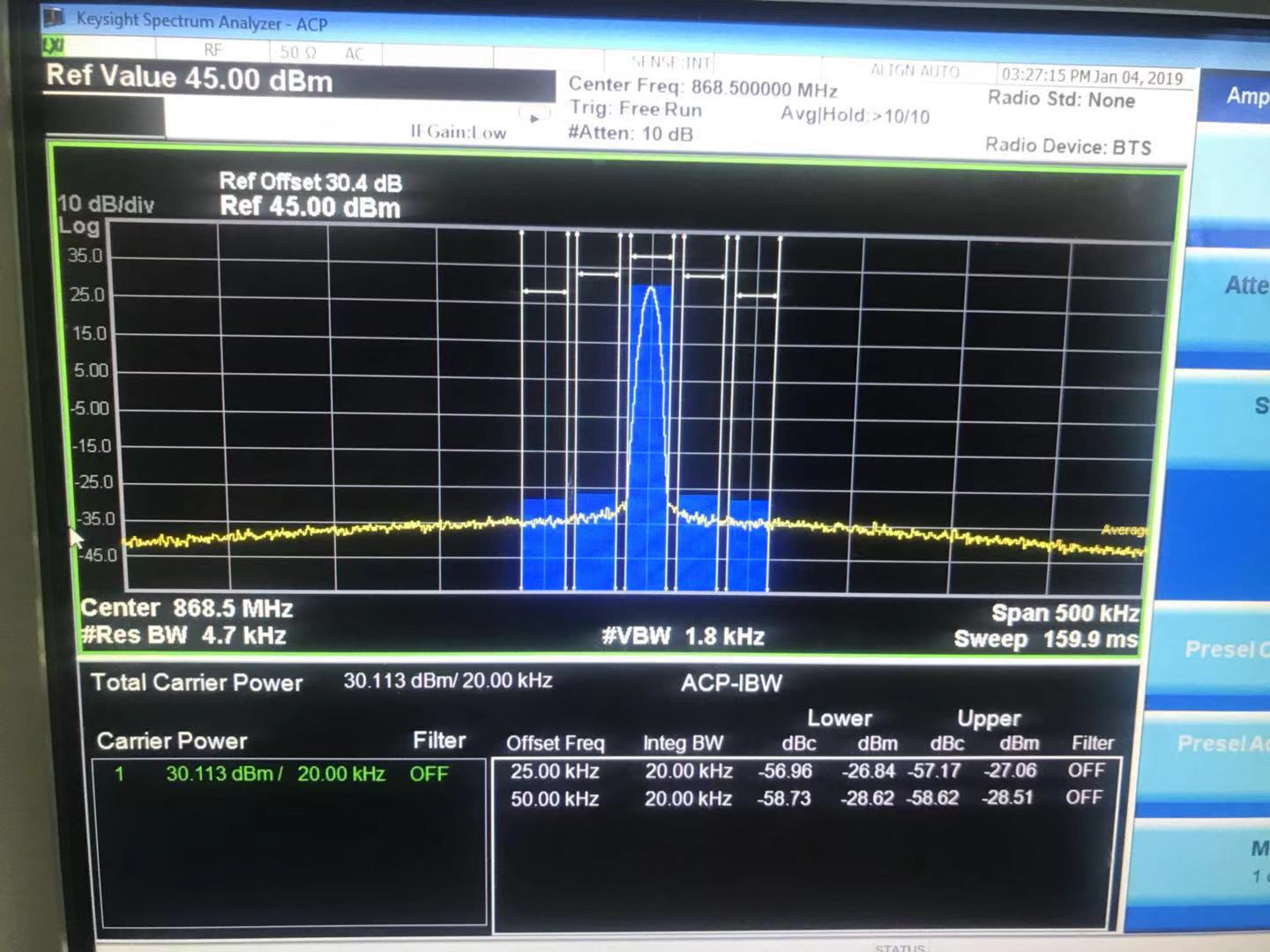

    The figure below is our test results.
    Look forward to your reply,thank you.
    It seems you are measuring Transmit Power in the Adjacent Channel and alternate channel. This is not a Receive Selectivity test. I thought you refer to Receive Selectivity spec.

    This spec depends upon the Data rate, Freq Deviation and Phase Noise.
    In this case , it seems it is limited by the Phase Noise.
    As per the data sheet (Table 4.12.1), the Phase Noise at 10KHz Offset is -101dBc/Hz and at 100KHz Offset is -102dBm/Hz.
    If you integrate this into 20KHz Bandwidth then you will get -101+43 = -58dBm in 20KHz BW. So, your measurement meets the data sheet spec.
    Where as at 433MHz, the phase Nosie at 10KHz offset is -107dBc/Hz. If you integrate this into 20 KHz BW then you will get -107+43 = -64dBm/20KHz.
    That's why it passes in 433MHz band and not passing in 868MHz band. This is a Phase Noise limitation in the chip.

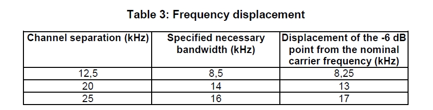

    We use the standard "ETSI EN 300 113 V2.2.1 (2016-12)",It provides:"For a channel separation of 12,5 kHz, 20 kHz and 25 kHz, the adjacent channel power and the alternate channel power
    shall not exceed a value of 60,0 dB below the transmitter power (conducted) without the need to be below 0,2 μW"
    As you describe"If you integrate this into 20KHz Bandwidth then you will get -101+43 = -58dBm in 20KHz BW",If we integrate this into 12.5KHz we can improve the index.
    But how can we compress the signal width? We try to modify the Data rate, Freq Deviation,it,s invalid.
    Thank you!

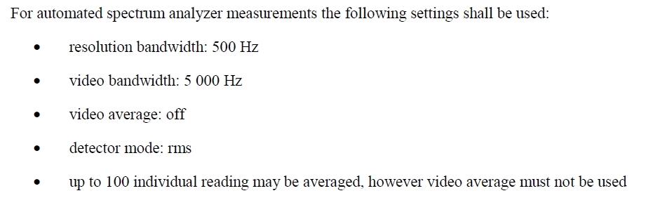

    Yes, I went through the EN 300 113-1 Std and found that your Measurement method is wrong.
    You should use the Integrated BW to 8.5KHz (for 12.5KHz Channel spacing) not 20KHz. You have used 20KHz Integrated BW on the Spectrum Analyzer in your measurement. Please change it to 8.5KHz.
    If you use 8.5KHz IBW, you will get -101+39.3 = 61.7dBc then it will pass the Spec of 60dBc.
    Also please make sure you use the following Spectrum Analyzer Settings. This is also from EN 300113.

    According to the new test method, we have tested again. Our test results are as follows:
    use 8.5KHz IBW we can get 61.5dBc
    use 16KHz IBW we can get 59.5dBc
    The result can meet the chip spec,But the 16KHz IBW can,t meet the standard requirements.
