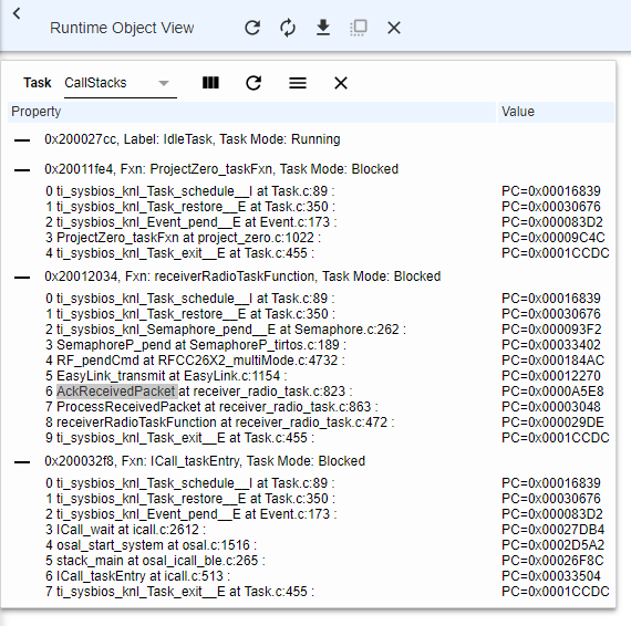

I managed to capture a stack trace from ROV this time. Its in my receiverRadioTaskFunction task. I should note that I am using the DMM concurrent with the BLE stack, and I have that mostly working, but I am still squashing bugs. It took about 4.5 hours for this error to occur, so I really don't have any idea what could be causing it, or how to repeat it. I dont think I am running out of RAM, since there is plenty of space left on the heap.
I'm doing a seemingly innocuous call to EasyLink_transmit(), which usually returns pretty quickly (I haven't tried switching that call to EasyLink_transmitAsync(), but that is my only other idea at this point). I guess I am asking why EasyLink_transmit() would get stuck and how to prevent that... and if EasyLink_transmitAsync() would even fix it?
And, is this something possibly to do with the DMM? I do not think there was any activity on the BLE side when EasyLink_transmit() got stuck, but I'm not 100% on that. I don't think I've ever seen this happen during periods of activity on the BLE side either, but due to the time frames, I dont always have the debugger connected or handy.

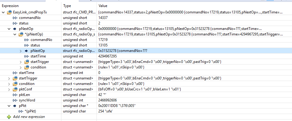

    I'm not sure I completely follow you on the status. In EasyLink_transmit() there is an RF_Op* that is passed as the 2nd parameter to RF_scheduleCmd()/RF/postCmd(). That is EasyLink_cmdPropTx, which appears to have a status field. When I put "EasyLink_cmdPropTx.status" in the expression view, it has a value of 2. This is when EasyLink_transmit() is stuck in the same call stack as in the initial screenshot above.
    Whatever I am doing seems to be making things worse (or maybe better for debugging). This last run only took 10 minutes for EasyLink_transmit() to block (down from 4+ hours). The only variable I can see is the placement of the remote device (that the failing one is trying to EasyLink_transmit() to). They are both on my desk roughly 6-12" apart. Is this maybe too close (i.e. is the transmission blowing out the receiver?) Again, this runs fine for big swaths of time (except for the one this morning)
  • I tried just "EasyLink_cmdPropTx" in the expression view and there's a pNextOp that has a different status. I'm not sure if that helps any:
  • Which SDK version are you using?
    From what I can see, the current version of EasyLink is using EasyLink_cmdPropTxAdv, not EasyLink_cmdPropTx.
  • EASYLINK_API_VERSION "EasyLink-v2.40.02"
    Line 155/156 in EasyLink.c:
    static rfc_CMD_PROP_TX_t EasyLink_cmdPropTx;
    static rfc_CMD_PROP_RX_ADV_t EasyLink_cmdPropRxAdv;

    Over the weekend I left the system running again and it finally crapped out again. This time however, the stack trace from ROV is a bit different. On deeper inspection of the line numbers and functions listed in the Tasks->CallStacks of ROV, they don't appear to line up with actual lines of code. I have optimizations turned off.
    If the ROV callstacks are to be roughly trusted, looking back the the codeline previous to the one listed in ROV, it does appear that it is stalled out in the EasyLink_transmitCcaAsync() call, or possibly on my semaphore waiting for the txcallback to complete (which never got called). It is strange however that my whole program stalls, even the clock I have set to toggle an LED to verify things are running.
