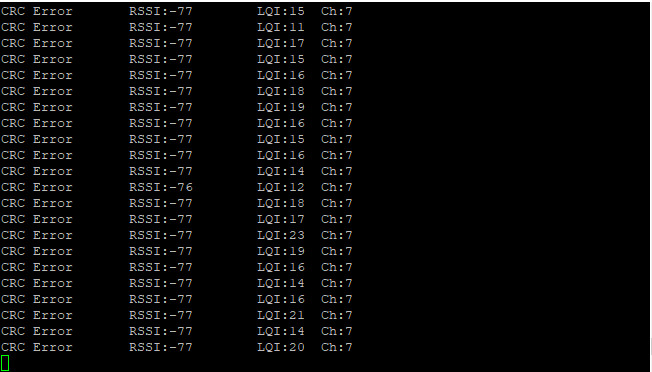

Dear All,
During our product development we are facing a weird issue CC1200 is unable to demodulate the signal properly on certain channels and we always receive CRC error.
Channels being Used: 0 to 63
Issue Observed with Channels: 6,7,19,20,32,33,45,47,58,59
Our CC1200 Settings:

Kindly guide us. Thank you
