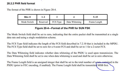

We have however run into problems on the interpretation of the PHY frame length. It appears that the CC1200 interprets the length bits in the PHY HDR in reverse order than specified in the 802.15.4g specification.
The length field in 802.15.4g is located in the PHY HDR and the interpretation should be as follows:

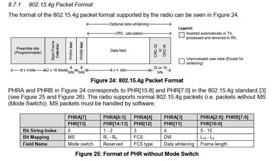

This description appears to fit well with the description in the CC1200 users guide:
The way we interpret this is that if one wishes to transmit an 802.15.4g compliant PHY frame with no whitening, with 32bit CRC, and containing 27 bytes payload the frame should be formatted thus:
00D841ECAB4E61BC0000EA1300386D040000EA1300000408015B5AE7C5
Where 00D8 is the PHY HDR with the length bit-reversed such that the length will go on the air ’MSB first’.
However in SmartRF studio 7 this frame is formattet as:
001B41ECAB4E61BC0000EA1300386D040000EA1300000408015B5AE7C5
I.e. same PHY payload, but with the length kept unchanged and so it will go on the air ’LSB first’.
A CC1200 set into 802.15.4g mode can receive both these frames, but the built-in HW accelerator only terminates the receiver after a total of 29 bytes measured from the sync word in the latter of the two examples. In the first example the receiver will continue receiving until a total of 218 bytes are received.
The question is whether our interpretation of the length field formatting is wrong or if there is a flaw in the CC1200 802.15.4g HW accelerator?

  • I have been thinking and testing quite a bit more on this today – and have convinced myself that CC1200 with PKT_CFG2.FG_MODE_EN = 1 and PKT_CFG2.BYTE_SWAP_EN = 0 will do things in compliance with the 802.15.4.
    I think the development Kit was actually configured wrong in the default state…
    The only drawback, which wasn’t clear to me before, is that we have to bit-reverse all bytes to/from the FIFO in our software because BYTE_SWAP_EN = 1 does not work in 802.15.4g mode.
    So what I gather is that the 802.15.4g accelerator works on data as they appear in the FIFO and not as they appear on the air. Therefore it will only work properly when BYTE_SWAP_EN is 0.

  • Hi Anders,
    As noted in the User's Guide, 8.7, "BYTE_SWAP_EN" must be set to 0 in order to be compliant with the 802.15.4.g standard. When FG mode is active, only the PKT_CFG1.CRC_CFG, PKT_CFG1.APPEND_STATUS and PKT_CFG2.BYTE_SWAP_EN register fields is recognized.
    From what I can gather, this should also include CRC, Whitening and FEC.
