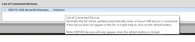

The firmware update went successful, but now RFStudio lists the device as : XDS Device - Unknown,

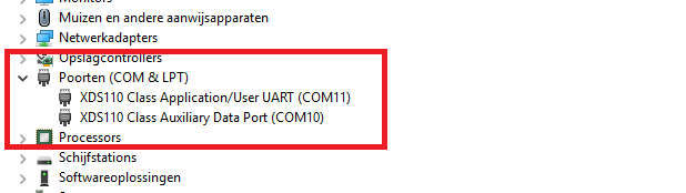

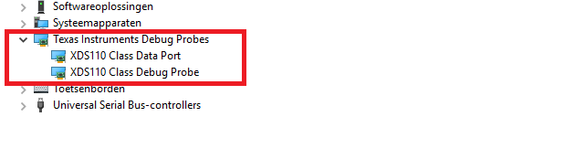

  • Jan,
    1. How does your LAUNCHXL-CC1310 show up in the Windows Device Manager? The expected result is something like this:

  • 1: yes

    The result is the same  in SmartRF studio 7 and other applications. Below how it looks in Smart RF Studio.
    Still not sure what's going on. Does the problem get resolved if you do the steps in 3 with the attached image?https://e2e.ti.com/cfs-file/__key/communityserver-discussions-components-files/156/firmware_5F00_ccs_5F00_8_5F00_2_5F00_0.bin
