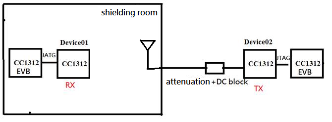

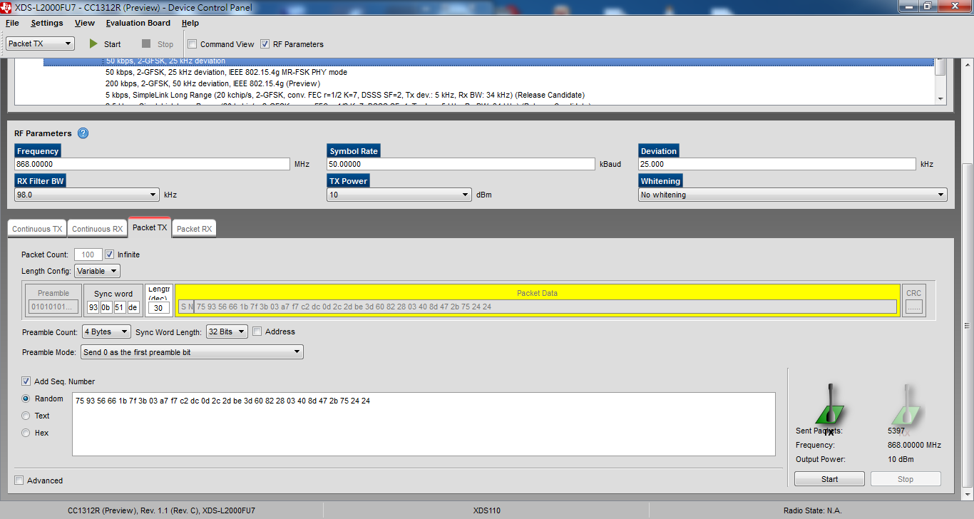

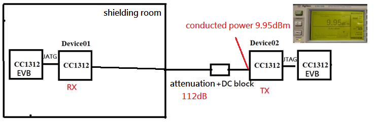

We use TI LAUNCHXL-CC1312R1 EVB board, control my device by JTAG in the shielding room.
see Attached environment setup
device02 TX setup
device01 RX setup

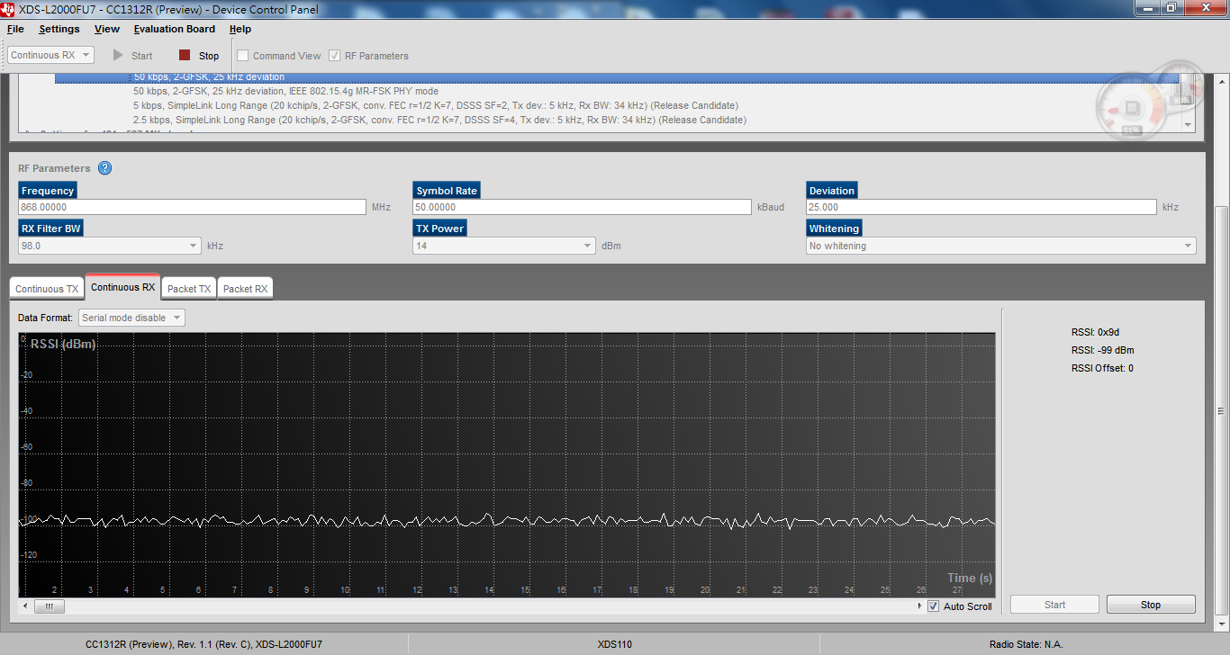

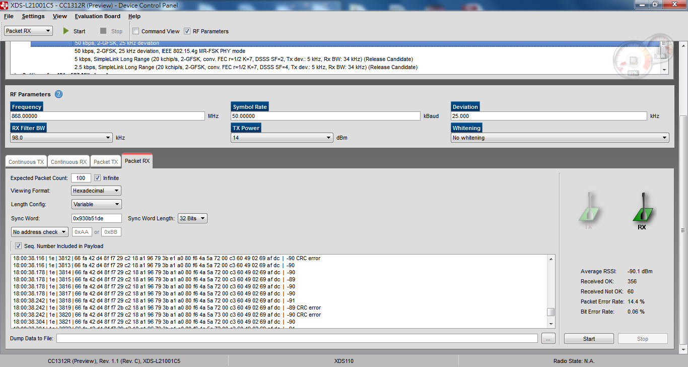

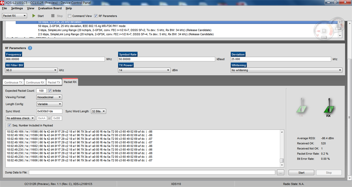

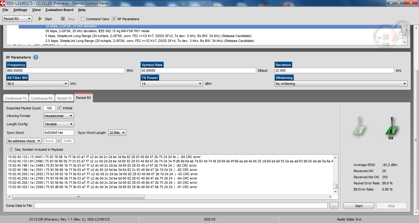

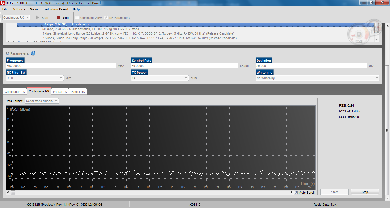

Why received packet's rssi is -93dBm, but CRC error ??

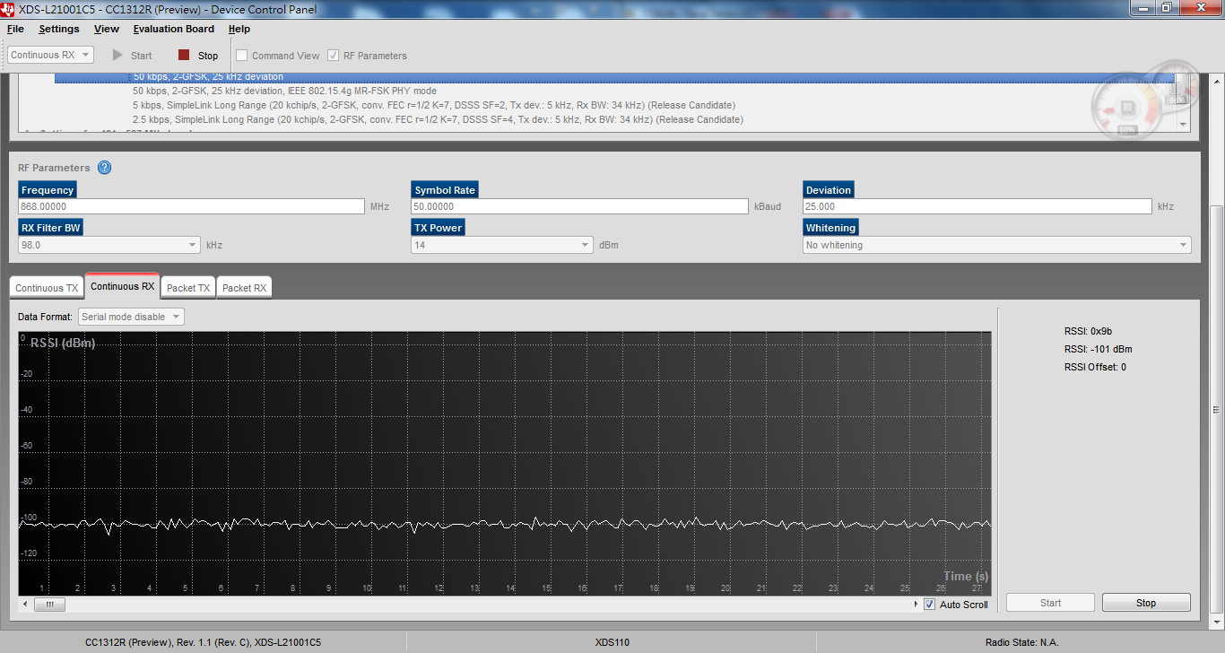

anothor test, device01 power on, Continuous RX RSSI -101dBm see Attached Screenshot.

    - When you measure the RSSI, is the TX device on then and is this inside the shielded box? If this is measured inside the shielded box and any known TX is off then you have a very high power noise source somewhere that impact your measurements.

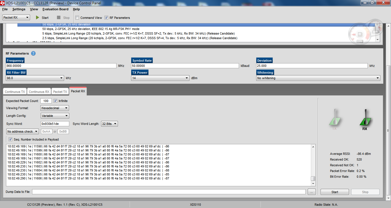

    OK, can communication , but as the attenuator increases, packet error rate increases & show CRC error.
    RSSI: -86.4dBm RX OK.
    RSSI: under -89dBm CRC error

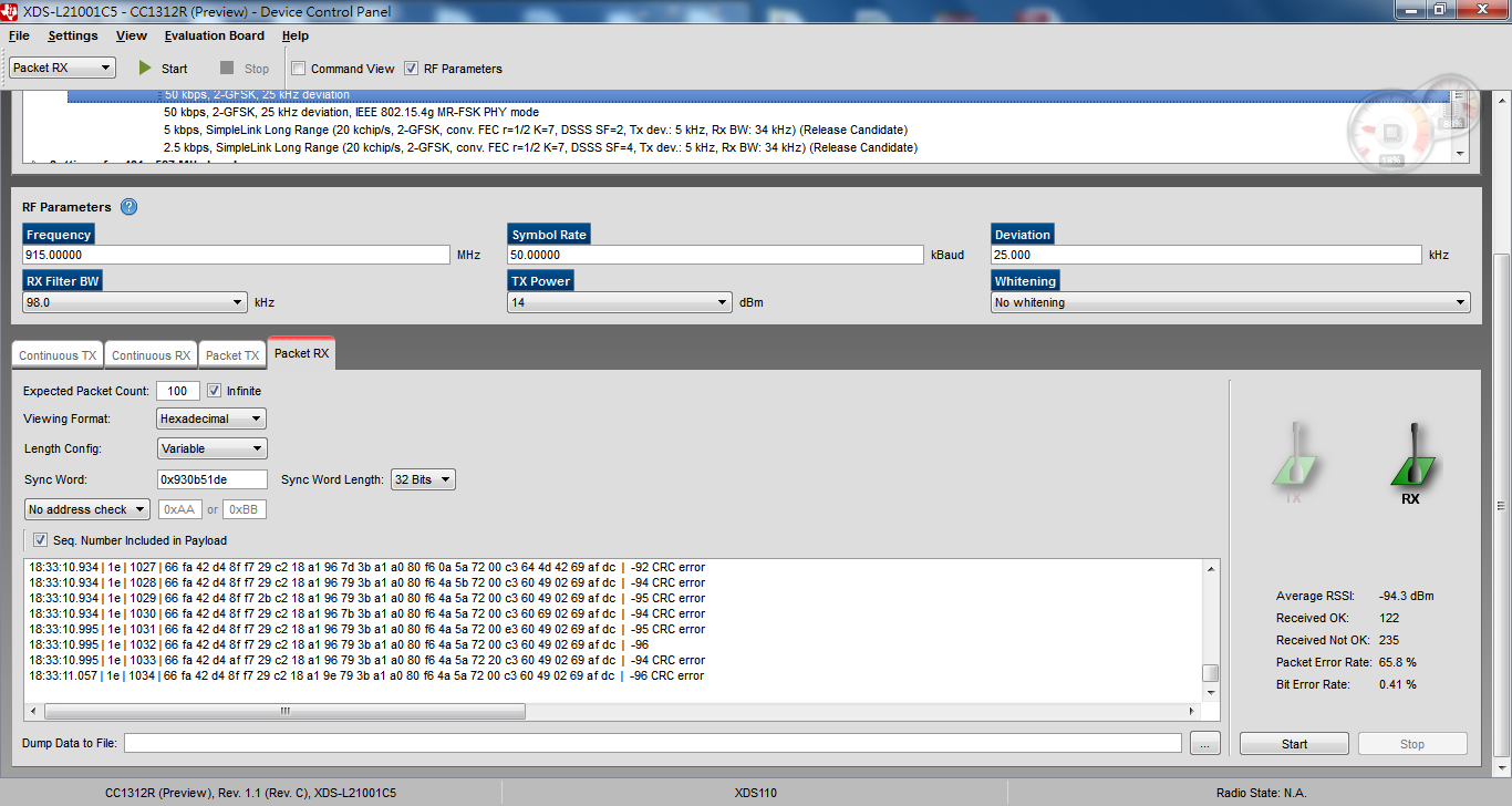

    - Do you get a different result if you change the frequency?
    Use 915M as same.
    TX device no use shielded box.
    RX device measured inside the shielded box and any known TX is off.
    So,Is it possible is in band noise on my device?
  • I measured background noise in the office with a CC1312 launchpad. Since we are in a open office with several apps engineers we normally have a fairly high RF traffic on some frequency band. So what you measure in a shielded room is an unexpected high background noise.

    I measured background noise in the shielded room with a CC1312 launchpad and my device 868M module.
    Difference is as follows:
    CC1312 launchpad noise floor
    My 868M module noise floor
  • Have you done conducted measurements (sensitivity/ output power) before starting radiated testing?
    Please refer to www.ti.com/.../swra603 for debugging.
  • Hi TER,

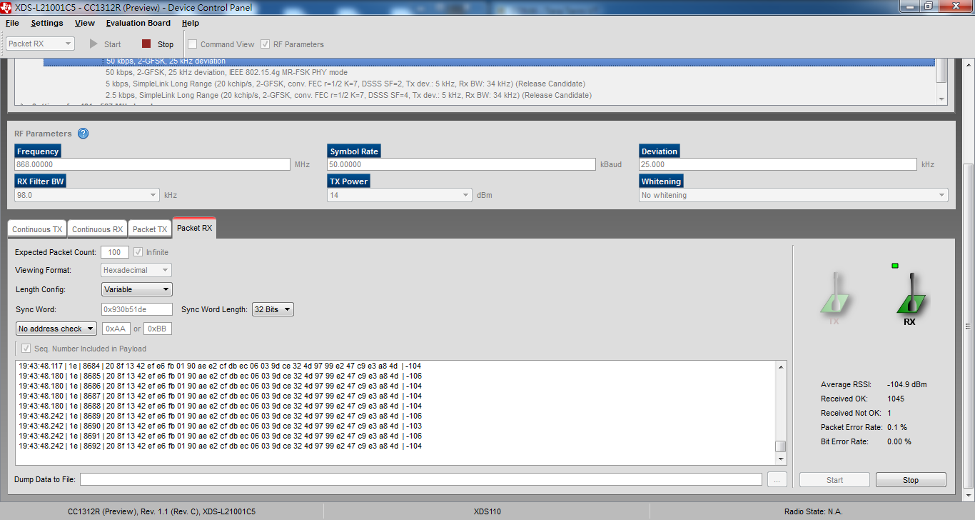

     My test environment, conducted measurements Device02 TX output power 9.95 dBm
    and Device01 Rx sensitivity, RSSI -104.9 dBm.
    Measurements RX sensitivity
    conducted : RSSI -104.9dBm no CRC error.
    Air : RSSI  under -89dBm CRC error
    Any suggestions? Thanks you.

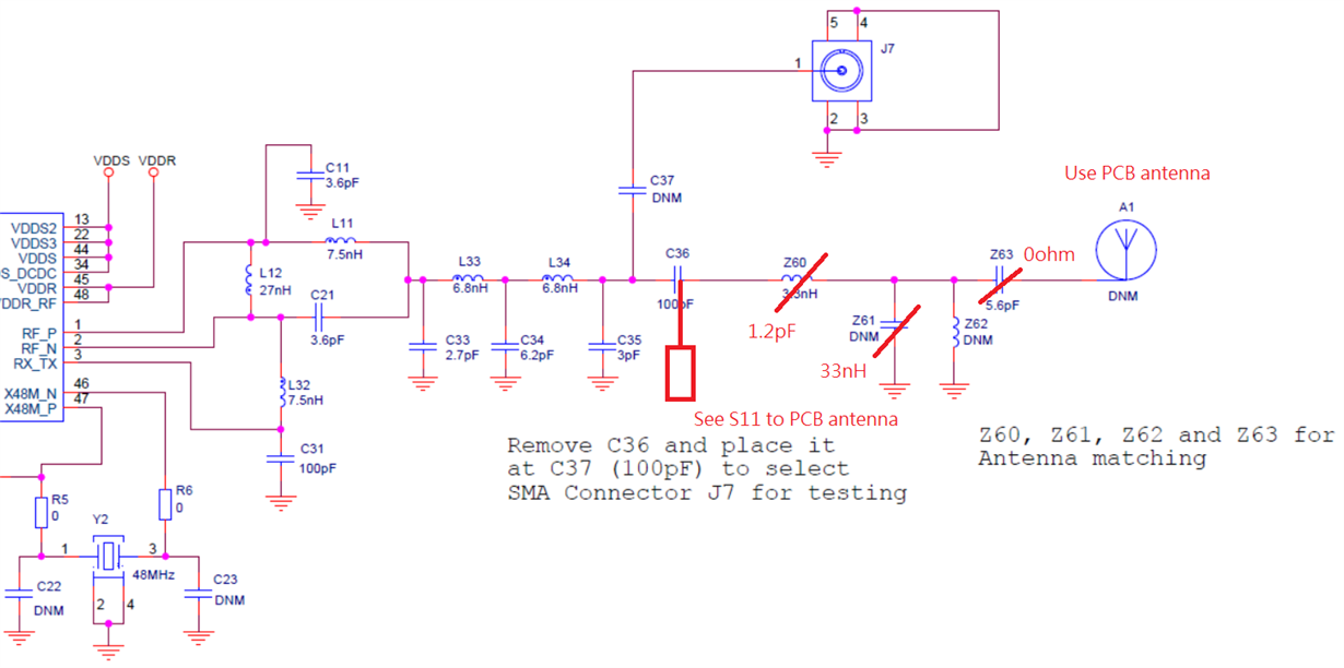

  • Ok, this indicate the the conducted performance is close to expected.
    What antenna is device01 using and is this antenna tuned?
  • Hi TER,
    Device01 use PCB antenna.
    This antenna tuned S11 & circuit.

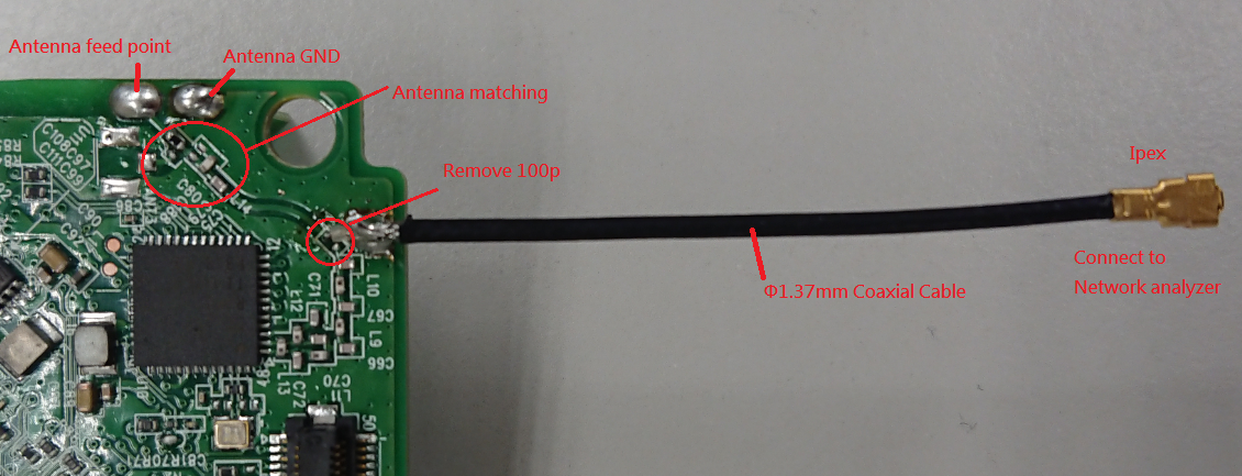

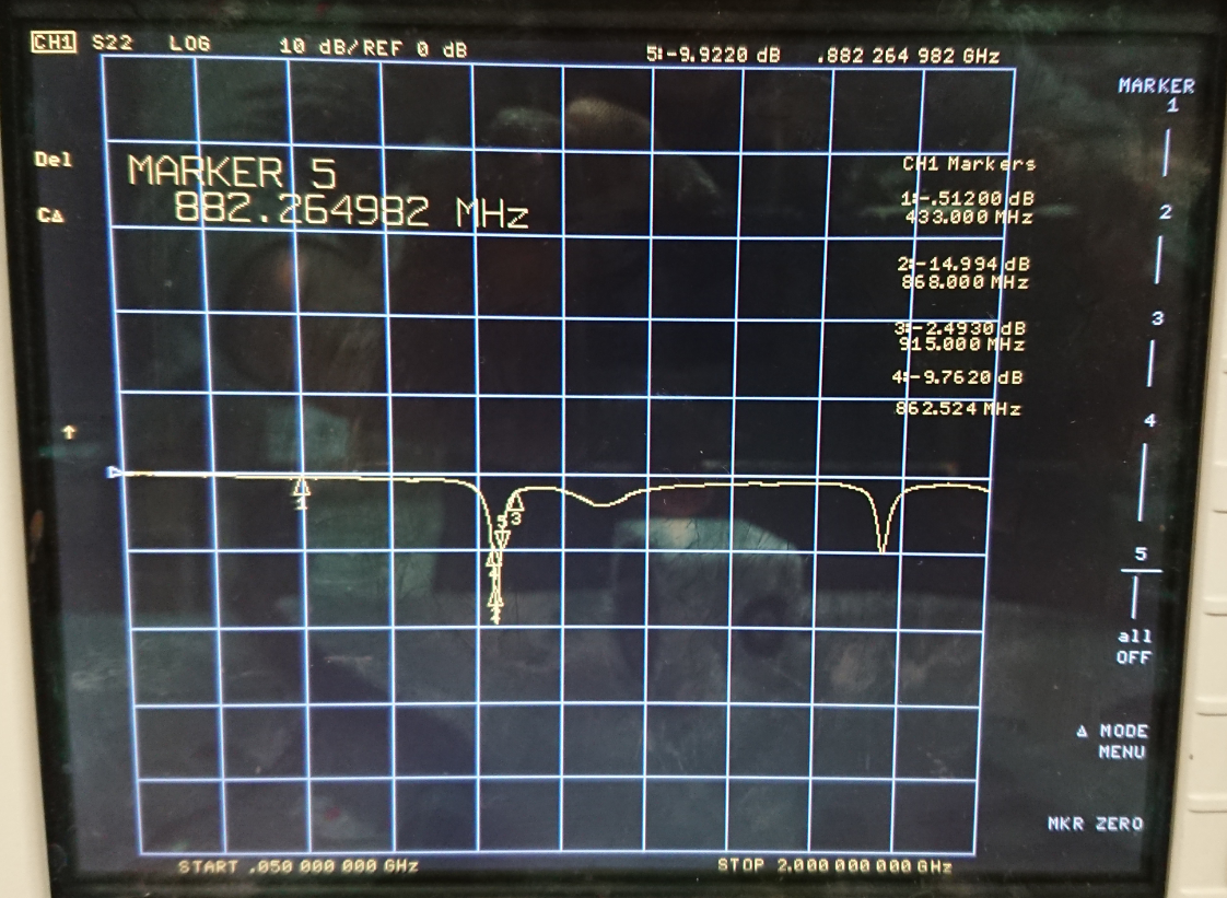

    Circuit, remove C36, look the antenna of S11

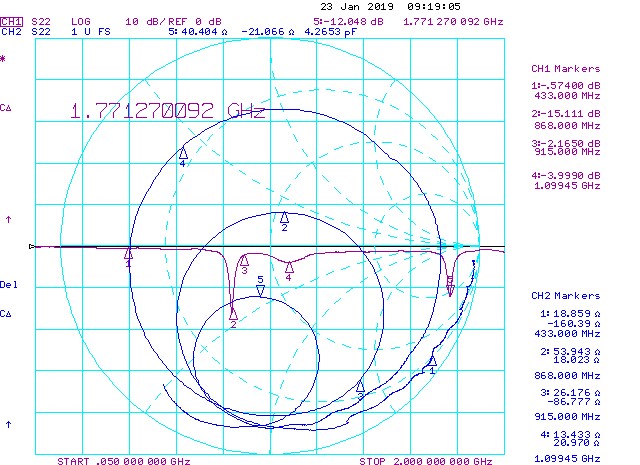

    S11, Marker2  -14.9dBm  at -14.9dB
    Thanks for your help.
  • What is the impedance and VSWR @868 MHz?
    Do you have a picture showing how/ where you soldered on the semirigid cable used for the tuning? Could something in the test setup detune the antenna?
    From the results it looks like the tuning is off.
    Marker2@868M, S11 and smith chart
    Can you give an example?

  • The measurements show that the antenna is tuned at 868 MHz.
    Have you done the same measurements whilst the PCB is in the final casing/housing which possibly could de-tune the antenna.
