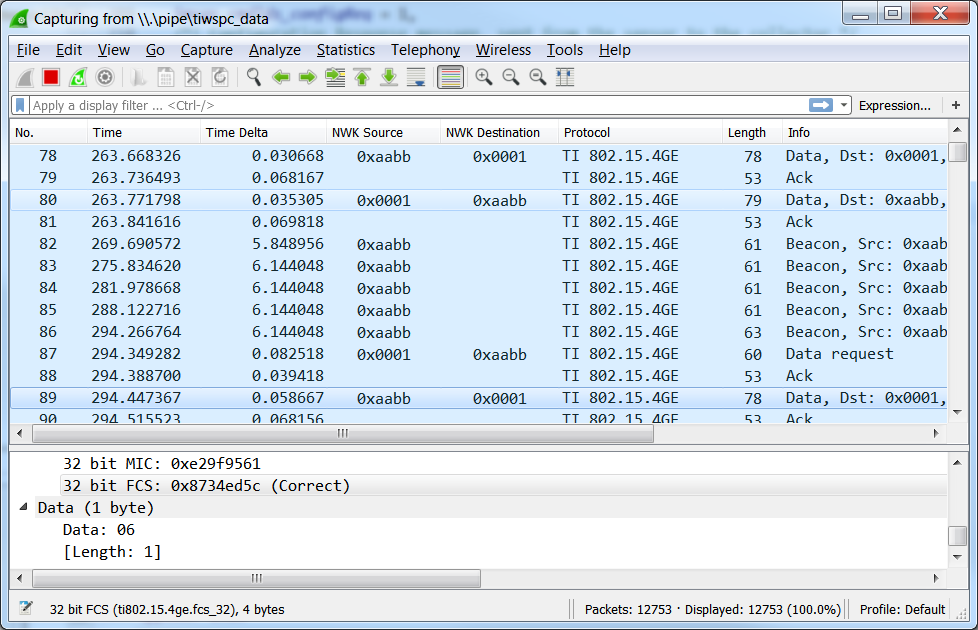

  • Are you able to see in wireshark the over the air packets that your devices are sending?
    If your wireshark is capturing packets you should see something like this image below

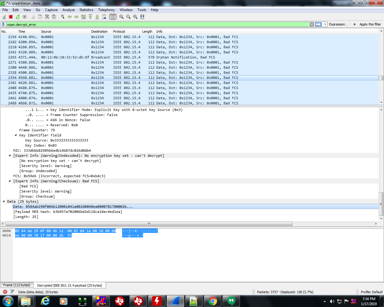

  •  Hello Hector,
    yes! I can see this in my window but where do i see the decrypted packets?
  • It looks like your wireshark is using the wrong dissector for parsing the packets. under protocol it should show TI 802.15.4GE and not IEEE 802.15.4 as it is showing in your capture.

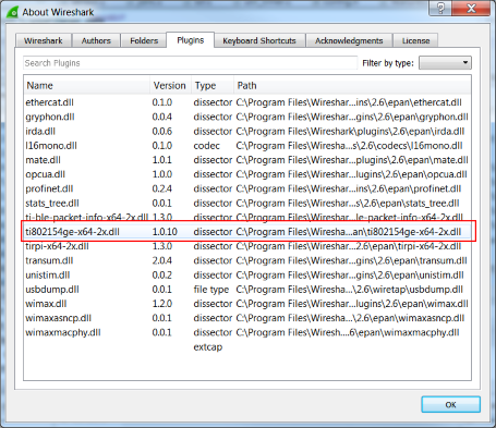

    some of the things that you can take a look are:
    - make sure you are running the correct version of the packet sniffer 2
    - make sure you are running the correct version of wireshark
    - make sure the packet sniffer 2 plugins are installed correctly in your wireshark(see image below)
    Also, your issue seems similar to this other E2E thread https://e2e.ti.com/support/wireless-connectivity/sub-1-ghz/f/156/p/748170/2765398#2765398
    take a look at it and see if the same fix works for you
