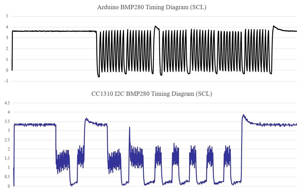

    After using scope, I found out that slaveaddress isn't work in 0x77.
    I change the slaveaddress to 0x76 and i2c_transfer() is work.
    But the waveform aren't the same as when I connect the sensor to Arduino.
    The picture below is bmp280 connect to arduino and CC1310.
    The two picture waveform aren't the same.
    The SCL part is pretty different between two of them.
    How should I do?
    Anything suggest?

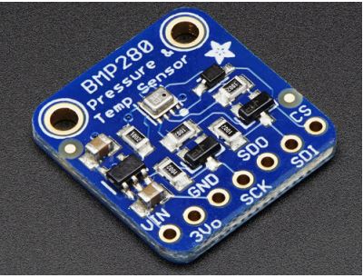

  • This board is from adafruit with a regulator, some 5 V <-> 3.3 V conversion. From what I see from the schematic for this board the pin row row is on the 5 V domain. Have you review the schematic and checked how the extra components on the board impact the communication?
  • Thank for you reply.

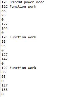

    I read the Bmp280 datasheet again and found out that getting the sensor data needs to i2c write function first.
    I added the code like below picture and I caught the data from sensor succeed.

    The data I caught from bmp280.

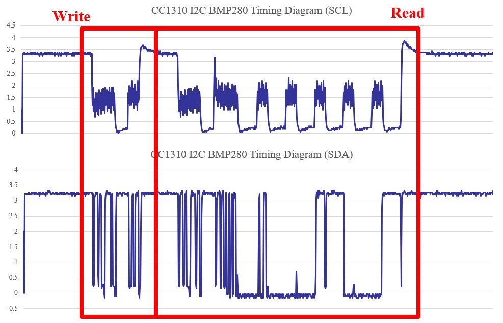

    The bmp280 timing diagram on cc1310.
    The timing diagram of arduino and cc1310.
  • As far as I can see you are not addressing my question:
    "This board is from adafruit with a regulator, some 5 V <-> 3.3 V conversion. From what I see from the schematic for this board the pin row row is on the 5 V domain. Have you review the schematic and checked how the extra components on the board impact the communication?"
    Before starting to look into the software you have to fully understand the hardware.
