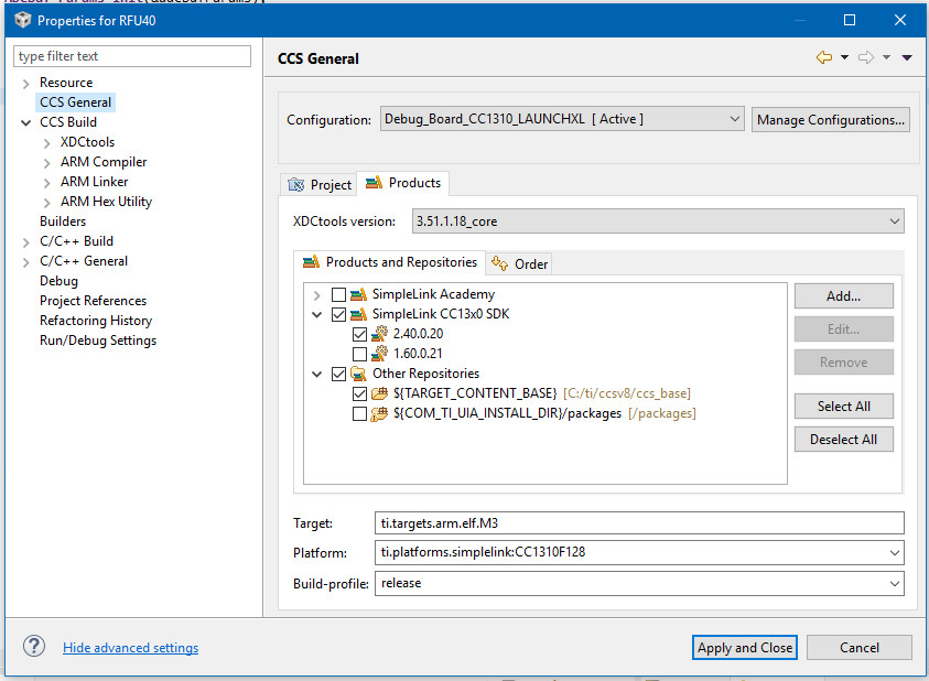

I have made the application in the CCS v 7.4 with the simplelink_cc13x0_sdk_1_60_00_21. Everything works well.
I installed the CCS v 8.3 last Friday (because the Resource explorer does not work in CCS v 7.4) and I also installed the newest Simplelink SDK, simplelink_cc13x0_sdk_2_40_00_20.
I made some changes in my board file according to the new version of the LAUNCHXL-CC1310 examples - some structures were changed. I am able to compile the project with ARM compiler v 18.12.0 LTS without any errors.
But when I run the application in the MCU (debug session), the application suddenly stops on ADCBuf_open().
If I compile the same project with the ARM compiler v 16.9.10 LTS, everything works fine.
Do you have any advice what could be the problem with migrating the project from Simplelink 1.60.00.21+ARM 16.9.10 to Simplelink 2.40.00.20+ARM 18.12.0?

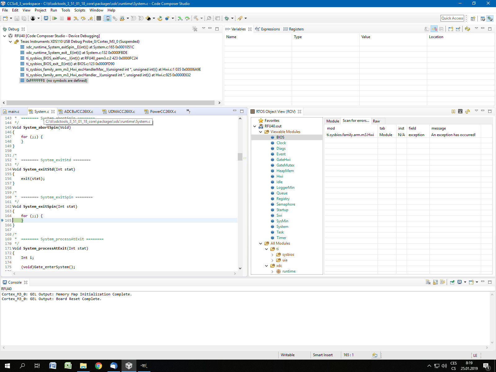

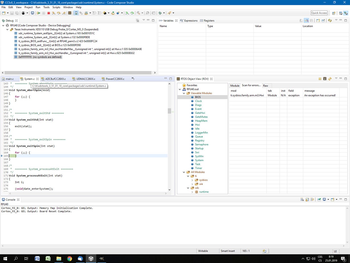

  • I paused the debugging when the application stops working and you can see the state on the printscreen below (cc1310_debug1.jpg). The application stays in System_abortSpin(), an exception is reported by BIOS module.
    I tried to "Step in" to investigate the part generating the exception and I ended in the ADCBufCC26xx.c, ADCBufCC26XX_open() and the row object->udmaHandle = UDMACC26XX_open();
    If I "Run" the application from that point the same state and exception as is in the stated printscreen occurred.
    If I try to "Step in" the UDMACC26XX_open() function I can do it. But the behavior of the debug session is "odd". I mean that when I press the Step in button, the selected (actual) row in the c file suddenly changes some rows up or sometimes down etc. It looks like the compiled and currently running code can not be matched with the C source code.
    In my opinion, every attempt to "Step over" or "Run to line" etc. of any function call in the UDMACC26XX_open() will end up in the "exception state".

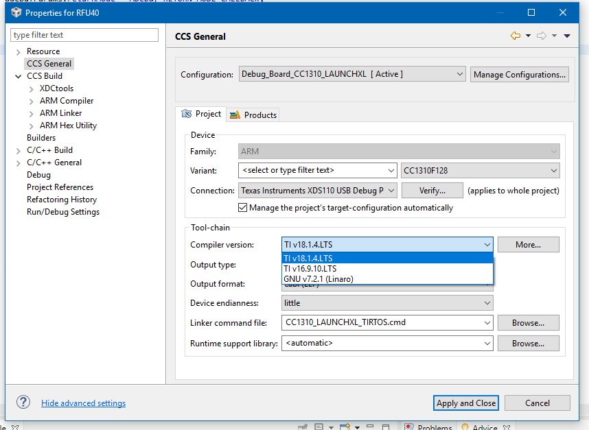

  • Hi TER,
    I have just tested your suggestion - I copied the board files from the simplelink_cc13x0_sdk_2_40_00_20 and modified only PIN configuration (GPIO PIN table) and the behaviour of the application is still the same. It means the same state as I described in my last post.
    If I only switch the compiler version to ARM 16.9.10, everything works fine.
    What would you suggest?

  • Is it possible for you to make a project that runs on the launchpad that shows this issue?
  • I have just modified my project to work on CC1310LaunchPad. I removed all code not related to ADC0 measurement to simplify the example.
    The code only measures the voltage on ADC0 every 3 seconds and turns Green LED ON if the voltage is higher than 3,0 V.
    The problem is still presented - if I compile the project with ARM Compiler version 18 and higher, the code stops working on ADCBuf_open(). If I compile the project with version 16.x everything works fine.
    I hope that the example will help you to find out the problem.
    Marek
    rfu40_sample_project.zip

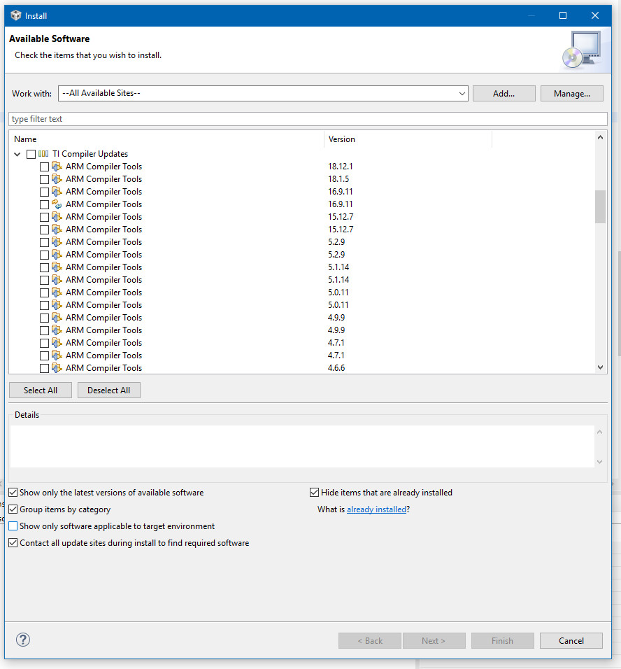

  • I don't have compiler versions in my head. Hence I found out now that if I install the newest version of CCS and update to have the newest versions of compilers etc I get 18.1.5.LTS. ( I discovered this when trying to import your project).
    The SDK is tested with 18.1.4.LTS. How did you end up using version 18.12?
  • You are definitely right. That was my fault - I searched the newest compiler version by Help-Install New Software and I had the "Show only software applicable to target environment" unchecked, as you can see below.
    I can see the same behaviour (ADC_Open() problem) with 18.1.4 LTS version.

  • Not sure if I understand you. With the attached project it still fails to import due to the reference to 18.12. Since the import fails I'm not able to change any settings.
    In your project properties->general Compiler version pointing to either 18.1.4 or 18.1.5?
    If you are actually doing a File->export, could you try to just zip the project folder?
    Normally I would have just taken the files into an empty project and started from there but since this issue is depending on project settings I want to be sure that I run on exactly the same as you.
  • I agree, we did not understand each other. But now it is clear for me: "Your" import fails and "my" does not. I am able to import the archived project into the clear workspace. I get the error message (compiler version issue) after the project is added and I can change the compiler version in the project properties.
    The compiler version is pointing to 18.1.4 LTS in my project properties. I do not have 18.1.5 installed.

  • Could you show the CCS general -> Products settings to to see which version etc the project are linking to?
    I note that the project has a RFU40.cfg. Normally the .cfg file is placed together with the tirtos_builds_CC1310_LAUNCHXL_release_ccs project and that this is used. Why a separate .cfg file?
  • I don´t know why the separate cfg file. The project had been created in the TI-RTOS SDK, maybe 2 years ago, I don´t remember the version. Then it was migrated to SimpleLink SDK...the cfg file for static configuration of the TI-RTOS was in the example project - I think it was the uartecho project I started on.
  • I got some issues with trying to have two .cfg files in the project. Is it possible to include the tasks and semaphore setup used in the .cfg file directly in the code enabling the removal of RFU40.cfg
