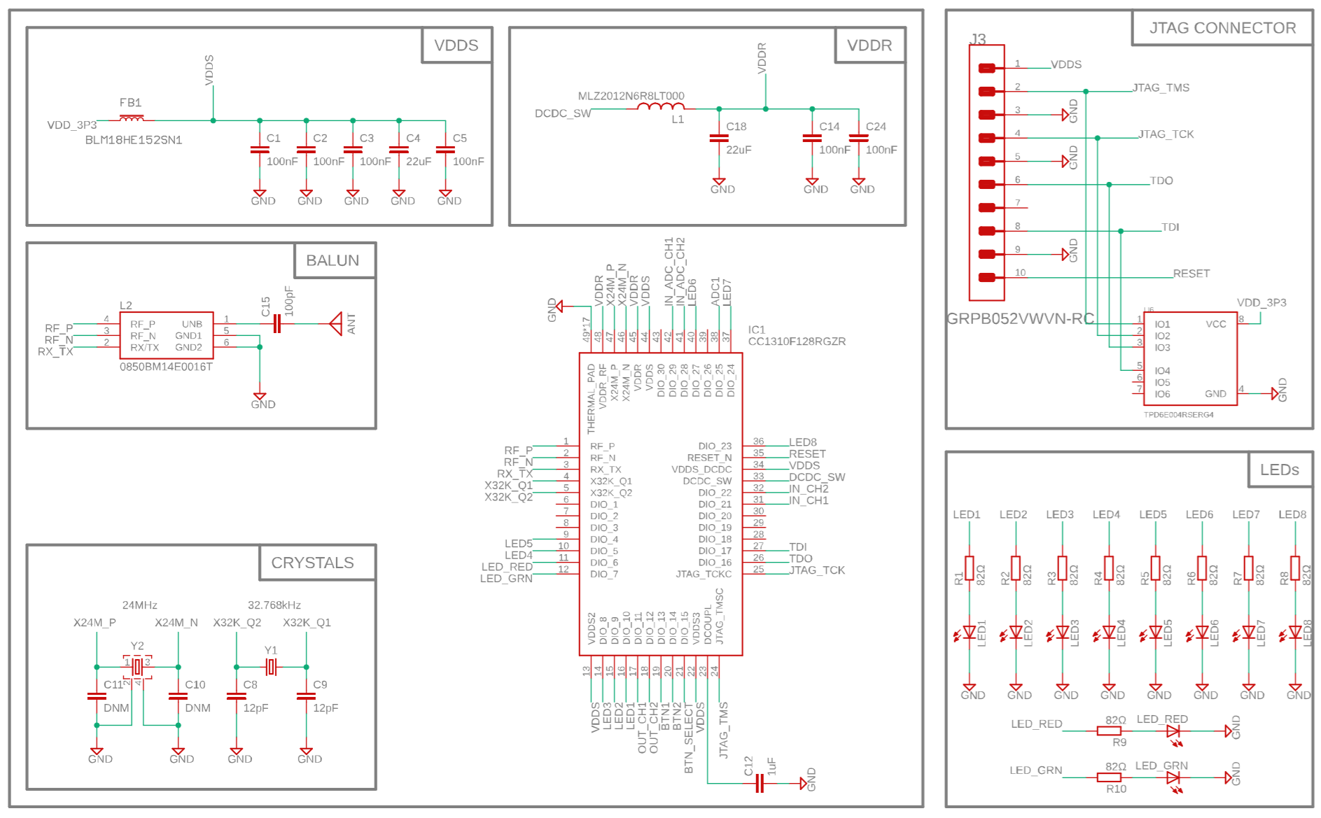

The sensor board uses external regulator mode and the coordinator DC/DC converter mode.

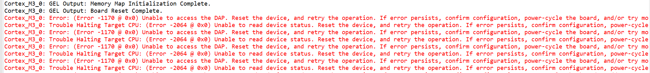

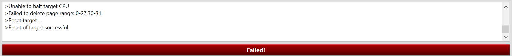

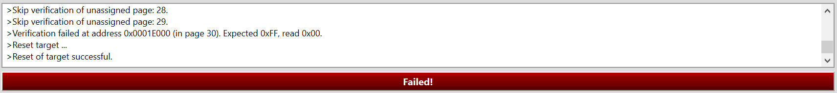

In the coordinator board only welded the CC1310 schematic part. The board is detected by the SmartRF Flash Programmer 2 and can be programmed, but after programming the board stop working and if I try to program again the board give the following error:
To resolve this problem and can program the board again I need to do a Forced Mass Erase.

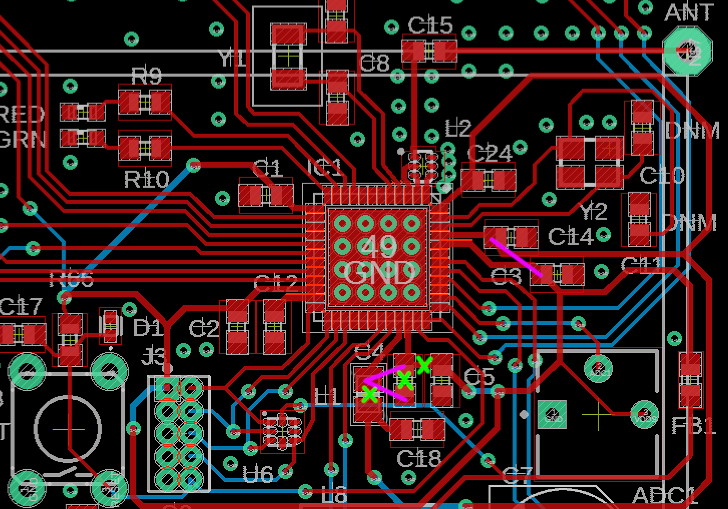

I supply the board from an external supply at 3.3V. The VDDR is at 1.66V.
If I change the board to use the external regulator mode works fine so the problem is in the internal DC/DC converter.
Schematic:
Any idea why this happens?
