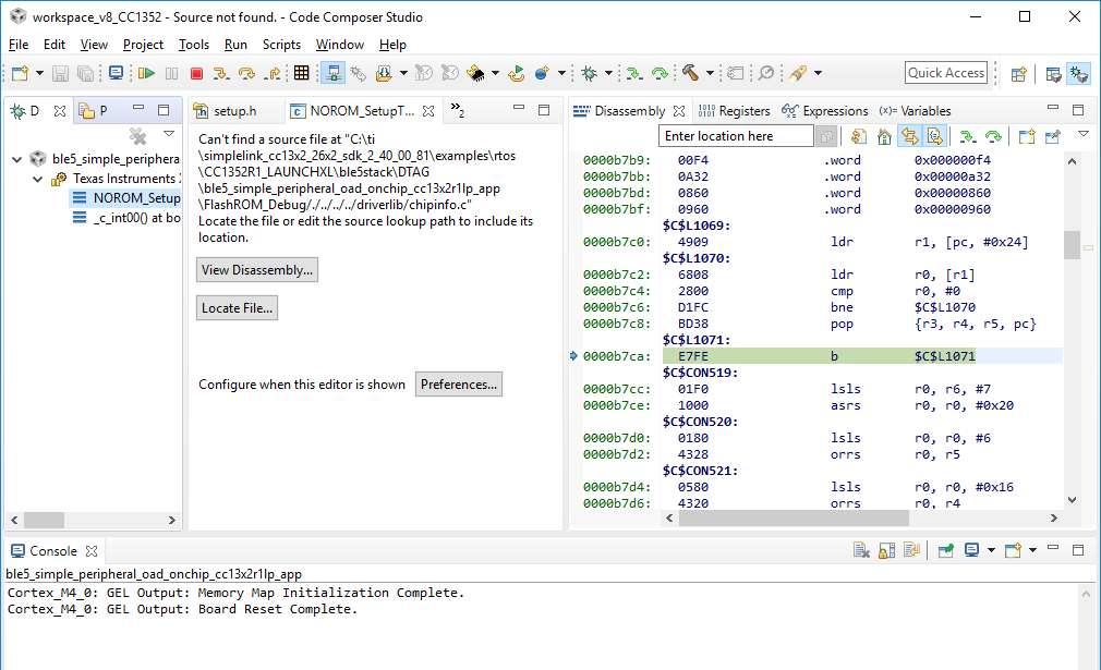

I try to get my own CC1352R1 PCB up and running. I have a PCB with the CC1352R1F3RGZ and some sensors etc mounted.
I used examples\rtos\CC1352R1_LAUNCHXL\ble5stack\simple_peripheral_oad_onchip as a start project and try to run this on my device.
I can connect to the device with XDS100-v3 and are able to flash with SmartRF Flash Programmer and CCS, but the firmware won't start.
In debugger, right after starting a debug session I end up with this state:
So I assume there is a misfit from firmware to chip.

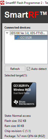

In SmartRF Programmer, the chip is identified as:
What is the expected chip for this firmware? What would be a good starting point for my hardware?
