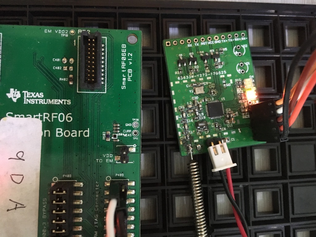

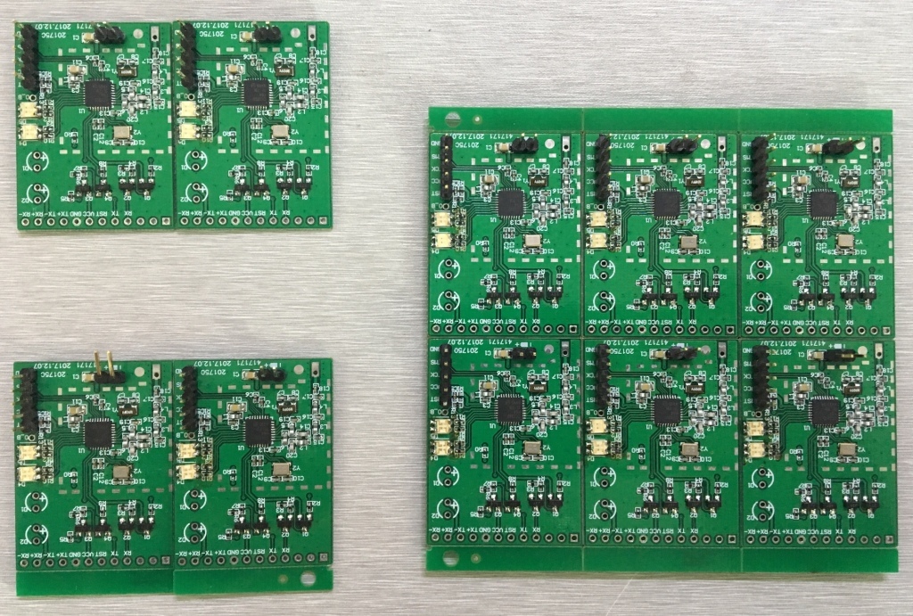

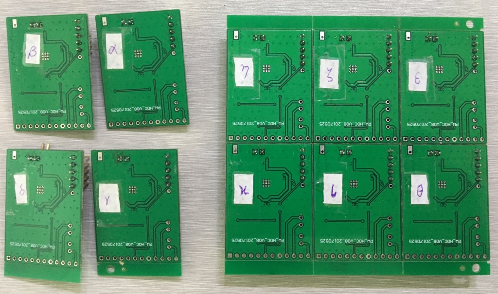

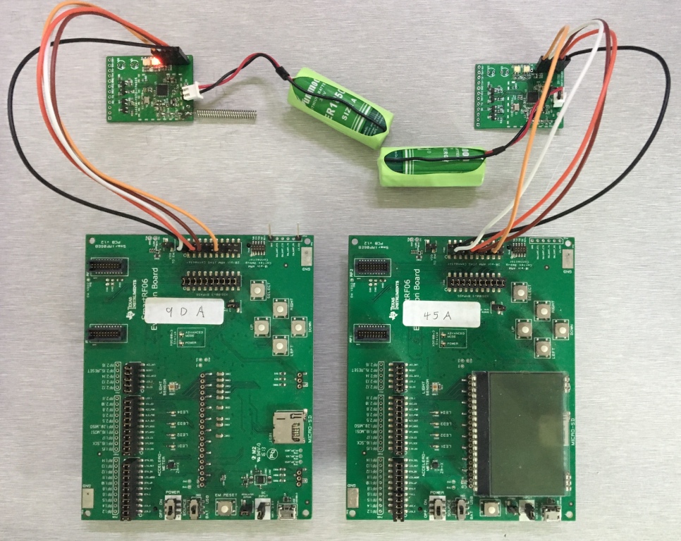

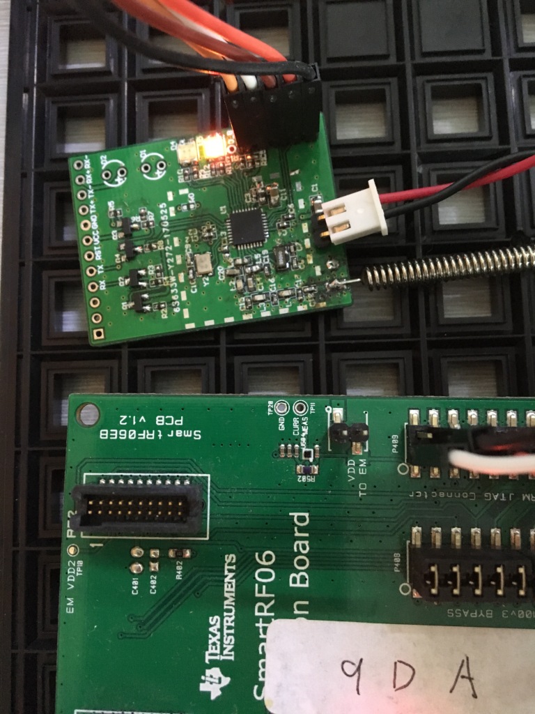

There are ten new targets and an old target with an antenna, which are customed boards with CC1310F64(IC revisions is B(2.1)).

I made a compare test with a new target (I altered the new target from the others, did it nine times, got same results) and the old target. The procedure includes six steps as below.
1)I debug my project in the old target by CCS. My program runs well, such as lighting some LEDs.
2)When I debug my project in the chosen new target, a message is indicated as "Cortex_M3_0: Can't Run Target CPU: (Error -2134 @ 0x0) Unable to control device execution state. Reset the device, and retry the operation. If error persists, confirm configuration, power-cycle the board, and/or try more reliable JTAG settings (e.g. lower TCLK). (Emulation package 8.0.903.2) Cortex_M3_0: JTAG Communication Error: (Error -1170 @ 0x0) Unable to access the DAP. Reset the device, and retry the operation. If error persists, confirm configuration, power-cycle the board, and/or try more reliable JTAG settings (e.g. lower TCLK). (Emulation package 8.0.903.2)". In this moment, I still can connect CS_DAP_0, IcePick_C and Cortex_M3_0 to target. The respective registers could be exported to a file.

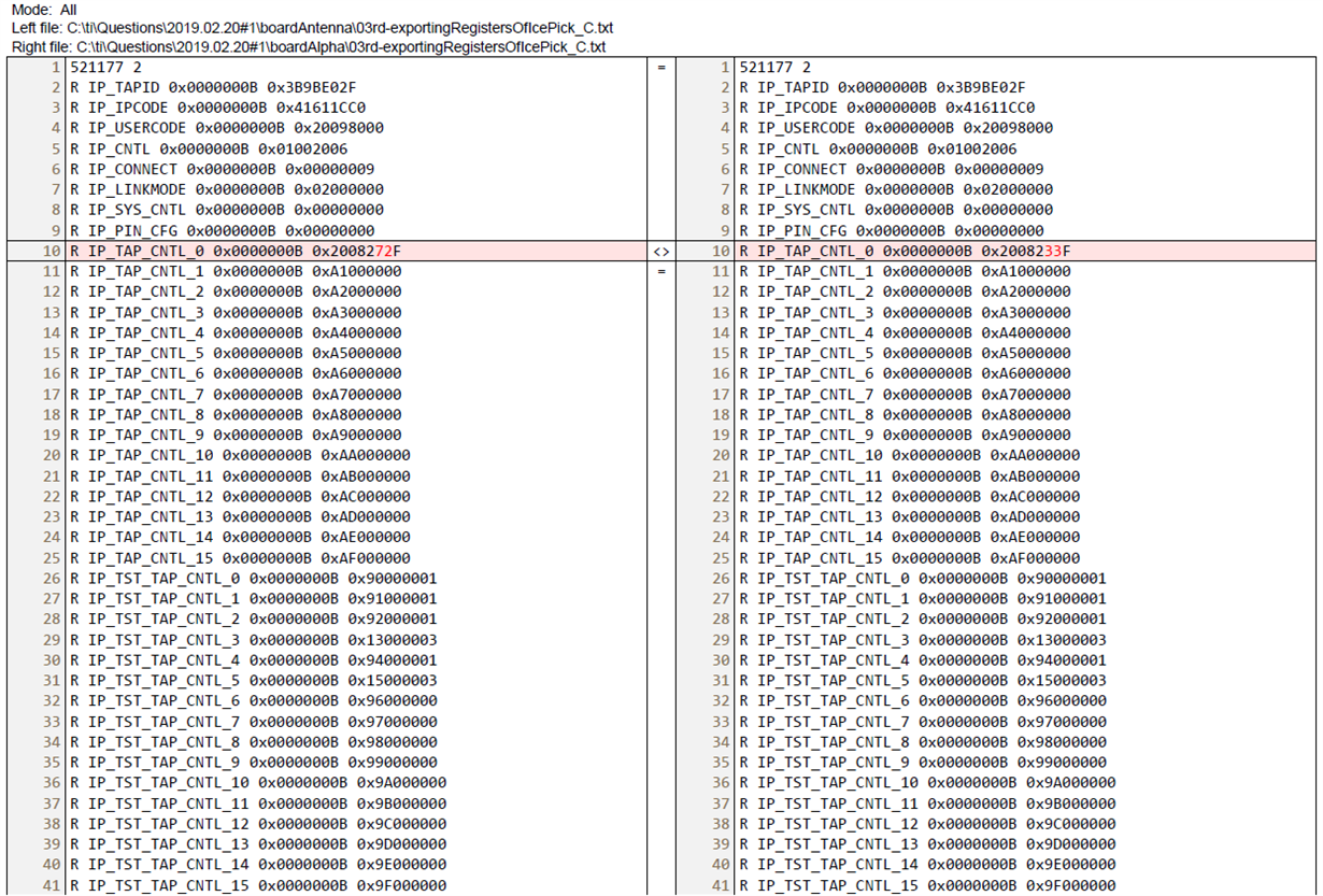

5)I export register of Cortex_M3_0 of both targets to a file. Then I compare the files respective. The differences of reading from registers are shown as below. Is this the cause or consequence of my issue of failing to debug the new targets ?
6)I export register of IcePick_C of both targets to a file. Then I compare the files respective. The differences of reading from registers are shown as below. Does this contribute the issue ?

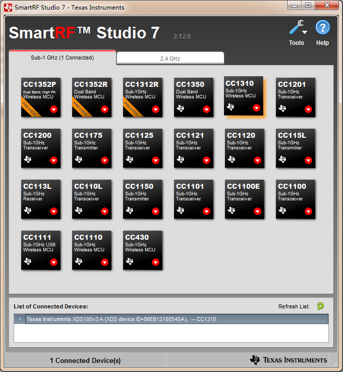

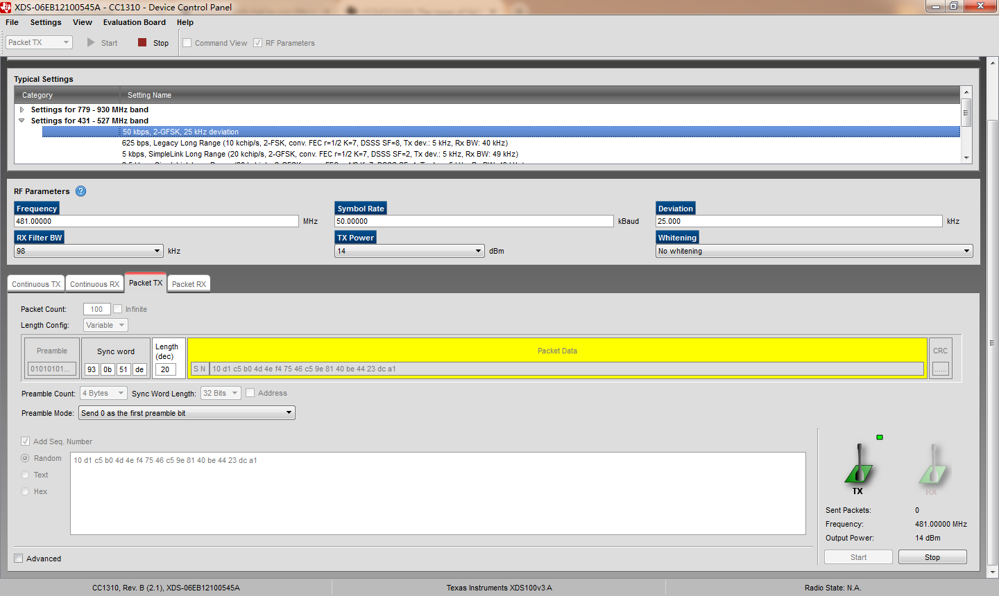

    - Does the "new" version board work if you connect it to SmartRF Studio?

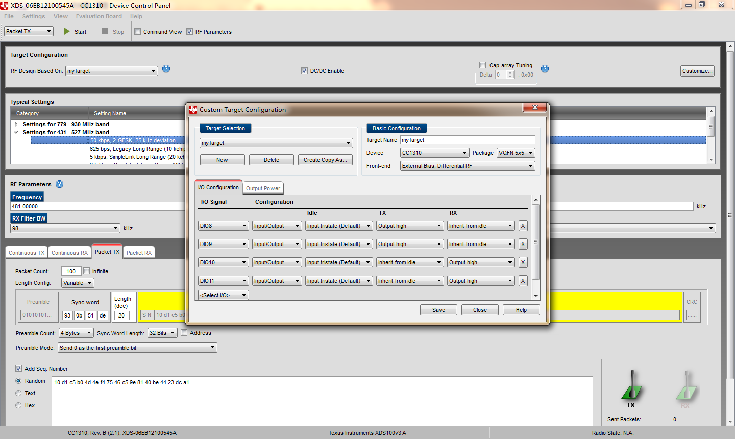

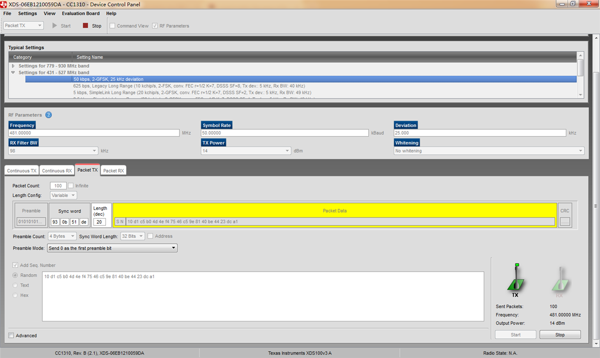

    The new version does not work in SmartRF Studio,  but is detected. The counter of packets is frozen at ZERO during Tx. The configurable LEDs are not lighted either.
    The old version works well. The respective couter increased. And the LEDs are lighted.

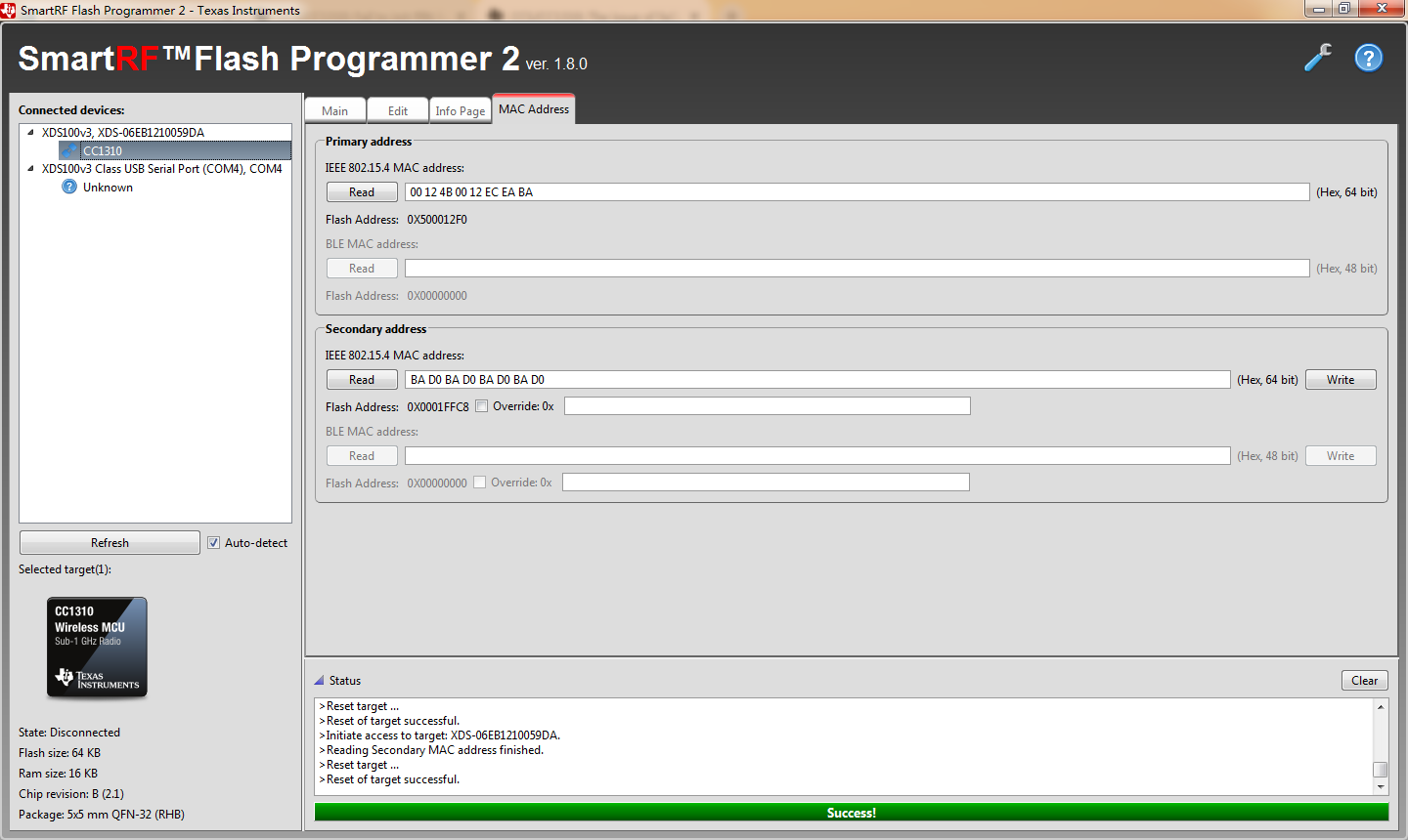

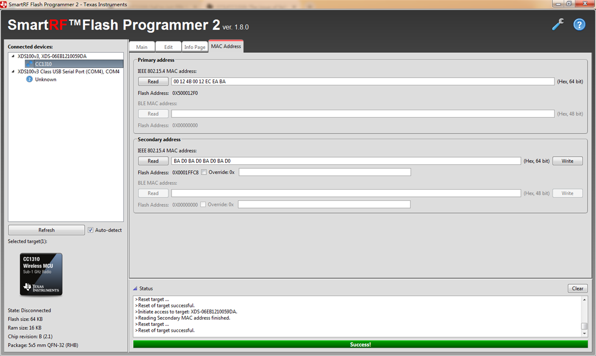

    - Have you double checked by using Flash Programmer 2 that the "old" version uses F64?
    Yes, I've checked the "old" version is F64 by Flash Programmer 2 throught XDS100V3 (SN:0x0059D). The primary IEEE 802.15.4 MAC address is read as "00 12 4B 00 12 EC EA BA".
    I've also checked the "new" version is F64 by Flash Programmer 2 throught XDS100V3 (SN:0x00545). The primary IEEE 802.15.4 MAC address is read as "00 12 4B 00 12 EC 3B 37".

    For the new one, the registers of Cortex_M3_0 and CS_DAP_0 are identical. But the registers of IcePick_C changed as below.
    Because the major difference of Cortex_M3_0's registers before removing C9 and C10 are AUX_DDI0_OSC and AUX_SMPH, I suspect 24M crystal oscillator does not work. Might it be worthy to add a resistor to check it ?
