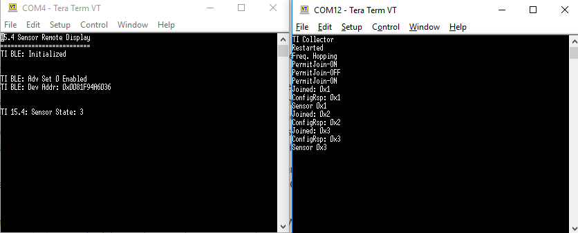

I have a couple of doubts regarding DMM (board - CC1352R) –
1)  I tried the DMM 15.4 Remote Display example with 15.4 Collector (both in Freq Hopping mode). The node was configured as “0x1”(as seen on the Collector’s terminal). It started reporting, the problem occurred after I disconnected and tried to reconnect the DMM node using the mobile app (by writing 0xDD and 0xAA for disassociation and association respectively). The node configures as “0x2” after it re-joins. This happens as many times I do the disassociation and association through the app/button press. (eg, the next time the node joins as 0x3).
Is this what is supposed to happen? If no, then what makes it change the short address?
And, if this is the way it should behave, what changes will I have to make so that the node doesn’t change its address every time it reconnects.

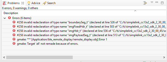

2)  I tried the portable example in BLE5Stack from the link below,
http://dev.ti.com/tirex/content/simplelink_academy_cc26x2sdk_2_10_02_10/modules/ble5stack/ble_enhanced_oad/ble_enhanced_oad.html
It is explained how we can port the OAD functionality from project_zero to multi_role project. I tried the same steps using DMM instead of multi_role project, and it didn’t work.
So is it even possible to follow that steps in DMM 15.4 Remote Display, and will it work?
If yes, please take a look at the following screenshot, and tell me where I went wrong.

  • Hi Yash,
    I will ask a TI 15.4 expert to get back to you on the sensor/collector part of your question, in the mean while, which SDK version are you using?
    Regarding OAD, we don't have any DMM examples featuring OAD as of today, but I would expect this to be possible. As for the steps to do this, I would assume the guide to be sufficient. The error message suggest you already have theses variables declared at some point in your application, I would try to identify where and why as a starting point.
  • Hello M-W,
    Thanks for replying.
    I'm using SImpleLink SDK 2.30.00.45.
    And regarding OAD, Thanks for your suggestion I was able to solve that error. But a new error occurs error saying - "unresolved symbol __cfg, first referenced in whole program".
    And I think i figured out the reason for that. The link i was following asked to delete the "ccfg_app_ble.c" file (under Startup folder). But as soon as i delete it and build the program again i encounter the aforementioned error.
    I tried keeping that file, and it builds successfully but it behaves in a strange manner. the first time i see what i am supposed to see on the DMM terminal and after configuration it starts sending data to the Collector. But when i press the reset button, the terminal displays the UI which was mentioned in the project_zero example, and the senor stops sending data.
    So my question is, how can i make the DMM and OAD work together? Is this behaviour because of the "ccfg_app_ble.c" file I didn't delete or is it something else?

    Following are the updates since my last message.
    Firstly, the project_zero code was running after reset because the BIM was loading the image after Reset. After i flashed the erase_storage_offchip file, that didn't happen again.So I guess that problem is now solved.
    Secondly, while going through the BLE user guide and the Simplelink Academy tutorial I saw the following statements-
    "As of BLE5-Stack 1.00.00 BIM is always linked to page 31 of internal flash, and will always link the CCFG section with it. Thus the OAD application will not need its own CCFG. "
    and
    “The BIM is responsible for linking and defining the CCFG structure, instead of the application as in the non OAD case. This ensures that the device always will always execute the BIM after boot.”
    So it is sort of a given that we can’t keep both ccfg_app_ble.c file (under the Startup Folder in the project) and use the BIM at the same time. Now to use BIM, I will have to delete the ccfg_app_ble.c file (as BIM links the CCFG file itself)
    Is the above understanding correct? If yes, then coming back to my question again, what changes will I have to make to remove this error,
    P.S- Just a reminder, the very first question I asked still persists- "The Sensor/collector address part".
    Yash.
  • Hi Yash,
    As of today, we have not yet provided "OAD enabled" DMM examples, and I would assume the current examples to be designed as a "OAD applications". I'm not able to give you exact pointers on what you have to do to solve this error, but searching your project for the symbol could be a start.
  • Regarding the new address being assigned after disassociating and associating the device again. This is expected behavior since this device has been deleted on the collector side and the collector does not re use short addresses that have been assigned in the past. Also, since it has been deleted on the collectors side the collector has no record of this device being part of the network previously and it has no record of its previous short address which makes it to assign a new short address to it.

  • Hello Hector,
    Thank you for responding and sorry for my late reply.
    I'm confused,
    As you said "The device has been deleted on the collector side and it has no record of this device being part of the network previously ", shouldn't the short address allocated also be deleted and the shouldn't the collector assume the device as a new device and assign the address 0x01 again?
    Assuming my understanding is wrong and the collector won't use the same address again, Is there any workaround for this? any way to stop it from reassigning new address and making it remember the last device address (basically reusing the short address)?
    Thanks and Regards,
    Yash.
  • Hi Yash,
    Keeping each previous disassociated device would eat up memory, once disassociated the collector will not assume it will return again (in contrast to the sensor being orphan, where it remembers the sensor).
    To do what you want, you would have to keep it from deleting the record of the device which I'm not sure is supported. Hector is unfortunately on vacation and will not be able to get back with an answer soon.
