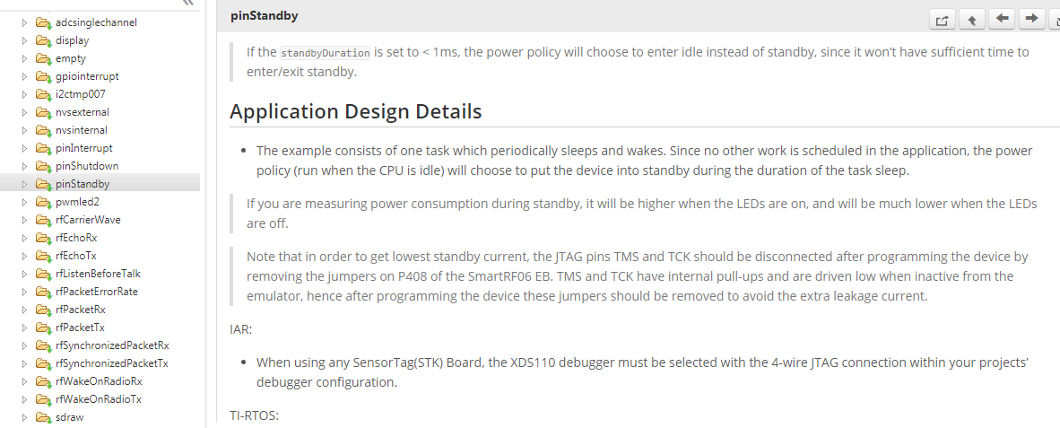

  • Hi
    For the standby mode , i have refer your example code pin standby , and i simply use your code on my cc1310  custom board , after programming i have removed  all the unnecessary connectors ,
    in active state my board current is 380mA and in standby mode the current is still 380mA , whats makes difference between active mode and standby mode. i have also used with board but still the result is same.
    and In example code mentioned that,please see below picture of example code.
    so from the below image and whatever result that i got , is it right call the sleep () when we want go into standby mode.please correct me.
  • 380mA is way too much. There must be current leakage from your IO pins.

  •   Hi,
    i have just checked your example code pin standby with your development board. i flash the code into LP and after flashing i removed the all the Debugger connector and Disconnect the power supply and Gives  the 3.3 volt directly to the controller.
    i have set the standby mode time 10 sec to stay in standby mode. in that mode i am getting 1.6 microA current .
    and same code i am running in our custom board . i am getting 9 microA current in standby mode. so i am not getting this how this big difference is happen. here i am same giving the 3.3 v directly to the battery.
    please tell me is there any hardware /Software issue. if yes then please explain me.
    Here i am attaching screenshot below

  • Hello Sir,
    I have solved the issue. it's hardware issue ,some of the components consume more current. right now i removed that components.
    after checking the current consumption ,now i am getting 2.1 microA current in sleep mode function.
    Because this sleep Mode function i am going to use to reduce my battery power consumption when i am not sending data. so just ensure from you that it is safe to use that sleep function to increase my battery life.
    As mentioned sleep function is nothing but standby mode. and standby mode is also better to use my application. consuming 0.6 microA current when it is in sleep mode.
    please tell me about this ,bcoz i think it's better for the battery life.
