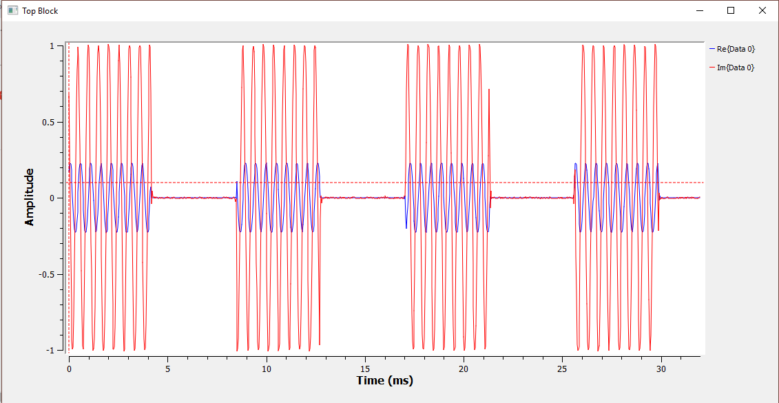

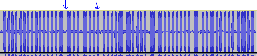

  • I will try this, but are there any ICs that are easier to use for 345 mHz ASK? It is for an old signal, so would manually decode signal.
  • No luck!.
    Starting with settings from studio for GFSK 345 mHz that worked, i changed the modulation to ASK. This only changed one register:
       0x36,  // MDMCFG2             Modem Configuration
    Then from the note made several changes for a 100 kHz filter bandwidth:
       0x04,  // AGCCTRL2            AGC Control
       0x00,  // AGCCTRL1            AGC Control
       0x92,  // AGCCTRL0            AGC Control
       0x56,  // FREND1              Front End RX Configuration
       0x81,  // TEST2               Various Test Settings
       0x35,  // TEST1               Various Test Settings
       0x47,  // FIFOTHR             RX FIFO and TX FIFO Thresholds
    I wasn't sure what bandwidth to use. Since both the transmitter and receiver are using the same setting, was sure if this mattered.
    The transmitter and receiver were about 20 feet apart. The range probably drops with the lower frequency, though GFSK 345 mHz worked. Moving them to about 4 feet did not help.
    It's a plain vanilla CC1101:
    It has to be the patable or register settings. Do you have any settings for 345 mHz ASK known to work?

  • The asynchronous receiver runs an infinite loop that logs GDO2 and the iteration. Here are three iterations running from 0 to 1:
    0,485794
    0,485795
    1,485796
    Here is the graph:
    The transmitted message contains 64 manchester encoded bits. The above does not look like manchester encoding.
    Here is a description of the signal from the FCC application:
    Recording and printing in a loop could have delays when buffered output is saved to a file.  There a number of ways it might be improved:
    Create a large memory buffer, and dump the buffer to a file at the end.
    Reduce the oversampling. It is probably 10x more than needed.
    Record the actual time rather than the iteration.
    It might well be a radio setting. Any thoughts on radio setting changes?
  • First of all, if the data you receive has something that is common for all packets that can be used as a sync word, you can use the device in “normal” mode.
    If you need to use serial mode, I would recommend using sync. Serial mode, and read the pin on the clock edges. An example is found here:
    www.ti.com/.../swrc021
    I do not think that reading a pin and then do printf’s to indicate if it is high or low, will be fast enough to represent what is going on on the pin.
    In async serial mode you will need to do oversampling and read the data much faster than the data rate on the RF.
    You should look at the data on the GDO using a logic analyzer and confirm that you are receiving what you are supposed to. When you have confirmed that, you know that your radio settings are OK, and you can then proceed with your software for reading/interpreting the data.
  • By normal mode, do you mean packet mode? It has a start bits. There are couple of extra long bits before the start bits. Is "normal" mode still possible?
  • By normal mode I mean packet mode. You cannot use this as it requires a minimum of a 2 bytes long sync word, and additional preamble.
  • Let's start over. Here is the signal captured at 345 mHz using RTL-SDR:
    As it is manchester encoded, the message consists of 8 bytes. The first arrow is after 2 bytes. The second arrow is 1 byte later.
    The signal contains:
    • 3 bytes start/preamble
    • 4 bytes payload
    • 1 byte crc
    The first 3 bytes don't change. What is the difference between start and preamble? What is the minimum length required for packet mode?
    As it is manchester encoded, how does it know if the first bit is zero or one?
    The crc is CRC-16/BUYPASS. Can the CC1101 compute this? At least initially, would it be simpler to consider the CRC as part of the payload?
    Can this be handled in packet mode?
  • I think the simples thing for you is to not to use Manchester mode on the CC1101.
    Just receive the data as if they were not Manchester encoded (128 bits in total)
    The data you have shown up until the 2nd arrow is:
    101010101010101010101010101011001101010011010101.......
    If these bits are common for all packets you can try to program the CC1101 to use a 16 bits sync word (bits in yellow): 0xCD4D
    The preceding 28 bits (in pink) will be the preamble
    You will then have 84 bits left to receive (10.5 bytes)
    You should then use fixed packet length mode and set the packet length to 11 bytes.
    You will then have the payload and CRC in the TX FIFO + + bits of noise.
    You can now interpret these bits the way you want in your application, meaning that since the data you received are Manchester encoded, you need to decode them manually. You also need to calculate and check the CRC manually.
    Siri

    I notice that you are using the SmartRF Studio settings for the data rate (1.2 kbps). Is this the data rate your transmitter is using?
    Siri
  • The default SmartRF Studio setting for data rate would be wrong. Based on the signal below, each bit is 4ms. The data rate would be 250 Hz.  I'll fix this first.
