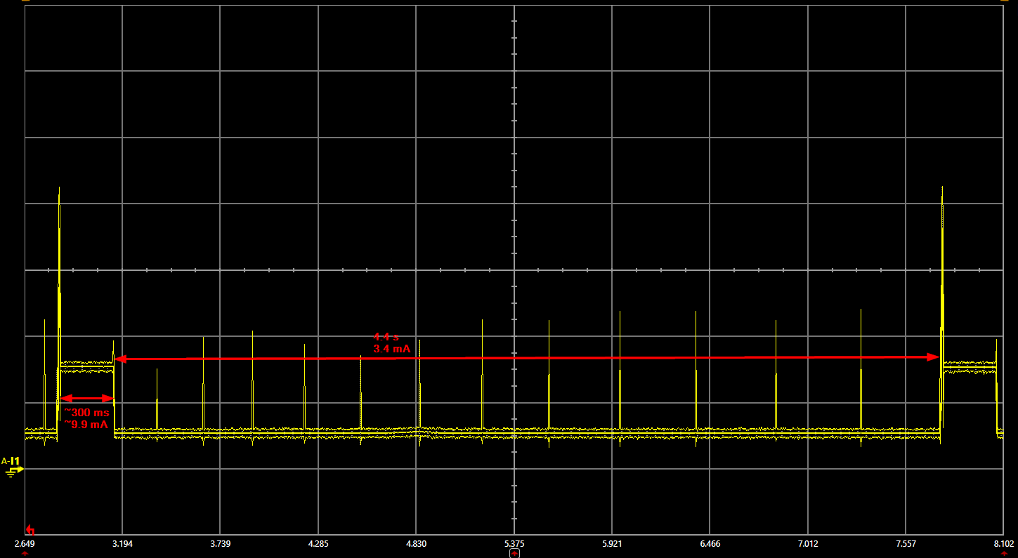

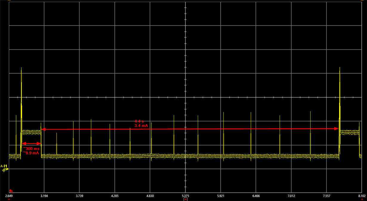

  • Hi everyone,
    I am including a capture of the actual pulses seen while the module is in the sleep
    cycle.  There are 12 of these pulses during the 1 minute sleep cycle.

  • Hi Simon,
    I used a HP 3478A multimeter and an oscilloscope to capture the pulses.
    "Also, when you say awake, is the RF core in TX or RX? Or are you only using the Cortex M3?"
    I am using what I described above the two EVM boards.
    "Note that CC1310, when in standby, the DCDC converter will go into recharge mode, meaning that you will see current spikes which will be hard to measure on a multimeter. "
    You can look at the oscilloscope wave form which I captured.
    Andres Blanco (LPRF Applications Engineer) from ti, said the following: These recharge pulses can go up to 6mA and only last ~50us.
    You can see what I captured above.
  • Hi Neil,
    It's not clear to me what you mean by awake. If the MCU is awake running at 48 MHz, 2.5 mA is expected, but you also have to add on the current consumption of the peripherals you are using. Without knowing that I can't say if the current consumption is as expected or not.
    The expected sleep current (or standby as we call it in the datasheet) is 0.7 uA with the RTC running + RAM and CPU retention. In this mode you should see the recharge pulses. Figure 45 in this application report shows how recharge pulses should look like: www.ti.com/.../swra478d.pdf
    -Simon

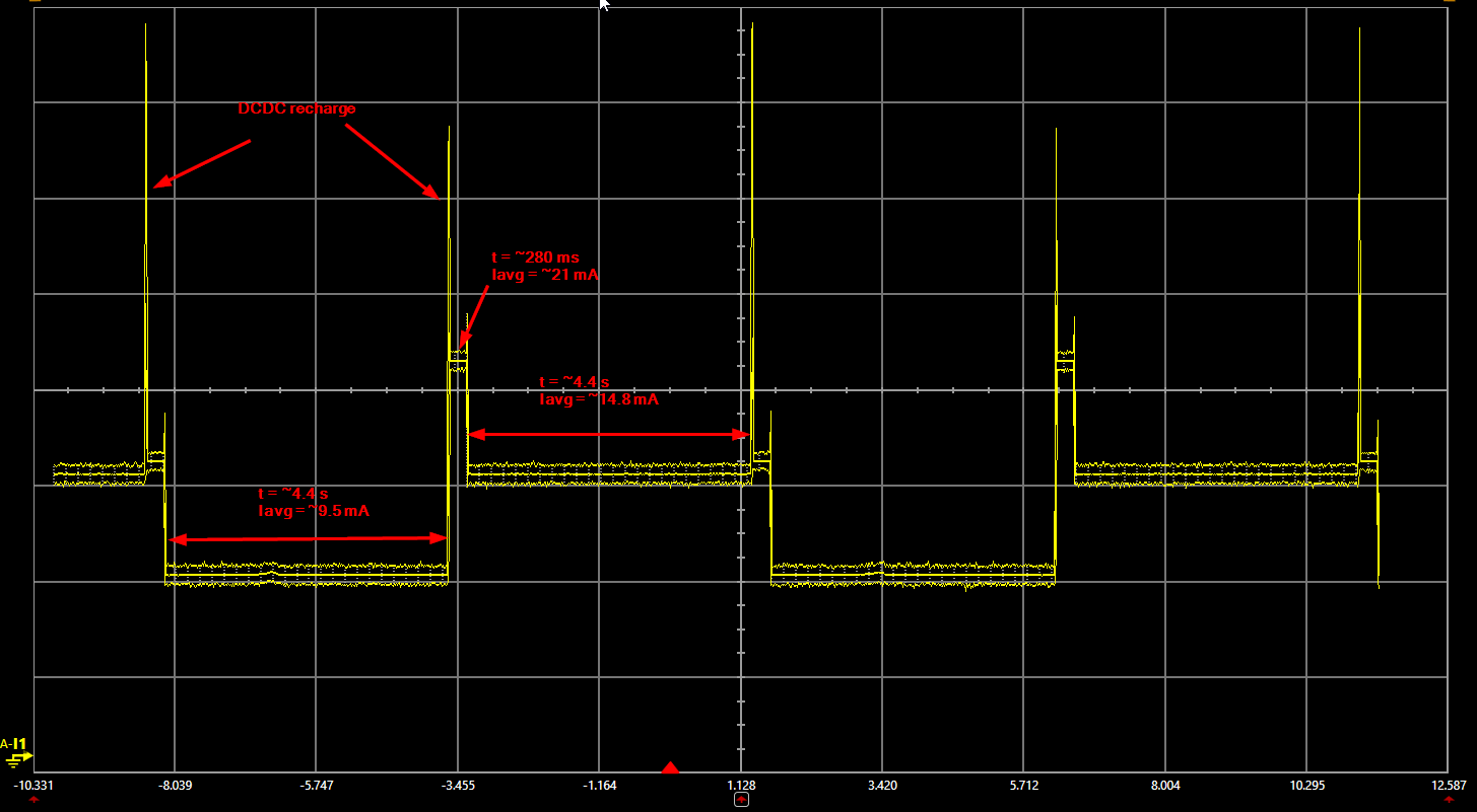

  • Hi Neil,
    This is the measurement results I got from you code. Since you haven't explained what your code is doing, I'm not able to help you any further.

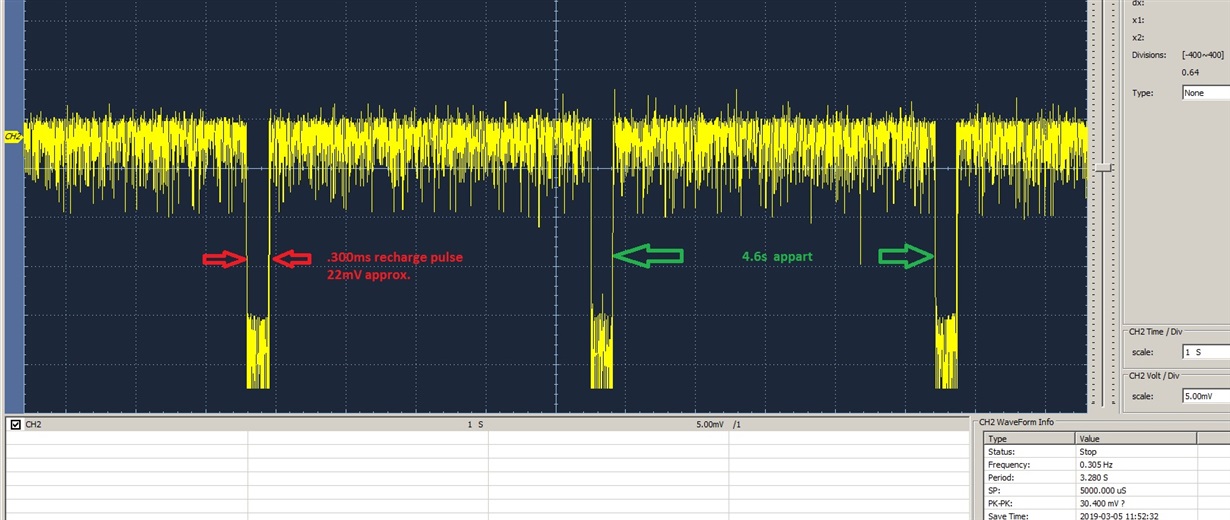

  • Hi Simon,
    The code that I sent you is not my code. This code was sent to me by Andres Blanco (LPRF Application Engineer) TI. I am simply evaluating at this point the current consumption of the device (CC13XXEM board). You can ask Andres Blanco exactly what this code is doing and help me understand as well with a reply in this forum ( please separate the explanation from the current measurement issue).
    After reviewing the pdf you linked, it appears that the pulses we are seen of 300ms are the TX pulses explained in that pdf. In that pdf, the TX pulses are approx. 100ms.
    Originally on the oscilloscope capture I posted, I called them the charge pulses, which I know now that was incorrect.
    As for your capture, I don't understand why the 4.4s sleep periods don't always end up at the same level?
    The Iavg of 21mA (280ms pulse) seems pretty high, we are getting 11.4mA?
    Your sleep current also seems pretty high, I don't understand why? According to Andres, this period should be around 70nA.
    Let me know what you think?
    Neil

  • Hi Neil,
    The screenshot I posted above is from the code you sent me. I have not posted any screenshots of the pinStandby example. However, I'll recommend to use the pinStandby example if you want to evaluate low power consumption.
    -Simon

  • Hi Neil,
    You SW is running the TI15.4 stack switching between collector and sensor. It switches every 60 seconds if it doesn't find a collector (in sensor mode) or sensors nearby (in collector mode).
    Form the measurements it looks like the device is in collector mode and not going to sleep; every 4.4s is a beacon being sent out and then staying in RX mode for 300 ms.
