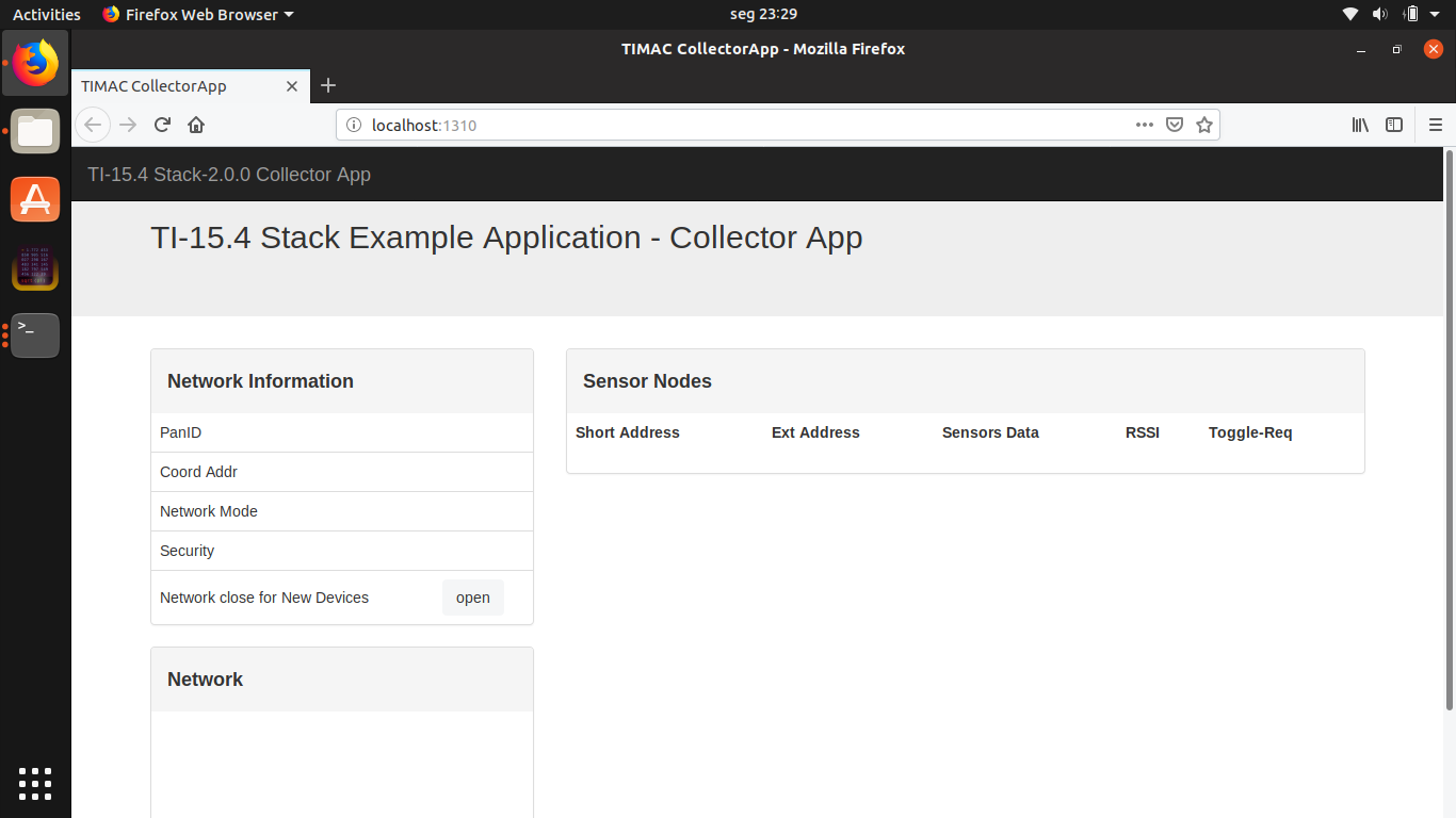

I tried to follow the wiki for adding a new sensor but the wiki is outdated (is for a different release).
  • I´m having problems in the file appsrv.c, The latest version of the stack is diferent.
  • Follow all the steps except when the files are different I can run successfull the script buil_all.sh. Then I ran the script run_collector.sh and run_gateway.sh and it opens the browser but I dont have any information from the collector.
Is there a new version of that wiki or was anyone able to add a new sensor to the last release of TI 15.4 stack?
Thank you,
Hélio Pereira

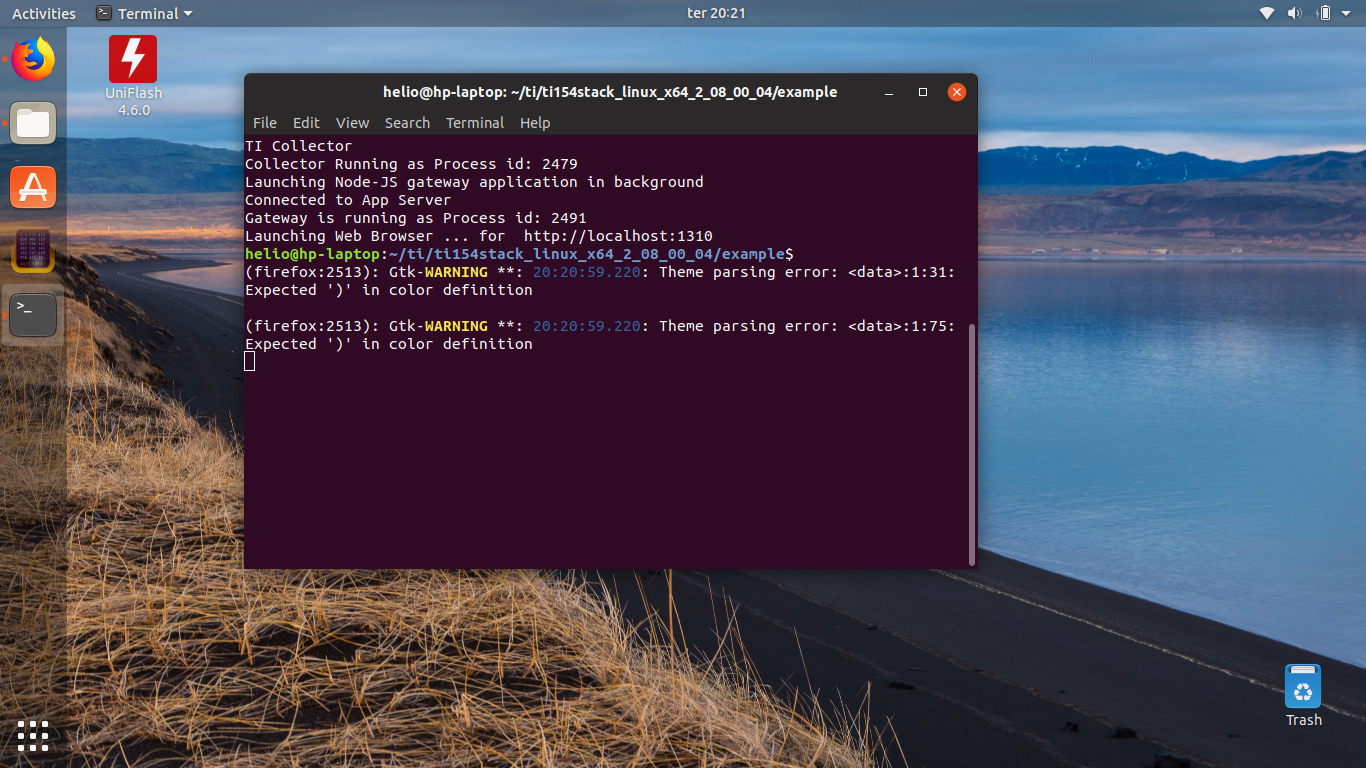

  • Hello microsistemas,
    Can you show me the gateway.sh output? Is the CoP responding?
    AB
    I attached a picture of the terminal when I start running the collector.sh and the gateway.sh. The CoP blinks the red LED twice when I start the collector.sh.

    Image from terminal

  • Try pressing the reset button on the CoP, if this doe snot work try using an earlier version of the CoP. maybe SDK v2.10
    I am setting up a similar environment as you to see if I can recreate.
    Thank you for your patience.
    AB
