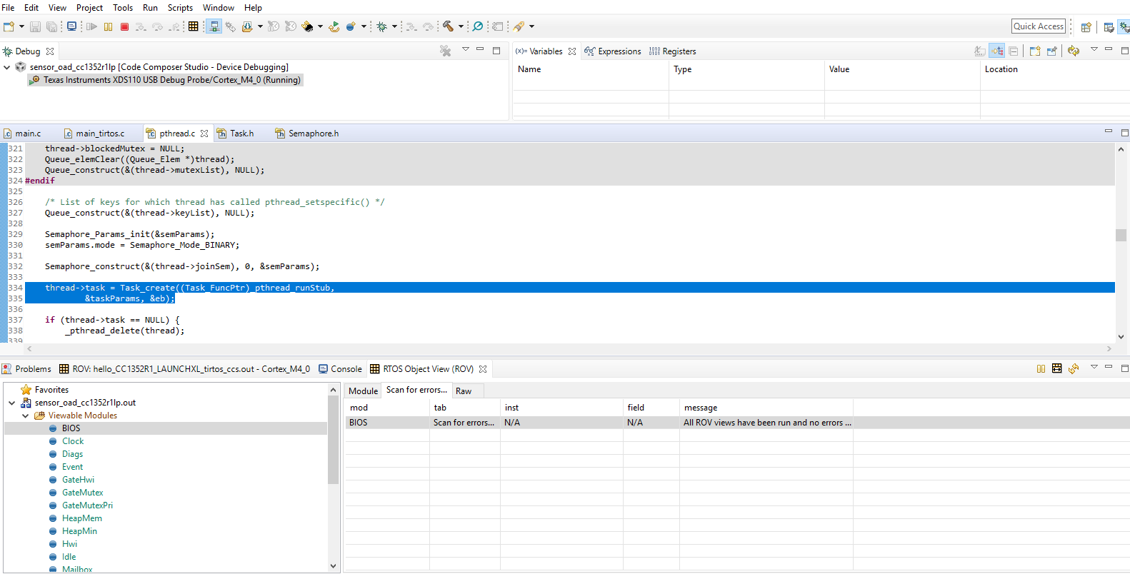

  • What happens when you debug the application? Do you enter the main() procedure of your OAD_Sensor application?
  • Yes, the flow goes into the main() procedure of the Sensor_OAD application.
    It steps into "main_app()" function, and it gets stuck in the following line:
    retc = pthread_create(&thread, &attrs, temperatureThread, NULL); // line number 103.
    Stepping into the function the flow is redirected to the pthread.c file.
    and the control is stuck more specifically in the
    thread->task = Task_create((Task_FuncPtr)_pthread_runStub,&taskParams, &eb); //line number 334
    in pthread.c file.

  • When debugging and the application hangs, could you open ROV and scan for BIOS errors?
    I opened ROV and scanned for BIOS error as you suggested. Please refer the following screenshots -
    While the code gets stuck on the selected line the ROV error message(also seen in the above screenshot) reads this -
    All ROV views have been run and no errors were encountered. In BIOS, this includes a check of the System stack usage and all Task stacks.
    But when I pause the debug and run it again it shows this -
    Quoting the complete error below -
    "Error:Problem fetching Task stack:JavaException: java.lang.Exception:Target memory read failed at address: 0x0, length:1024This read is at an INVALID address according to the application's section map.  The application is likely either uninitialized or corrupt."
    So is the error seen in the 2nd screenshot expected as i clicked on "Suspend" and then pressed the "Play" button again, or is this the error because of which the Sensor_oad application is getting stuck?
    And how to resolve this?

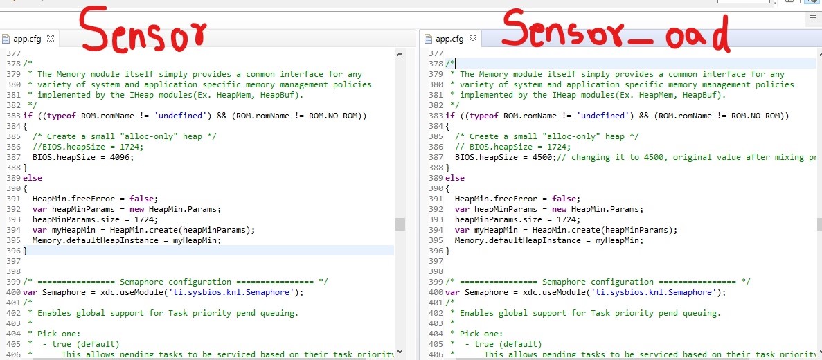

  • Ok, so I've taken a look. Without testing it myself, it looks like it could be out-of-heap error. The normal Sensor example configures the heap to be 4500 bytes, while the Sensor OAD example configures the heap to be 4096 bytes. The portable example allocates the pthread stack on the heap, and it could be coincidentally that 4500 was enough but 4096.

    Also as you said i increased the stack size in "Sensor_oad + portable" code. I changed it from 4096 bytes to 4500 bytes. And the terminal is still blank (flashed the BIM first and then the modified project). Can you suggest me what heapsize should i keep?
    Adding one more thing, as you said the normal Sensor example configures the heap to be 4500 bytes, I only found one instance wherein i can change the heap size and that is in app_cfg. The original Sensor code had BIOS.heapSize = 1724, i changed it to BIOS.heapSize = 4096.  And i changed the same variable for heapsize in sensor_oad+portable also (Attaching a screenshot for reference.), so my confusion is where is that 4500 heapsize you said  defined. Are there any more variables i need to modify to change the heap size?

  • Hello again,
    It worked now.
    After you suggested the heapsize, as i was going through the app.cfg file, I noticed that ROM.romName was commented out in Sensor_oad, whereas it was not commented out in simple sensor example.
    So i changed the heapsize in the "else condition" to 4096 and it worked.
    Thank you for your time and suggestion.
